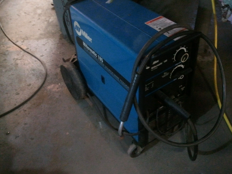

shield arc makes an important point.
Don't be afraid to adjust the wire speed while you weld. Or have someone else do it. You can tell a lot from the sound of the arc as the feed speed is changed. I think ChuckE2009 did a video not too long ago where he did that.
Also, remember that things change as you test piece heats up.
I do it all the time regardless if your not supposed too. I feel its the only way to get it spot on, dead nuts perfect and never hurt a machine yet. Made a few people cringe tho!
   / MIG vertical up trouble #32
wire speed is OK, but you shouldn't swich voltage on a tapped machine.
But if the voltage control is not in steps, then you can change it while welding.
   / MIG vertical up trouble #33
Why on earth do these manufactures even build a machine like that?!:thumbdown: Don't they understand that just ties the weldors hands?!!!:rolleyes:
   / MIG vertical up trouble #34
cheap and reliable. But it would drive me nuts to know one setting is too high and the next one is too low.
Bad enough on a MIG, I can't imagine using a stickwelder with tapped settings.
   / MIG vertical up trouble #35
Thats why i threw one lincoln mig in the scrap pile and is why my lincoln stick welder is fixin to find itself in there too. Among other reasons.
   / MIG vertical up trouble #36
if they still work, put them on e-bay or craigslist.
   / MIG vertical up trouble #37
Or send them my way. I'll gladly pay scrap price for a welder just cause someone don't like tapped machines
   / MIG vertical up trouble #38
I guess I'm a control freak! I don't like people telling me what to do, much less a welding machine! :D
   / MIG vertical up trouble #39
Lmao, in a weird way I guess im the same! I do have a tapped miller mig tho that is just awsome. Like it could read my mind almost!
   / MIG vertical up trouble #40
I guess I'm not a good enough welder, as I have never needed enough precision to want a setting "between" taps
