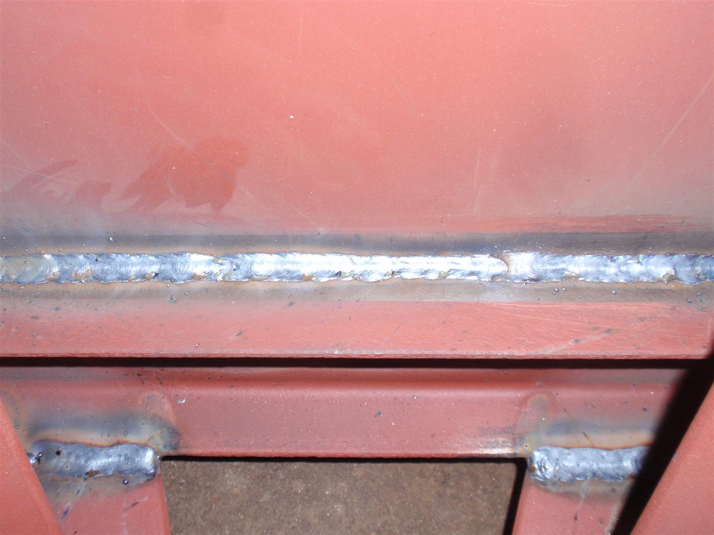

In my welding class we did a ton of out of position work, but it was all stick. I got to the point where I would call most of my vert up "acceptable" with stick. We did literally about 5 min of MIG in the last class, just for giggles. We didn't try anything out of position there as it seemed so easy. Flash forward to now. I have a really good welder - Miller XMT304 and 22A wire feeder. I can run flat position beads that look pretty decent overall. I can get good penetration and relatively smooth beads (depending on how steady I am...). I cannot, for the life of me make a vertical up bead work. Vertical down- no problem. But vert up has been a total mess. I get melted blobs that drip repeatedly every little bit as I go. See the mess? The one decent bead was vert down, just to see if I was crazy or not.
I tried everything from 18V/200 ipm to 24v/450ipm with 0.035 wire and C25 gas on 3/8" steel. I tried pushing uphill, dragging and everything in between. I used a straight-on torch angle and everything from a slight angle up to a severe angle up. I went fast, I went slow. I whipped, I zigged and even zagged. They ALL look the same. Drip drip drip
Here's a simple fillet weld done flat that was perfectly decent. All this was done tonight.
It's not the machine. Works perfect in position and vert down. It's not gas coverage - I'm running 15-20 cfh, and the garage is closed - no wind, no fan. It is clearly me, but I have tried everything I know with my limited experience and can't do a thing with it. It must be me, but I can't figure it out to save my life.
Any hints here?

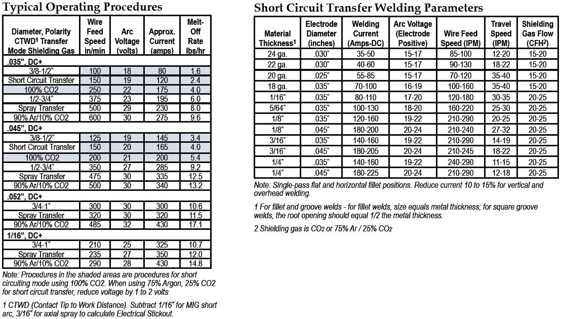

Here is a good chart I found online. For vertical up try the lower settings for metal thickness and size of wire.

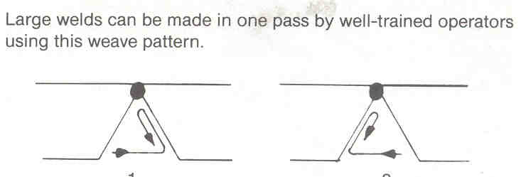

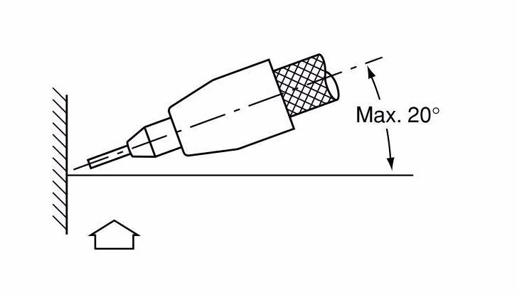

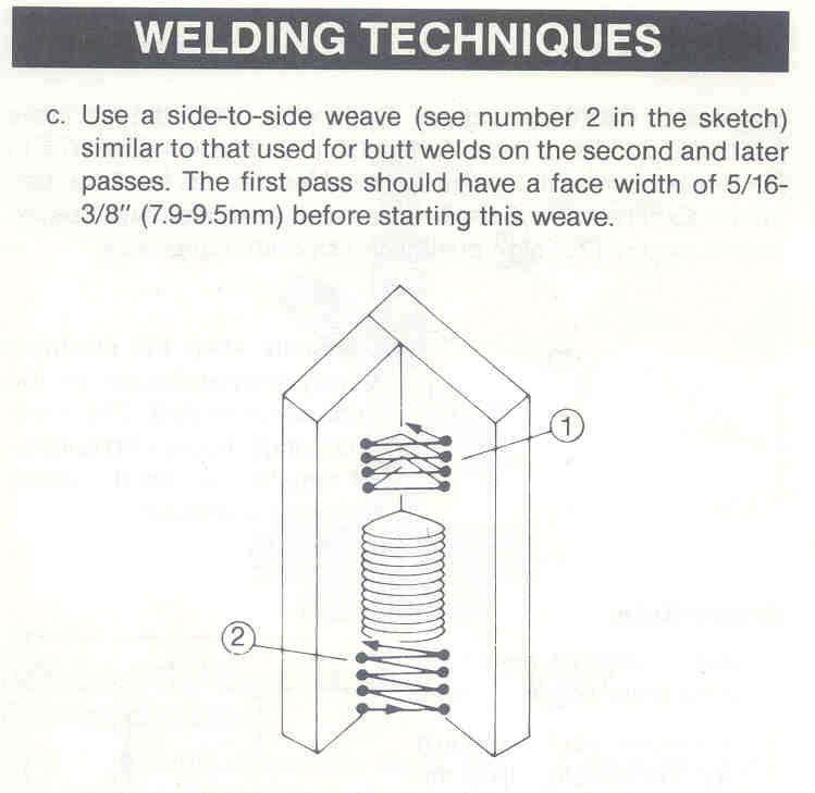

Here are some diagrams I scanned from a Lincoln book, maybe they will help. ;)
/ MIG vertical up trouble #6
Very good, if your REALLY doing heavy structural stuff you should be using some dual shield flux cored wire. IE: stick on a spool! Hard wire vertical down I say, (1/4") plate. Most of all with any of welding, practice and be comfortable/steady, lean an elbow on something, sit if possible.

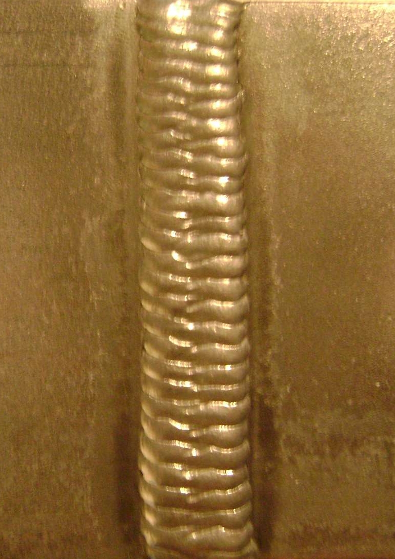

This was only a quick run that I made while trying out a new machine, but my pattern was gun slight angle up, and quick tight ovals. Give it a try, it may work good for you. Hope it helps you bud!

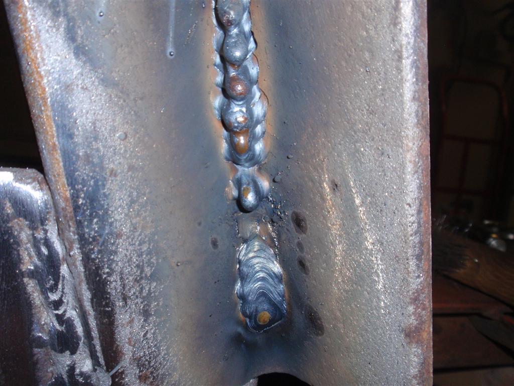

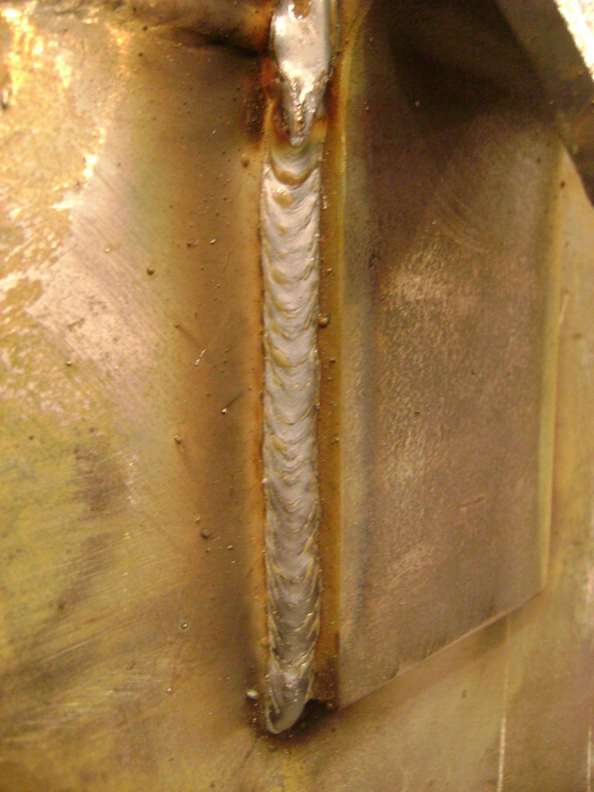

In all the years I've been welding, I have never been satisfied with my vertical up welding!:eek:

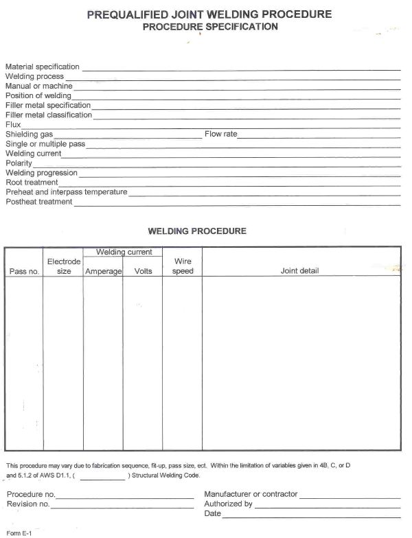

The main reason is penetration. I'd say 90 to 95% of the things I've welded I had to follow a WPS, (Weld Procedure Specification) or a Prequalified Welding Procedure. The majority of them were AWS D1.1 code. When I worked in a tank shop everything was ASME boiler and pressure vessel code. I have yet to see one that doesn't have a line item of: "Welding Progression". I have yet to see one that would allow you to weld down hill on anything thicker than 10-GA. But this is my limited experience;).
One time in the early 1980s I was in a welding crew that we sheeted a 80' x 80' building 70' tall out of 4' x 8' x 10-GA sheets. All welding was done with Mig .030 wire. All joints were gapped 1/16", all vertical welds were made up hill.
/ MIG vertical up trouble #18
SA, I'm not doubting you, but everything I've heard elsewhere says otherwise. Matter of fact, I'm in a class right now, and we discussed this (including a video) just yesterday, and everything was vertical down. You clearly have experience I'll never even dream of, so I have to ask: why the difference? What am I missing here?
If they are teaching you to do vertical down, they are prepping you to go weld and zip together a bunch of cheap built tag-a-long trailers somewhere. Otherwise it is vert up for anything over 1/8"-3/16"...and at that full penetration is doubtful on 3/16".

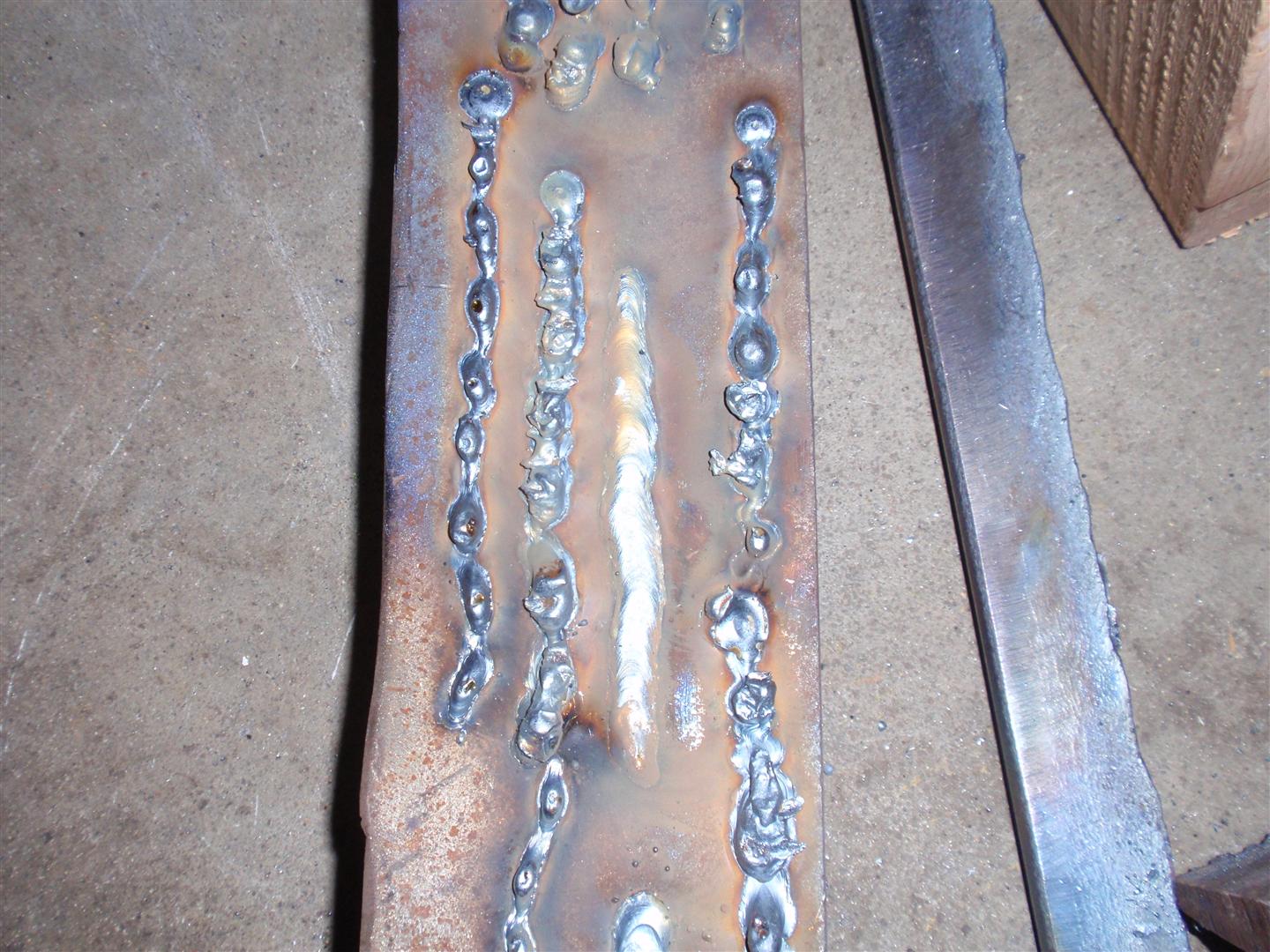

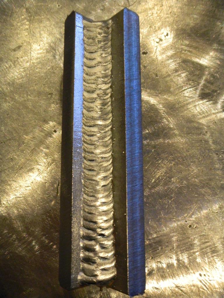

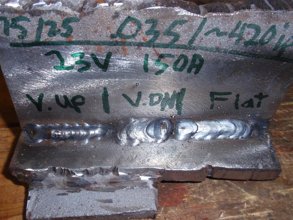

OK, Time to revive this. I haven't had a lot of time to practice welding the past couple months, but today I had a free day and nothing to do, and it occurred to me I needed to get back to this. So I looked over this thread and tried a few things. Executive summary: There must be some catch to this that I am not getting.
I grabbed a couple scrap cutoffs of 3/8" angle to use as practice. I figured I would weld in the corner like a fillet. I tried all manner of the suggestions on this thread. There was only one time I said to myself that it didn't look like total ****. The root problem is the same as earlier - the weld pool metal drips. Here is a small 3/8" fillet coupon I did for some comparison after some other practice. I did 3 different welds on this to compare - flat position, Vertical down, and vertical up. Pictures don't seem to be as good as looking at it live, but the flat and V Down looked pretty similar. The V up was one of the best ones I did, and I would still say it looks like crap.
You can see the conditions on the coupon - about 420 ipm, 150A or so (I don't think to look at the display much), and 23v with 035 wire. These figures are right off the Miller "calculator" I have.
Here is a better example of the crap I was still getting:
Note the section of Vert up at the top (drip, drip, drip) and the Vert down at the bottom (smooth but not well tied-in, in this case, especially on the left)
I tried a few things here in Vert up. Gun angle - I kept it perpendicular (0 deg) and about 15-20 pointed up. I had slightly better success with 0, but not much. I did some major work on wire feed at the same voltage. The charts recommend 23-24v, 420-520 ipm for 035 wire on 75/25 gas. I tried that, and then dialed the wire down to 250-300 ipm also. I got better looking welds at the low speeds, but it did not sound like normal MIG welding. I'd be concerned it was cold, but I can't be sure.
I'm sure my technique is the fault, but I have no idea what to change after all this. I have tried everything that has been suggested and everything I can think of from what I know. Nothing looks good enough to pass in my vertical ups at this point. Open for suggestions, but not sure how much help I can get without it being in-person at this stage...
