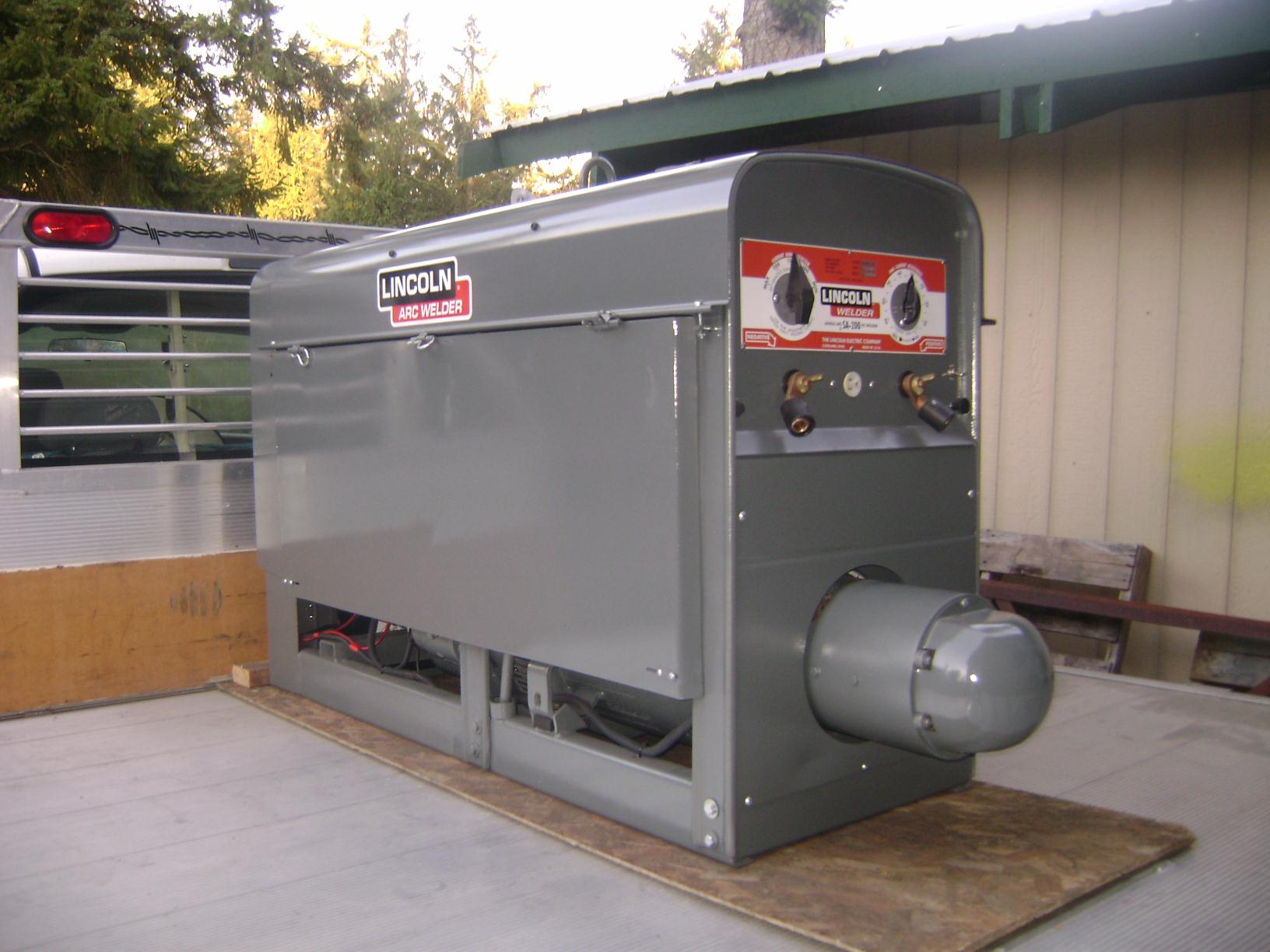

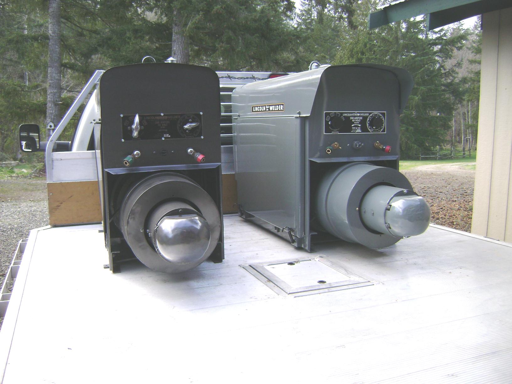

I have a 220 lincoln tombstone ac/dc get some 6011 1/8 rod some 7018 3/16 and you'll be all set. I have a 180 amp mig also and there is no comparison between the two.It's like "a 2 ton bottle jack will lift your car and a 966 cat will lift your house".Each unit has its place i guess. remember opinions are like arm pit's everyone has one and not all are good.
   / MiG welder: how thick can it weld? #47
Shield arc,
Thats a nice Lincoln in your pic.
