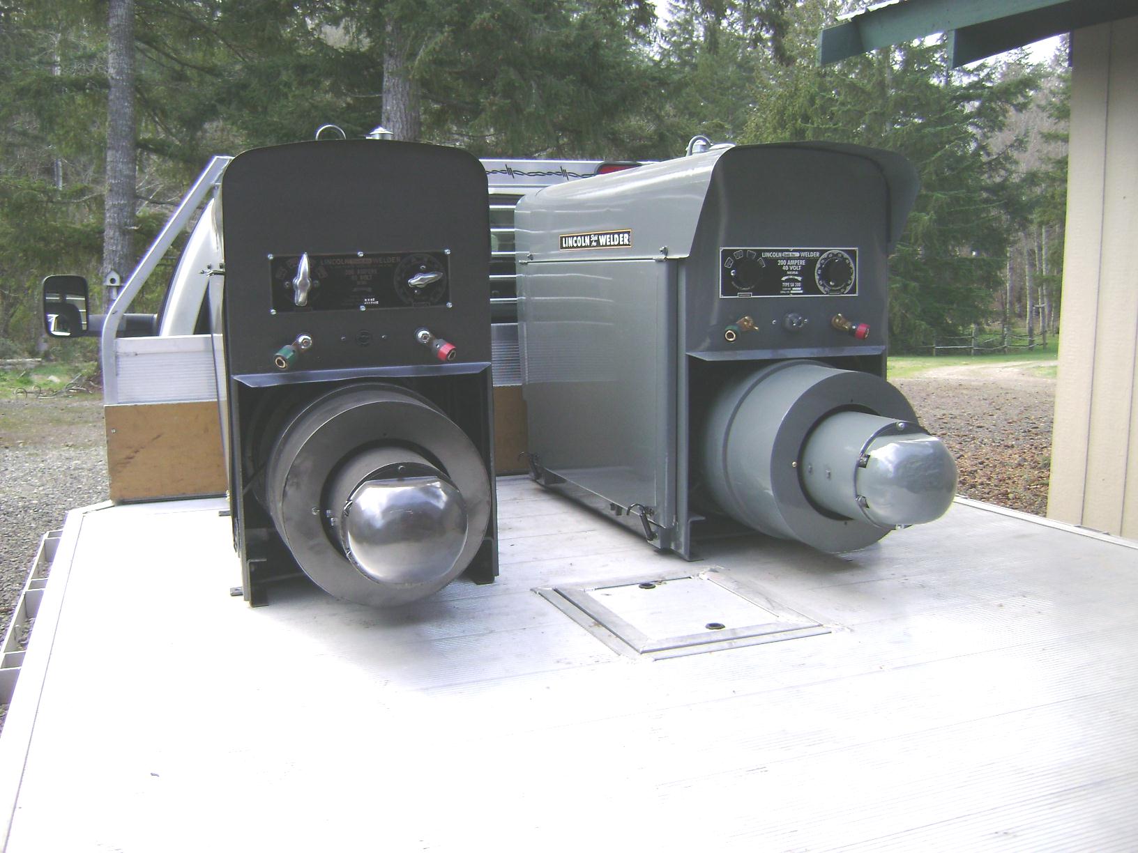

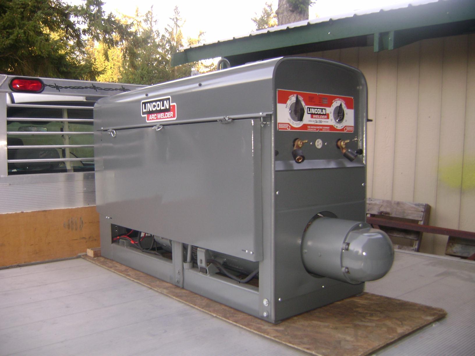

By the way, a MiG is a Russian fighter which probably doesn't make good welds. :D:D:D
Says who?
Pics of my Russian MiG: :D
