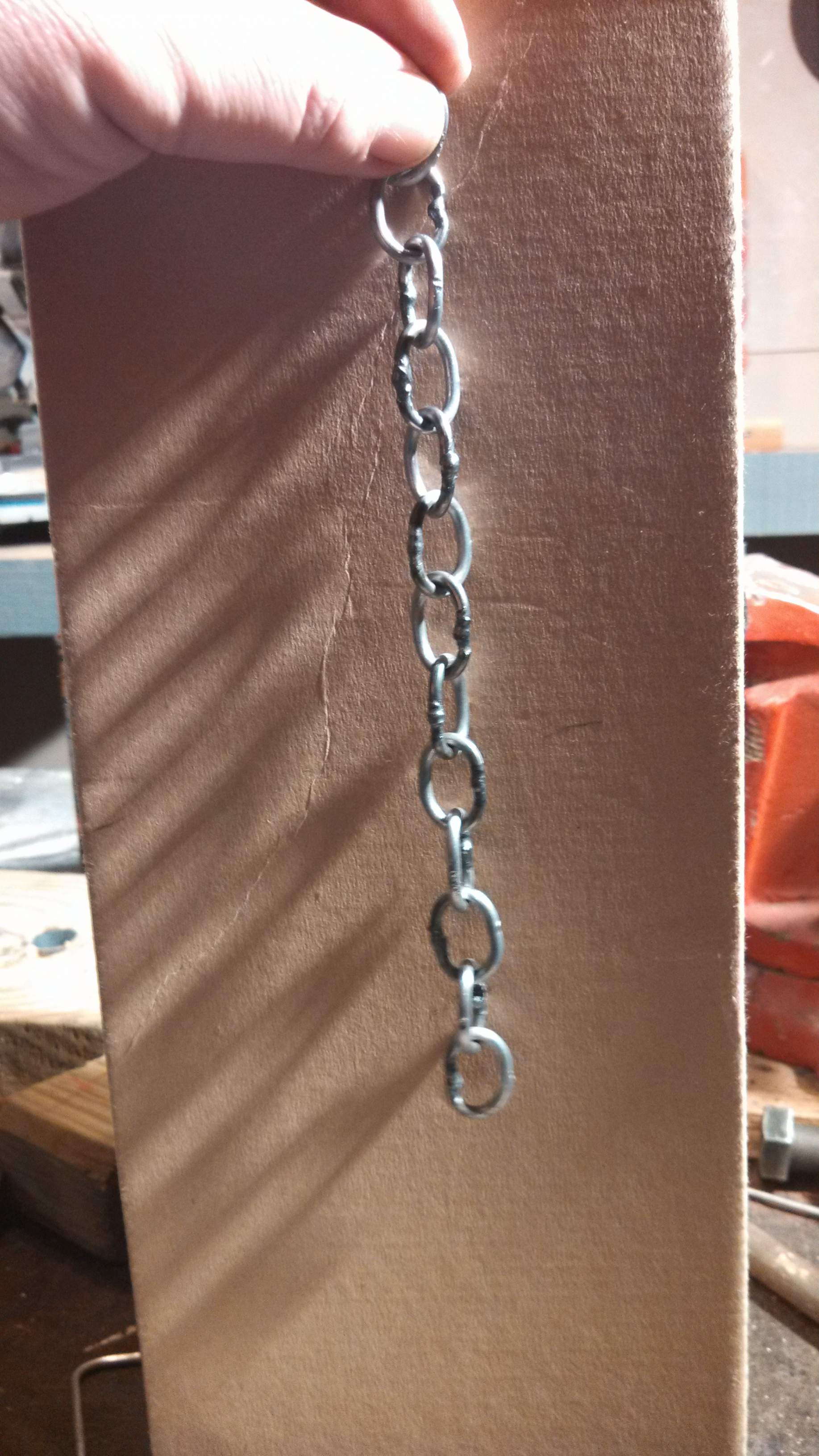

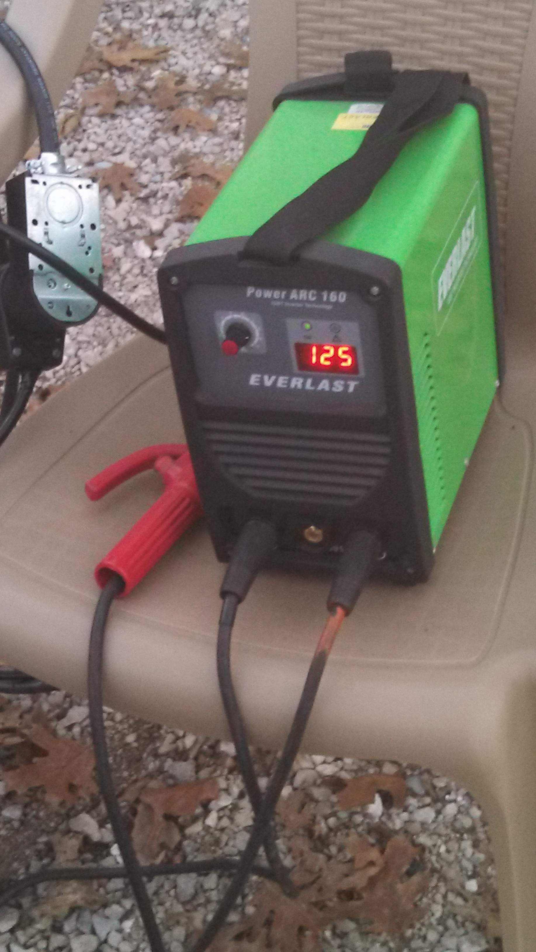

I can tell you what works for me. I have a 160 amp DC only Inverter welder (Everlast PA160). I can weld anything I need to weld on DC stick, and 7018 is my favorite rod. Now when I need to weld something very small or very thin, I put on my TIG torch on this welder and TIG it. 17V type TIG torches are down to around $60 now and regulator/flow meters are less than $30. So for $100, and either a argon bottle purchase or rental you are set up for 5 amp on up scratch start TIG welding. People have been scratch start TIGing for decades. Sure it is not as nice as HF start and pedal control but it will work and gives you access to work that a lot of people would break out a MIG welder for and will do some delicate jobs that even a MIG won't do, as an example copper and brass.
Now, stick takes more skill than MIG, but it is very cheap and simple to use and a change in rods to weld Stainless for instance or rusty metal takes a couple of seconds. TIG takes a lot more skill than MIG, and is a heck of a lot slower than MIG, but it is very precise and very versatile.
So in summation from 5 to 50 amps or so I often use TIG if the material is thin or small. for larger thicker items I just stick it.:)

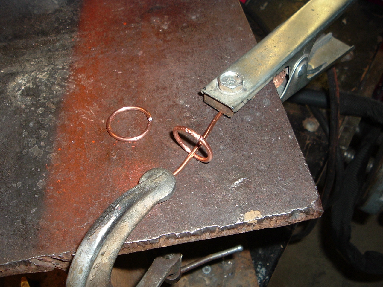

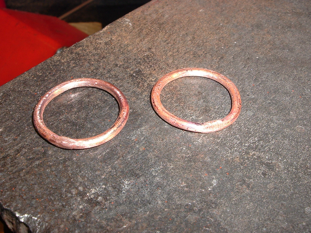

Here is some copper crush washers I made with TIG

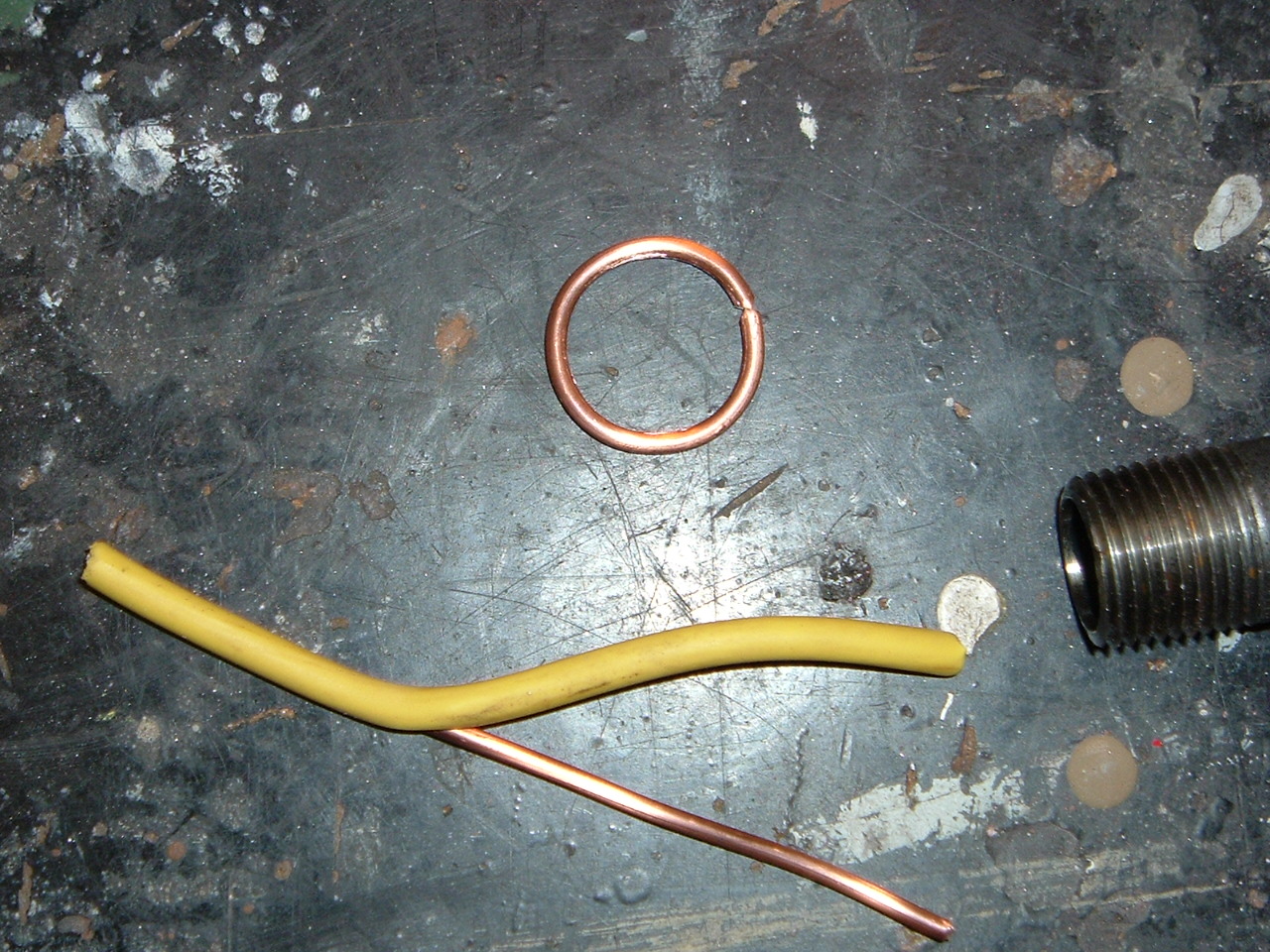

Here is some very small chain I made with TIG

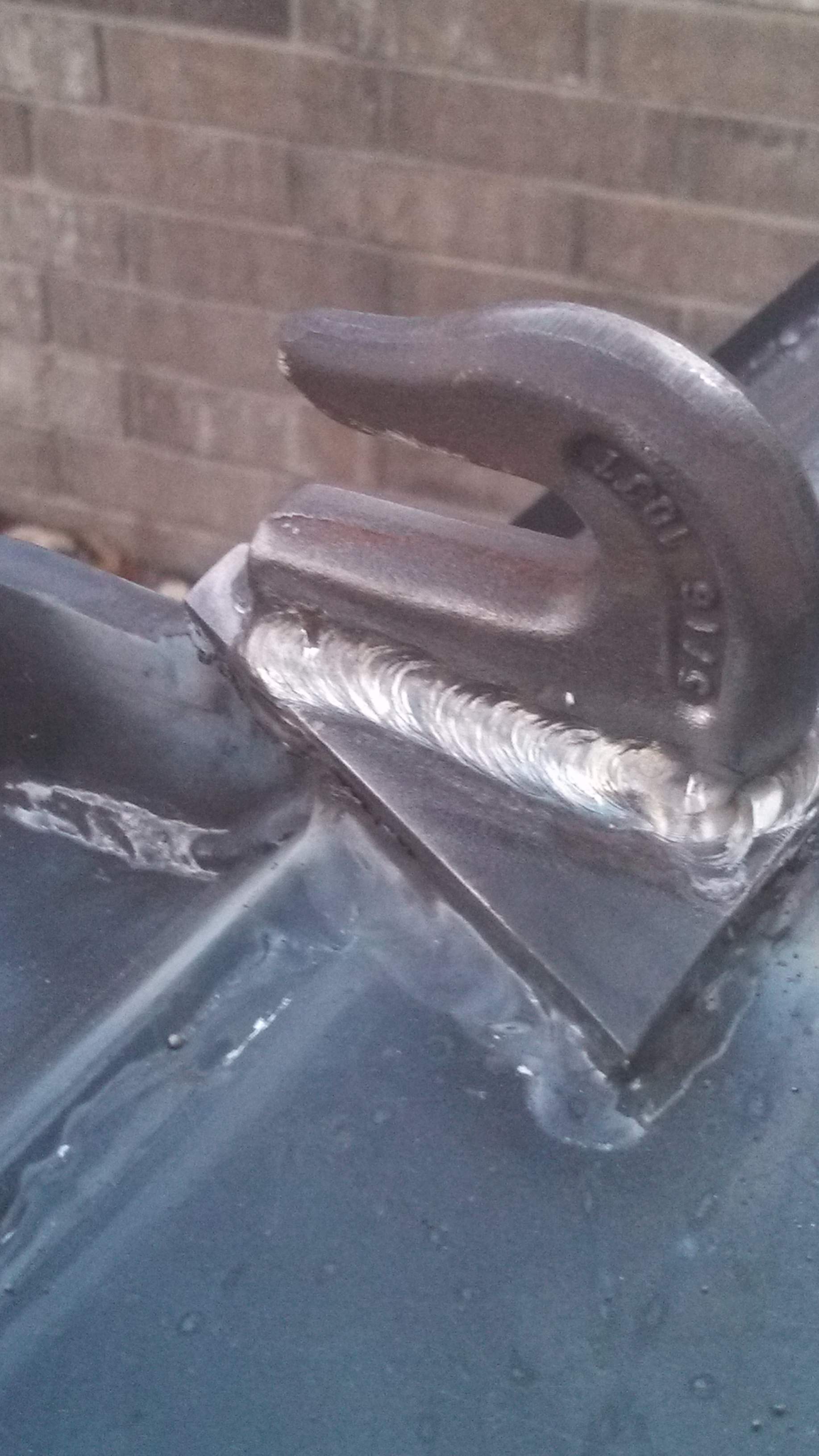

All of this from a Welder I bought new about 3 years ago for $269. Now don't get me wrong, I have nothing against MIG welders, and If I was doing a lot of building and need to weld up a lot of things rapidly, (as if I was in a welding business) I sure would have one or two.:) But I just don't need one as all my bases are covered so far.
View attachment 388622View attachment 388623View attachment 388624
View attachment 388625View attachment 388626View attachment 388627View attachment 388628View attachment 388629
Here is a bucket hook I welded with 7018 stick View attachment 388630
Seen a guy doing Chain-mail (spelling:?) and making shark bite suits for divers now that was using a slightly different process but took a LONG time (Mike Rowe) worked with him if I remember right once too... ;)
Takes patience that is for sure, I like TIG myself but used mostly big machines have watched some vids of these small inverter style welders running & appear nice, it is good to see/hear from someone using one. I have a 120V Mig with gas, 240 AC/DC Miller thunderbolt and access to TIGs (big ones) from old work shop. Used to love welding SS w tig almost calming if you can set still long enough...
HF is FUN when it is HOT and you are all sweaty trying to work & NOT get re-charged... Had a big Aluminum job one Aug took about 3 days worth of TIG welding with a lot of filler rod (almost 2 tubes full worth used.) THAT JOB got me hating it gloves and everything I was sweaty wet and shocked every time I started or stopped the arc... more than once sticking the tungsten into rod & getting lit up at 90~150 amp pulse width modulation and HF starts...

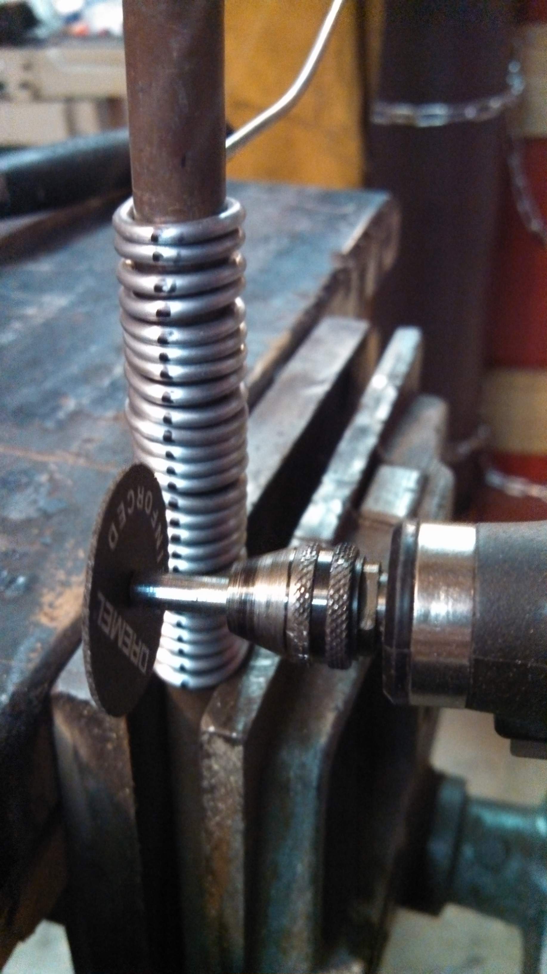

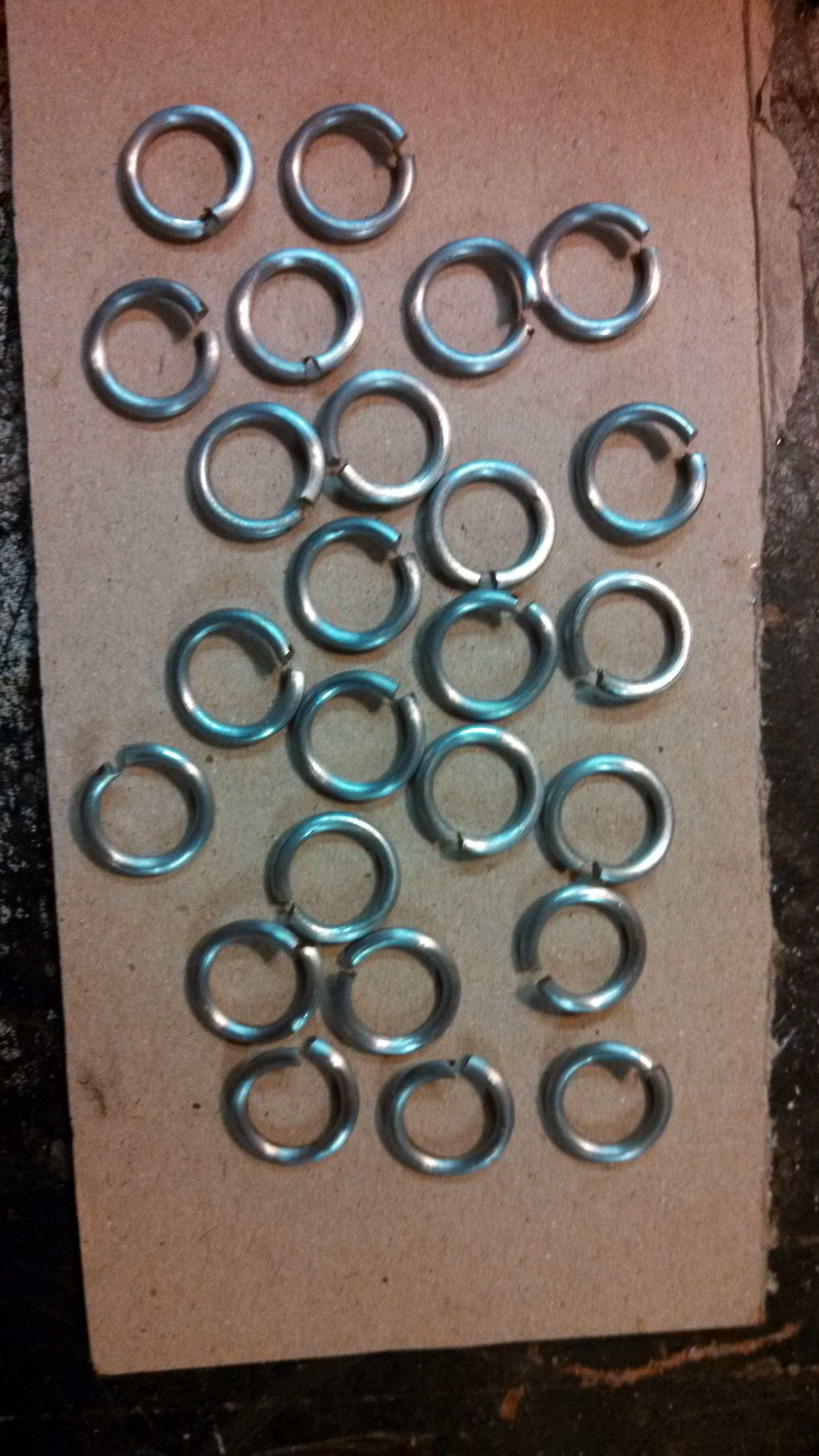

I though about the chain mail thing, but it is awful tedious. I read about it, and that is where I learned how to make steel rings really quick. But the welding of them takes some time. I have never used HF start, I don't have it (wish I did, and a pedal too), so just the scratch start TIG is all I have, Cheap, dirty, but it works. Can you imagine the "old timers" back in the middle ages making the rings and forge welding them together? No wonder chain mail cost so much back then and took forever to make.

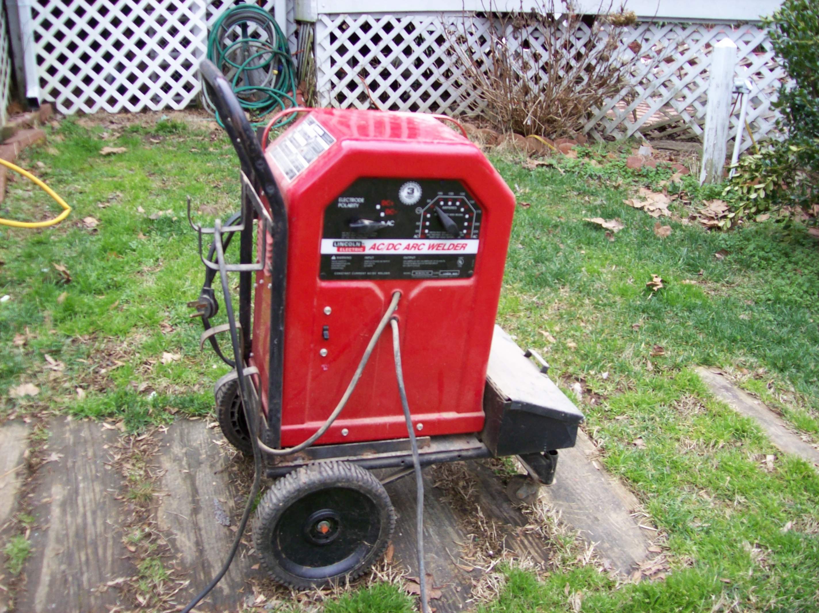

I use an AC/DC Lincoln stick welder & oxy/acetylene torch here at home that does 90% of what I need. Where I’ve worked, I’ve used stick, MIG, TIG, carbon gouged, gas torch & plasma cutter, but I like a simple stick for cost & versatility here at home. For welding nasty rusty steel, dragging the lead around the yard to get around big projects and just general fab work I like my stick. I’ve never tried a flux core wire welder; just never saw an advantage to it if I still got to chip flux off and brush. I love a gas wire welder though, but good ones are pricy and the short lead on most limit maneuverability. Be nice to have one, but wouldn’t give up my stick.
Same here, I've got the Miller Thunderbolt AC/DC, never used the AC yet,
oxy/accet tanks and a good supply of 7018, I like your cart, gotta get to it and make one for mine.
Thanks, but the cart ain't nothing but a cheap yardsale folding handtruck that I've adapted that is on it's second or third set of used plastic lawnmower wheels. Inventive - not so much, but cheap - for sure, that me all-over.
