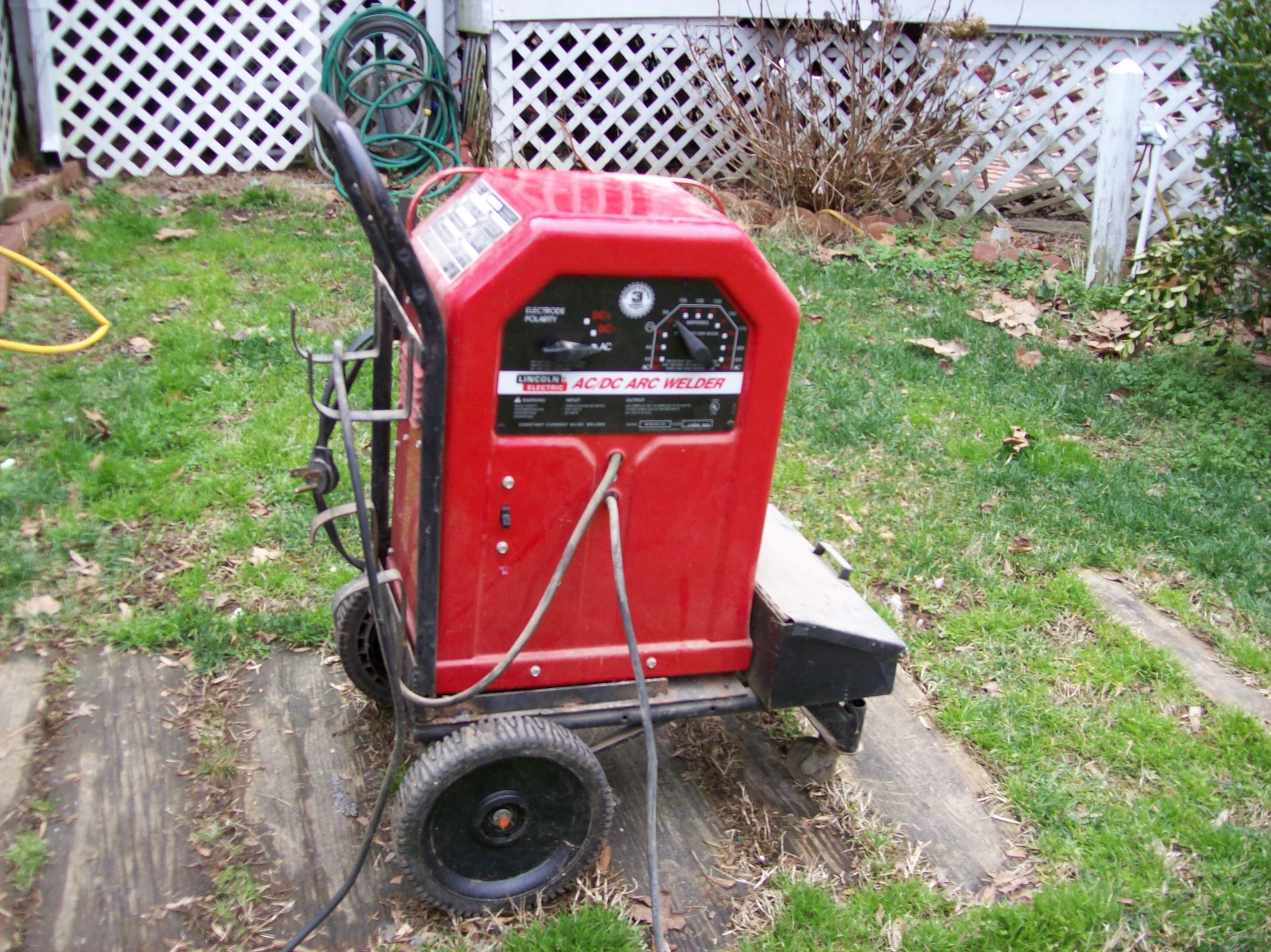

Thank you for all your help. But now I need to decide whether it is worth it to get an AC/DC stick welder or just an AC. Any thoughts?
   / Mig welder versus stick welder #23
DC is often the better tool for the job, so if you can find a good deal on the AC/DC that would be perfect.
Else, if you can pick up a good old AC dirt cheap you can't go wrong. Just be sure to sock away the savings for you're next toy [pronounced: tool], be that an AC/DC, a small mig to complement the stick, or a big mig as your "primary" machine, then I think you'll be happy with your choice. /forums/images/graemlins/cool.gif
   / Mig welder versus stick welder #24
AC/DC. I bought a Hobart Stickmate LX 225 and am very pleased with it.
   / Mig welder versus stick welder #25
I own the AC 225 buzz box. AC welding is great for flat work but the puddle runs too much for off angle stuff. Maybe it is operator error, but I have a hard time making a pretty weld with good penetration unless it is flat or cloase to flat.
Also power requirements. I can throw 225 amps at thick tractor stuff in the field with my buzzbox powered by a costco 5500 watt continuous rated generator. That's right, max output with a cheap Coleman contractor's generator. DC takes more input power for the same output amperage.
I would much rather have the versatility of an ac/dc welder. MIG is great for in the shop, makes pretty welds and is as easy as a hot glue gun.
