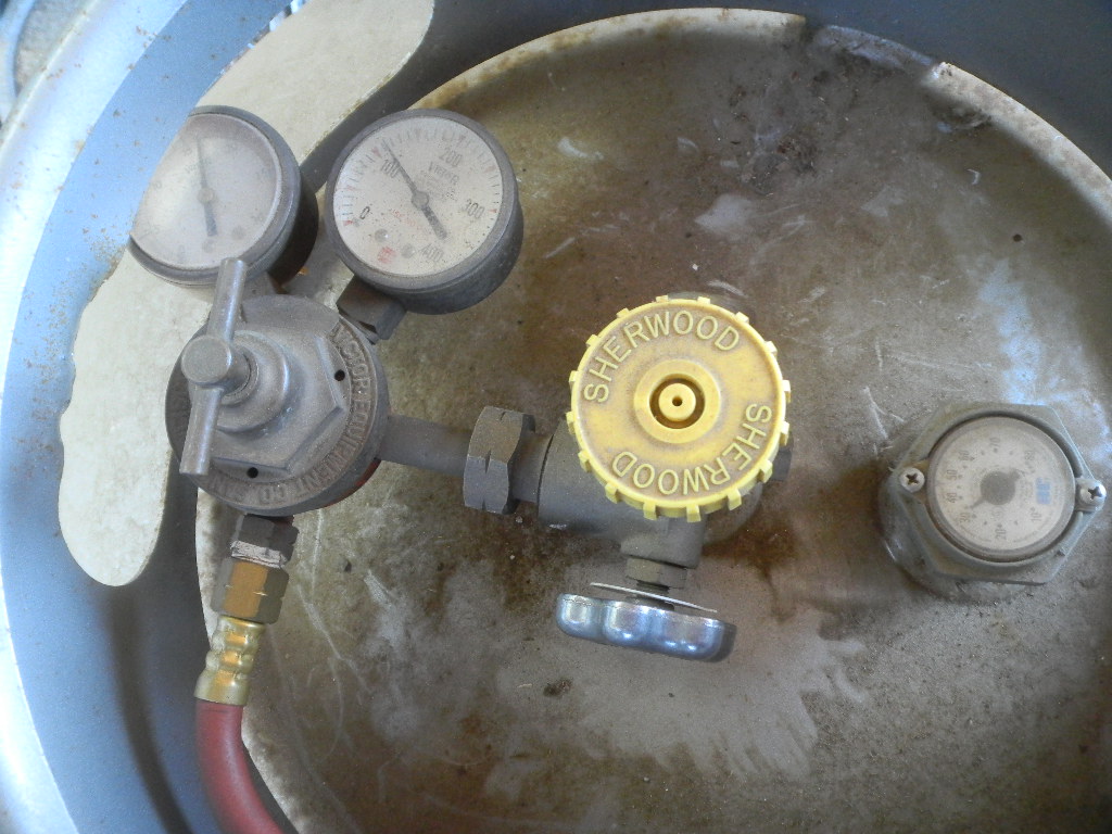

Everything stays the same. The present regulator just screws into the propane bottle. The only thing you need to change is the cutting tip. A local welding supply store or where you buy your oxygen should be able to supply you with a tip. Just take the old one along to make sure you get one that fits.
The puddle welding tips don't put out as much heat as they used to but I get along just using my largest tip for brazing. The other thing to remember is that acetylene rises in air so you light above the tip. Propane sinks in air so you light below the tip.

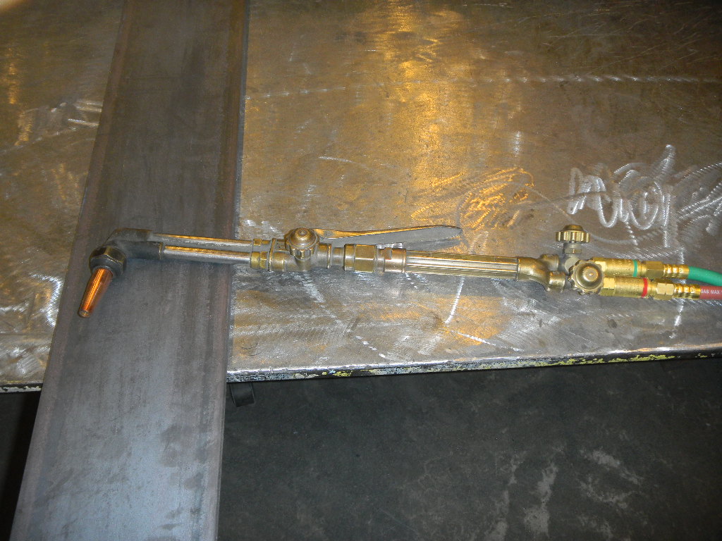

So just switch to propane? Anything gotta be changed.. Regulator? torch?

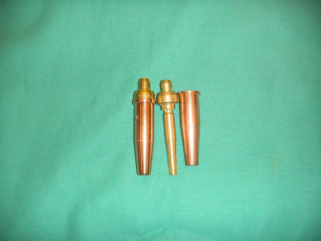

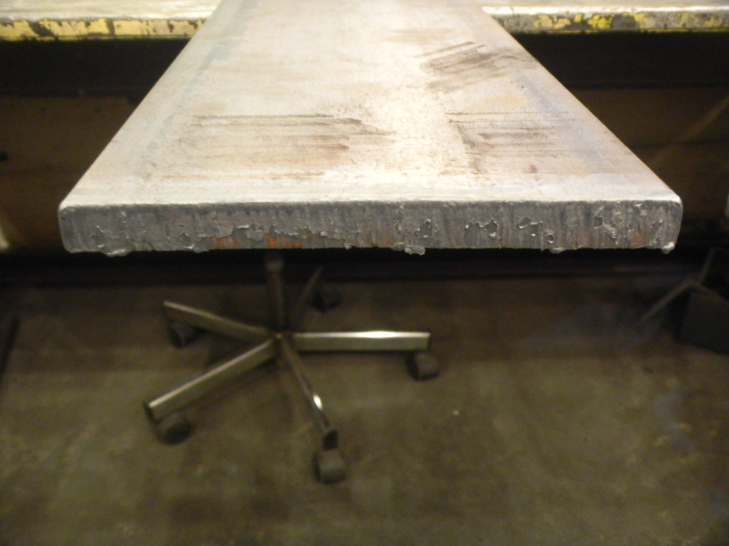

Here is a good video on getting set up with propane. It make a real nice cut, takes a little longer to preheat tho. I can't stand to use propane to heat shrink anything, just takes way to long.:thumbdown:
https://www.youtube.com/watch?v=f2amO0T3vkQ

Take it back and exchange it for a propane tip.
   / Mig Welders #79
I just finished using it to cut a circle in some 1/4" plate. Besides I only paid $7 for it. PA had a sale on.
I sure wish my cut looked like the ones Shield Arc posted. I spent way more time grinding than cutting. I think I need a LOT more practice.

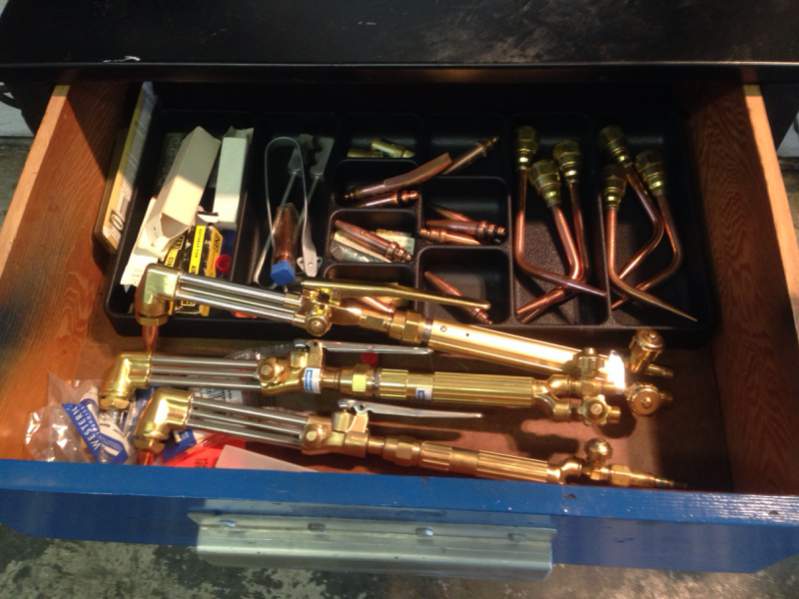

Terry, that is a lot of tips and torches. I only have one torch, one welding tip, one rosebud and now 2 cutting tips. I don't get a lot of use from it but it sure is nice to have it when needed.
