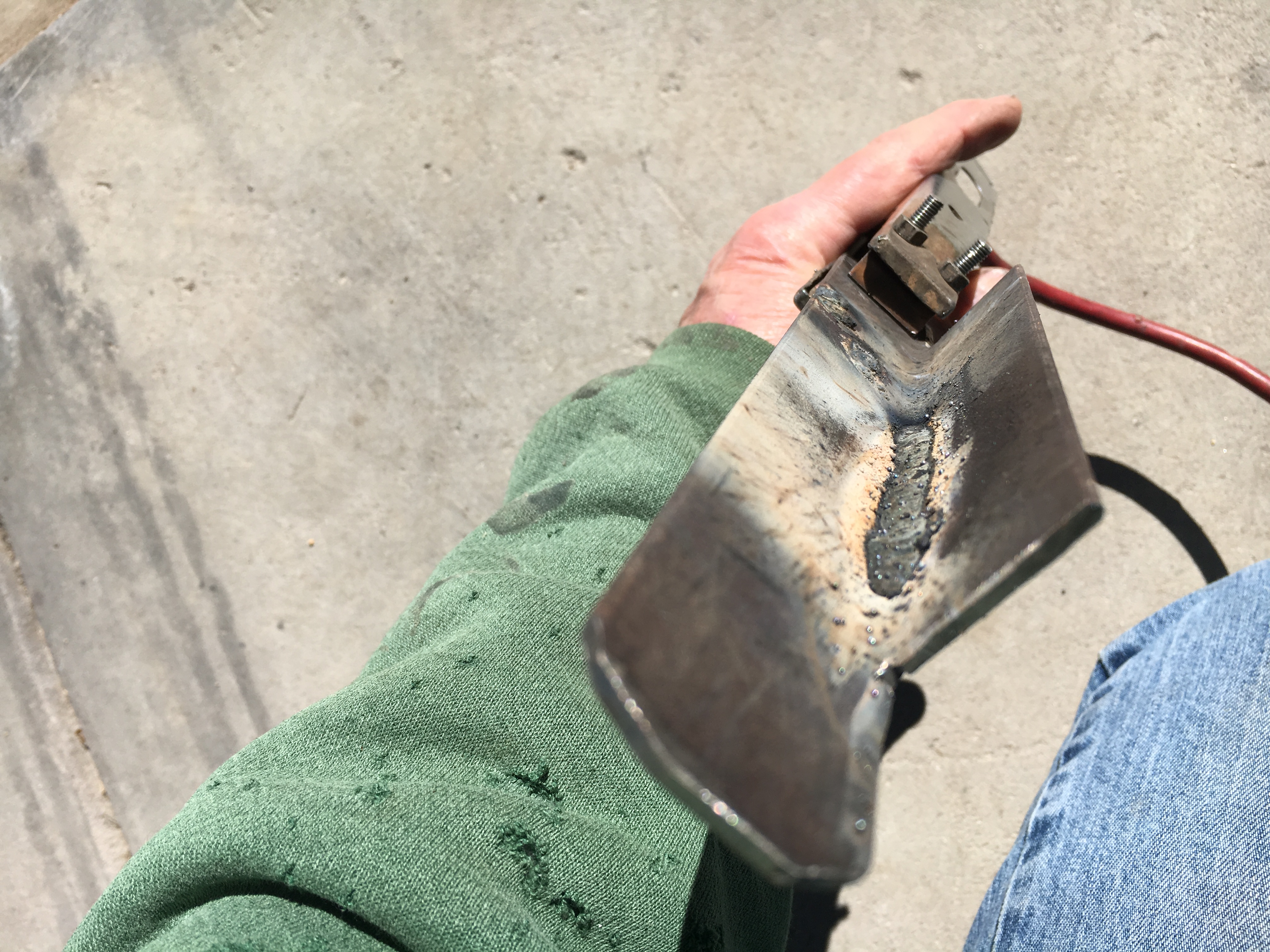

Going back and re-reading your opening post you say that the arc stops intermittently but the wire keeps feeding. When the wire keeps feeding in between arcs is it cold wire or is it red hot?
/ Mig welding question #22
I would think that the 20 years you have gotten from that machine equals money well spent and the machine is starting to lose its power. Transformers do go bad and that is what powers your arc.
That being said, take it apart and blow it out. While you are in there look for any signs of arcing, loose or frayed wire. Inspect the coil for any burned spots. Any odors produced when welding?
Does it have a burnt odor when off?
As I said 20 years is a long time for a relatively inexpensive welder to last. Especially a machine who's sole function is to get shorted out repeatedly.
#23

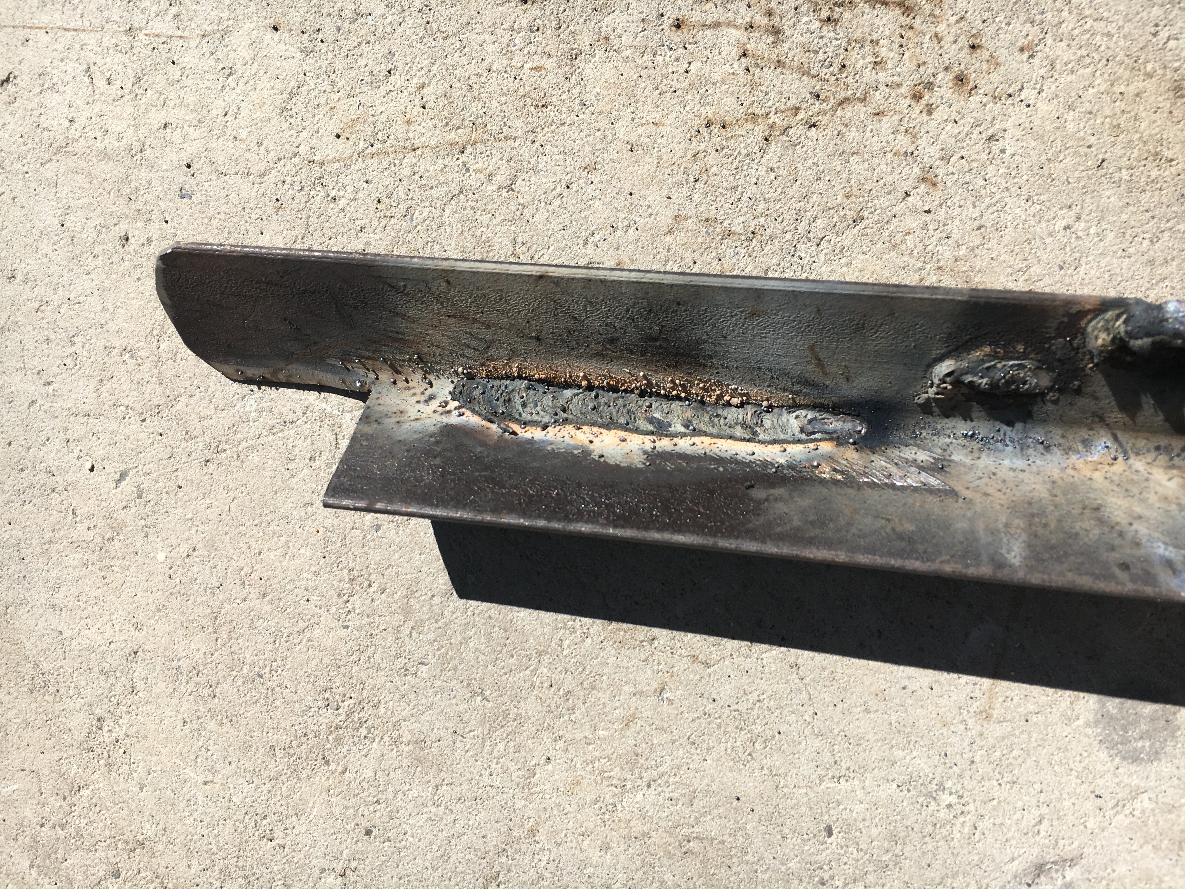

I think the tip MIGHT have been the issue. It was pretty cruddy, actually. Swapped with a new one and this is what it looks like. I was in the middle of another project so no long time welding, but am hopeful.
Thanks for the assistance.
Never noticed, but if this tip is not the issue I will take notice. Hopefully that was it, but if not you guys have given me lots more to watch for.

Thanks. Its an old sweat jacket I work in around the house. My gloves come almost to my elbows, and just bought a leather welding apron that goes from neck to almost my knees. I'm not real tall LOL.
I took the gloves off for the pic. I was actually involved in another project and swapped tips while waiting on something else, and ran that bead just to check. Then snapped the pics.

You need to read the whole thread. The flat bar is 1/8" thick. I explained that later. The width is 1" and 1.5". I would never try 1" thick material with this machine. Besides the issue turned out to be the tip was crusty.
