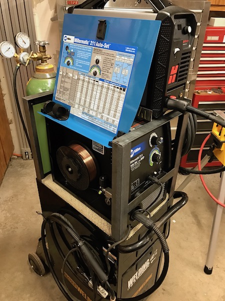

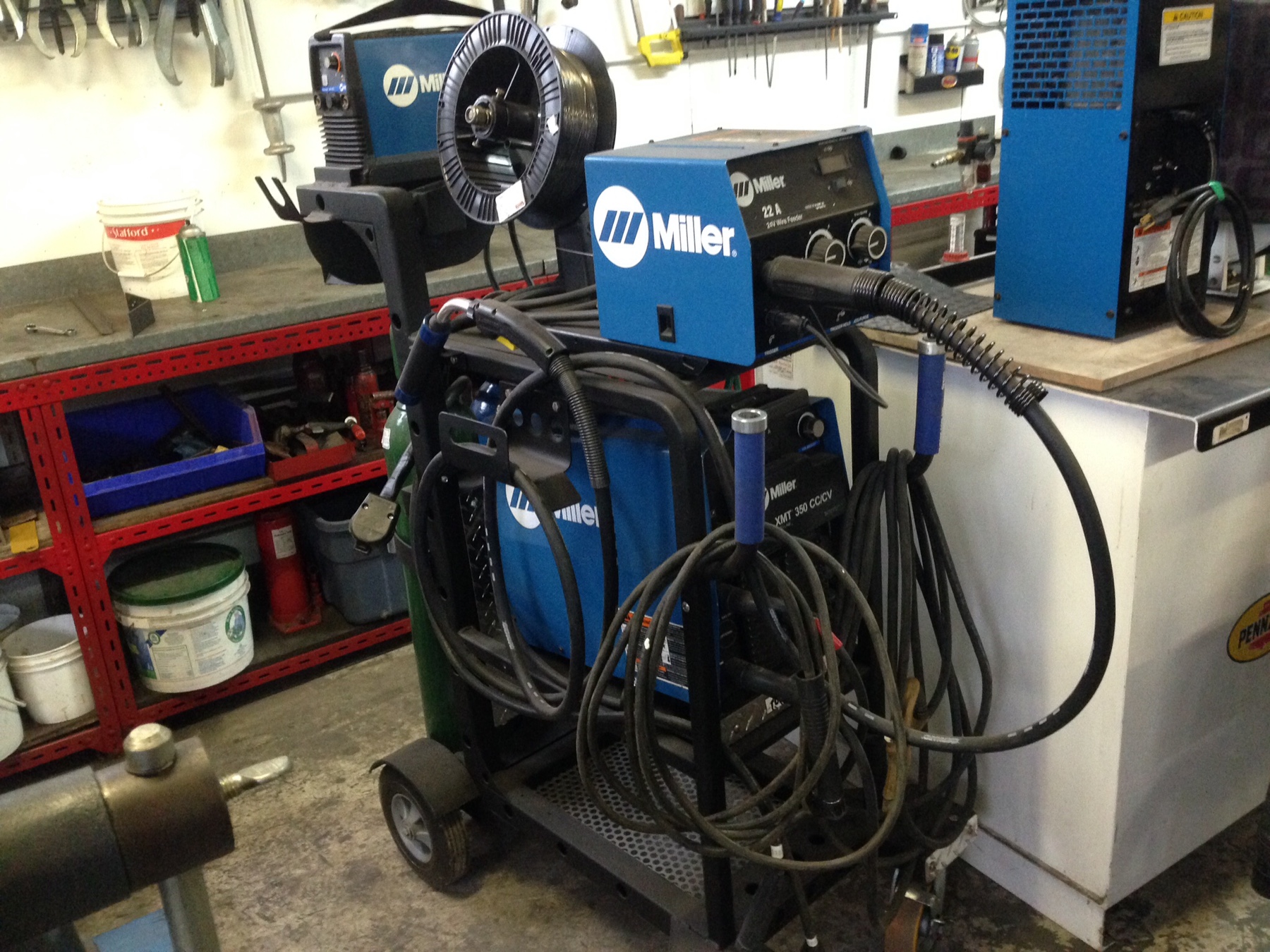

Been running .030 exclusively with my 211MVP. I don't do so good with 14g or less, either. I guess I have to go through the hassle of swapping out wire to .023... or get a new welder! :D

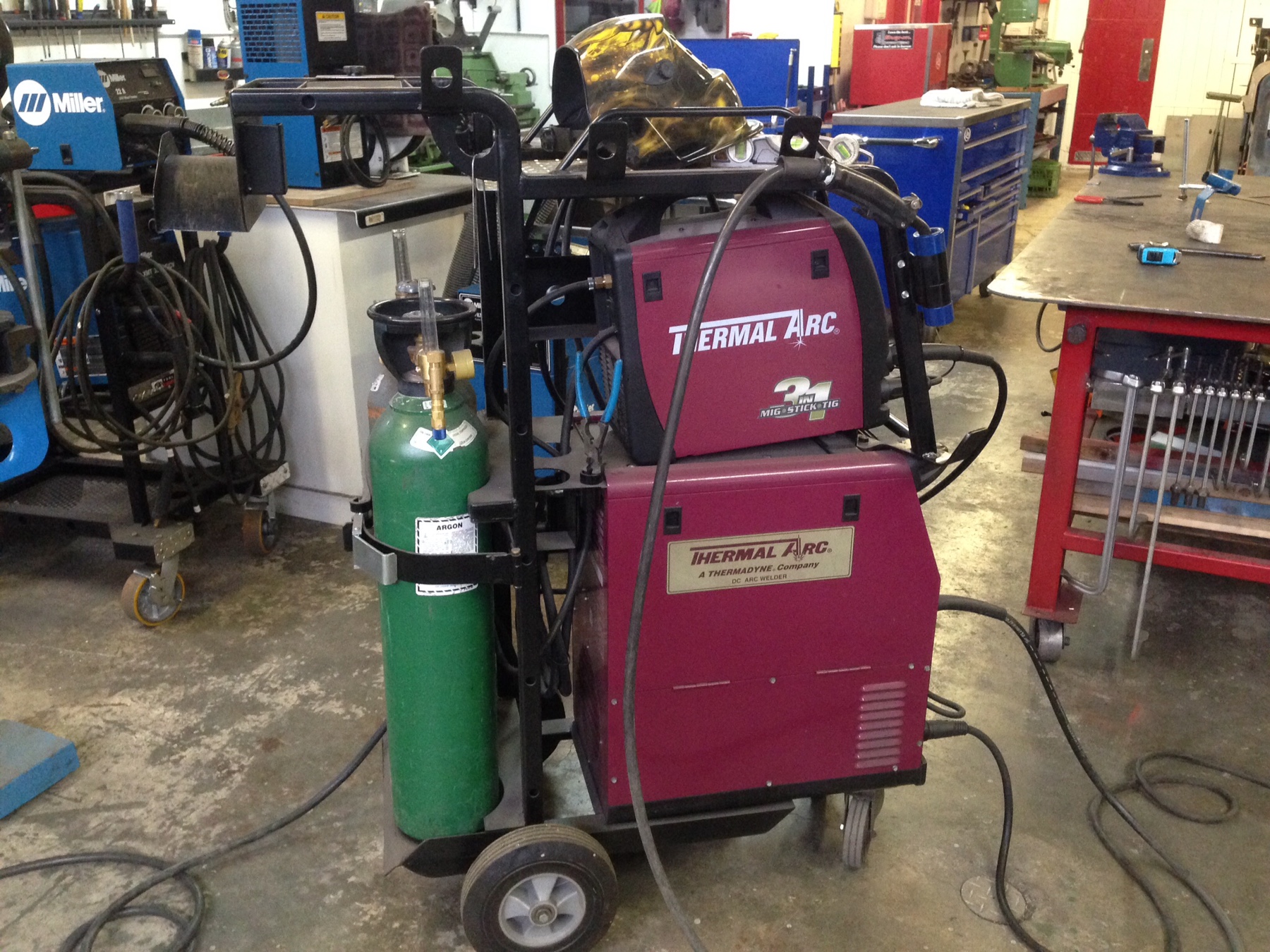

Not a farfetched idea Mark. That's what I did.
.023 in the top machine
.035 in the bottom:
.045 dual shield in the Miller:
   / MIG welding thin steel #14
.035 in the bottom:
But then I need another cart! :laughing:
Old pic. I have a better flow meter now but I am embarrassed to say I have yet to paint the rack I added to a HF cart . :ashamed:
I guess maybe I'll start looking for a bargain. Probably could get away with a 110v only machine then with .023? The Miller cheat sheet on the inside cover shows 3/16in max recommended regardless of 110/220 for .023. I doubt I have tried anything thicker than 12g, maybe 10g with 110v. Not sure why I would need .023 for anything but thin gauge material so no need for 220v, right?

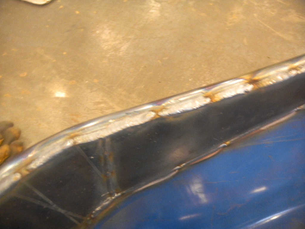

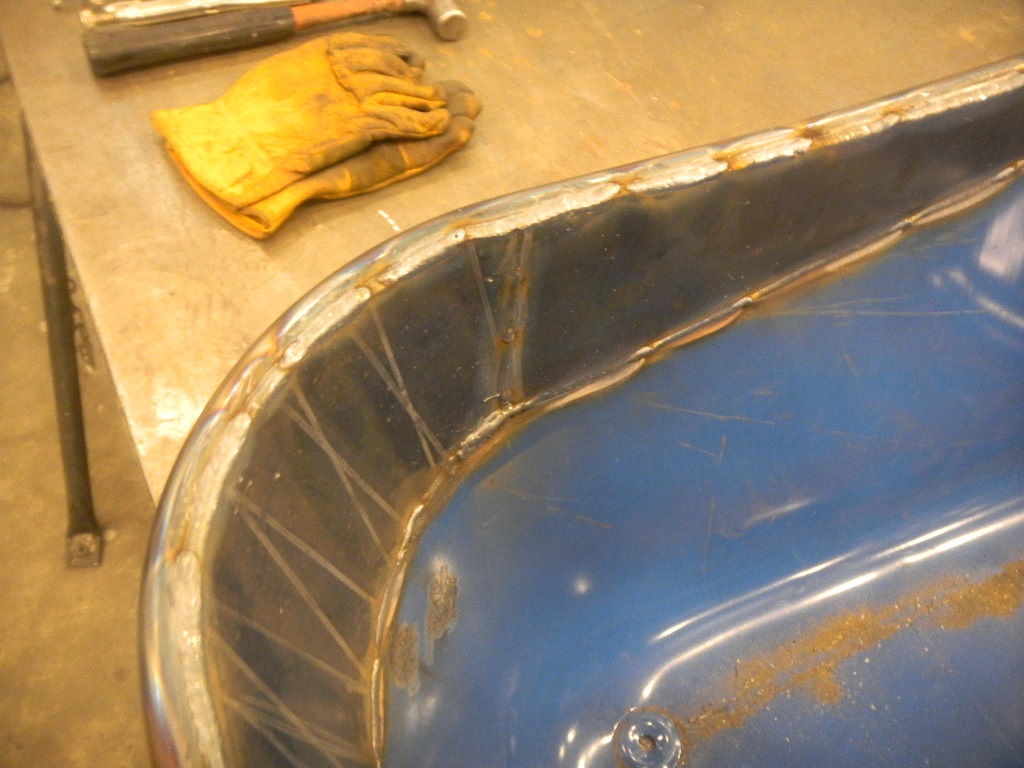

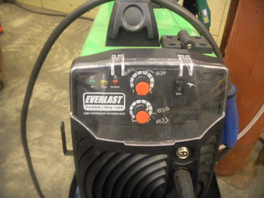

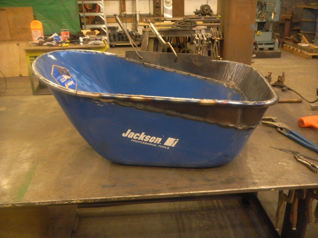

I'm not big on 120-volt welders! I like power!:thumbsup: Take a look at the Everlast 140E Mig welder. A guy who lives in Tacoma came over for me to help him weld an extension on to a wheel barrow. He is going to convert it to a power wheel barrow. That is electrical conduit I welded around the top edge.
