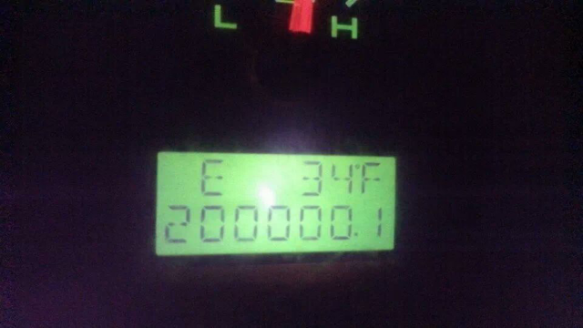

My buddy just sent me a pic today of his 09 F150 FX4 5.4L . It turned 200,000 miles on his way to work this morning. 5 years and not a single thing but oil, filters, tires, and brakes. OEM plugs still in it. Hard to believe they have not blown out of that 5.4 huh. Roll Eyes. So many on here want you to think every Ford blows up the second you drive it off the lot.

Here is the pic he sent.
