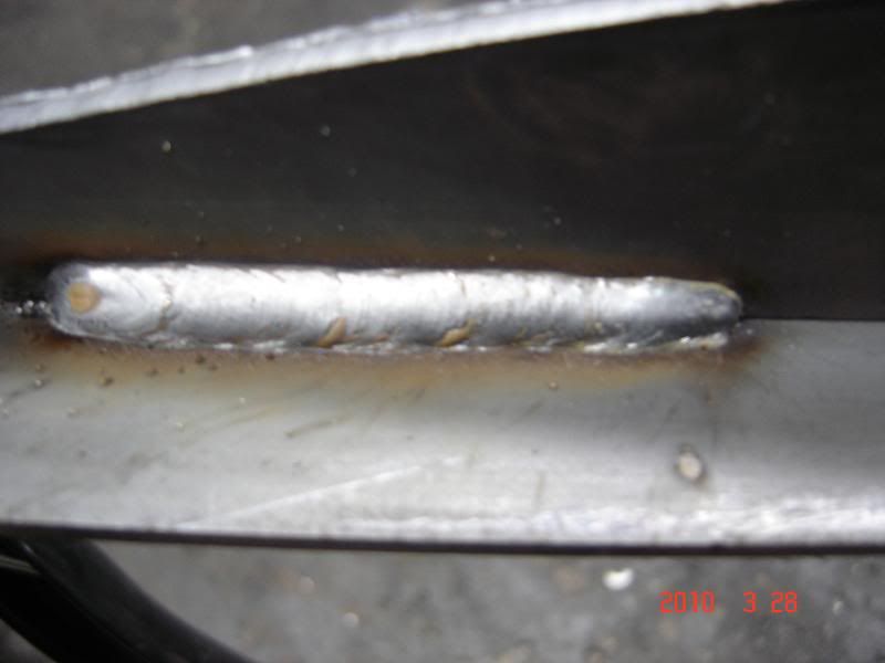

Paul, good to see you again. Can you tell me what thickness the metal is and what settings you used to make a this weld? Wish mine looked that good. Thanks for posting here.
Good to see your still here as well my buddy. As for that first weld. that was on 1/8th plate. Remember it was the first weld with this machine so just in case I got lucky with that first weld I decided to go back out in the shop and try it again so the next two I show you will be the second and third welds I've done with the thing.
OK. The first pics are 1/8th plate again. The first photo will show the machines setting it was on when I did the weld and the second pic will show the actual weld. The third photo is the shear cutting some 3/8th flat bar that I used in the next two photo's for you. It shows the machine settings and then the last weld. I did no prep work before these welds and the mil scale was still on. There was no clean up after the weld either. what you see is what you get here.
Now take in account that these setting were set up using Blueshield 8 which is 75-25 which means that I'm using 75% argon and 25 % CO2. I'm also running .035 solid wire as well. IF you are using flux core there's not a chanch in you know what that your welds will look like these in my honest opinion and I wish someone would prove me wrong. Have a look.
I'm pretty sure I am using the same wire and gas in my Miller 185, I know I am NOT using flux core wire. My welds recently looked very bad (porosity issues). I'm guessing I don't have enough gas, valve was only cracked open. Metal was very clean, no dirt, paint, etc. Practice, practice, practice. Of course I'll never be as good as you, your work is incredible! Take care and thanks!

Set your regulator around 20-30. Even 25 is good and don't let any wind hit it or even have your furnace blowing towards you when your welding. Practice makes perfect. I'm hoping to be good at it some day too :eek: Good luck :thumbsup:
