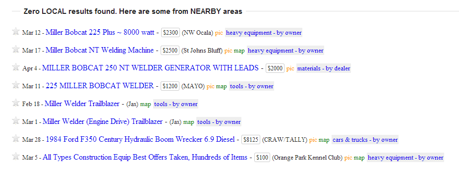

I've been looking for one for awhile.. the first one I saw I let go that had 2000 hours on it and long leads.. the guy wanted 800 bucks... I thought it was too much!! since then I haven't seen one for less than 1400.. most are around 2000.. I've seen some that look like they've been witthing outside in the rain for the last 10 years and they still are asking 1500-2000 bucks..

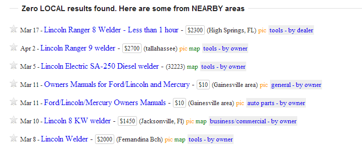

The same for Lincoln Rangers.. 1500-3000 usually.

Examples:
