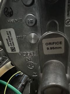

I have a 8 year old 20 KW Briggs whole home generator with a Vanguard 993 motor, and we have been having some issues with it starting. It will start, but it either takes a rather long crank or 2 tries. You can also get a whiff of propane while it tries to start. We narrowed it down to needing a new regulator on the generator. This started with it throwing a low voltage code, and it appears it was having some trouble at full power keeping the RPMs up. A generator tech from the local company came out and looked at it and said he thought we had a bad motor and it needed to be replaced (5k for new motor or 9k for a new unit). The generator has 440 hrs on it, so I decided I needed to look into this more. Got a 2nd opinion from another company and their tech felt it was the electronic throttle control and that the motor was fine. I changed out the throttle control but no luck. I ran a compression test, one cylinder was 148, and the other was 150 psi. Oil pressure after start up at 3600 is 32 psi. Once fully running it is smooth and sounds good. I also checked and lashed the valves to make sure they were in spec. At this point, my understanding (from a fellow who fixed propane forklifts) is that when you have a regulator issue, it can cause hard starting because the diaphragm is not metering the propane correctly and can basically flood the engine on start-up. So we are now planning on changing it out.
I found the factory part BUT it is crazy expensive ($300), and even places that show it "in Stock" don't seem to have it and say it won't be available until late December. Here is the factory one (it is sort of down in a hole so not a great picture)

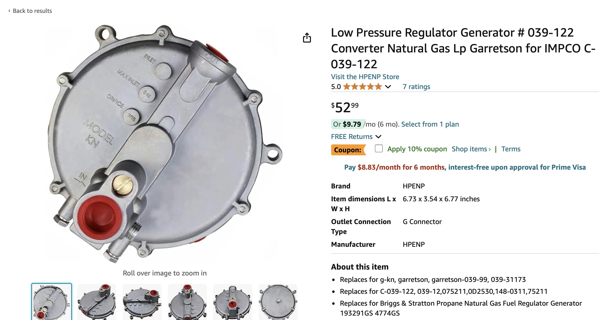

I found this one on Amazon
I noticed it is the same model (KN) but it appears to have a 7/16 orfice, whereas the Briggs one is 9.95mm. Does anyone know if I can just remove the original orfice and put it in this one? I am GUESSING it goes in the bottom side where that treaded plug is at, correct?
I don't care if I need to buy a gauge set to get the pressure adjusted but is there anything else I may need? I am familiar with gas motors and comfortable with piping gas lines, but I have never messed with regulators or taken one apart. Can't say I know much about propane either, but it looks like it is time to figure it out.
Thanks in advance for any help you can offer!

First, I think that you are probably right about the regulator being the issue, but I would check an few other things first.
First, I would check that your propane tank is not low. Second, I would double check that the pressure out of the main liquid LPG to gas regulator on the tank to make sure that it is at the right pressure. (Most propane companies will do this free, but check.) Third, have you checked the wiring connections on the solenoid and watched it move when the engine starts?
I do have one question: is the main propane pipe from the tank to your generator the correct size specified by the generator manufacturer? (I've seen installations where the pipe wasn't large enough, and / or the pipe had elbows too close to the generator. The symptoms were similar to what you are experiencing.)
All of these point to not enough propane getting to the engine, either due to low pressure, a clogged orifice, or plumbing that has restrictions in it, or possibly a bad solenoid / controller.
Natural gas and propane regulators have different sized orifices, and are normally an easy swap. I would double check with Briggs/Vanguard that the 9.95mm (0.391") is correct.
Good luck!

The orifice in the new regulator is larger so it won't be an issue, smaller would mean it couldn't deliver the required volume of gas. You should be able to swap it if you want anyway.
The most common reason regulators fail is oil contamination. The usual symptoms are hard starting due to the reg sticking but sometimes a gen will run good for 10 minutes or more then die or nearly die and pick up again, repeating over an over as oil in the line blocks the flow of gas until there is enough pressure difference for a bubble of gas to push through then the cycle repeats.
Check the line to the regulator and the regulator itself for oil, if there is oil in your tanks the new reg will fail as well. LP should not have oil but being a closed system, it's nearly impossible to tell if a pump on a truck or a filling station is leaking oil into the gas. I've seen dozens of tanks and regulators contaminated by a single truck that supplied all the customers in one area.
If the orifice is larger, It could supply too much gas and cause the motor to flood . Personally, I would stay with the factory recommended orifice
The regulator will still limit the gas supplied to the pressure it's set to so it won't flood the engine but a larger orifice will make the output pressure less stable as the regulator will cycle open and closed more often to maintain pressure. With the difference in size here it's not likely to be an issue however as he could swap the orifice with the original to keep it as original as possible which is always best.

If you do buy another regulator, I can't suggest strongly enough that you get a UL listed one - and make sure it's really UL listed and that that's not just on the casting. I'm all for getting cheap stuff until it comes to gas or lots of electricity.
If you don't, bad things could happen with insurance after a fire.
Looks to me that what you're looking for is a "model KN" regulator. Getting a real IMPCO one may cost a few more dollars but I don't think you're looking even at $100. (example $73).
Note that you'll see items described as "for IMPCO ..." and what this means is "hypothetically the same as IMPCO but not IMPCO".
Assuming this one is legit and not a copy (never know with amz, and I'm not sure if there are copies with the UL stamp of the century version), it's a little more pricey but supposedly has 3 in stock: (link $100).
