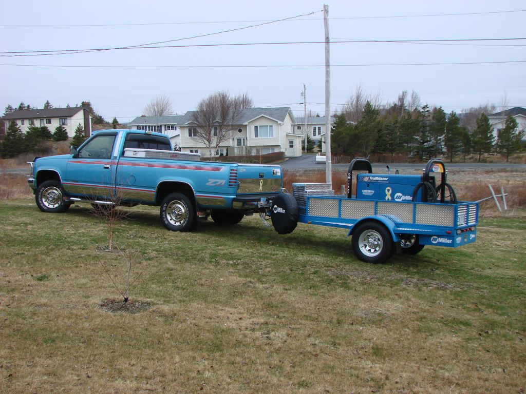

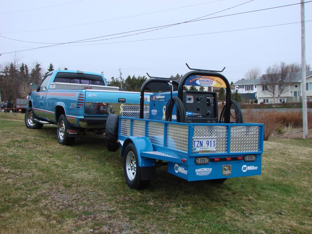

I purchased a new 2008 Miller 302 Trailblazer last summer. Great machine. A lot quietier than my buddies Miller Bobcat welding machine. The Trailblazer welds as good as anything else I've ever used or owned and has plenty of generator power to run lights and other tooling while your welding. The Miller trailblazer has two-generator system which perform like no other welding machine. I'm very happy with mine. I also built a custom trailer for mine. Here's a few pics and video's. Good luck
Check out it's specs. That's what I did before I bought one. http://store.weldersource.com/907216.html
YouTube - welding trailer
YouTube - Miller 302 Trailblazer
YouTube - Trailblazer lights
