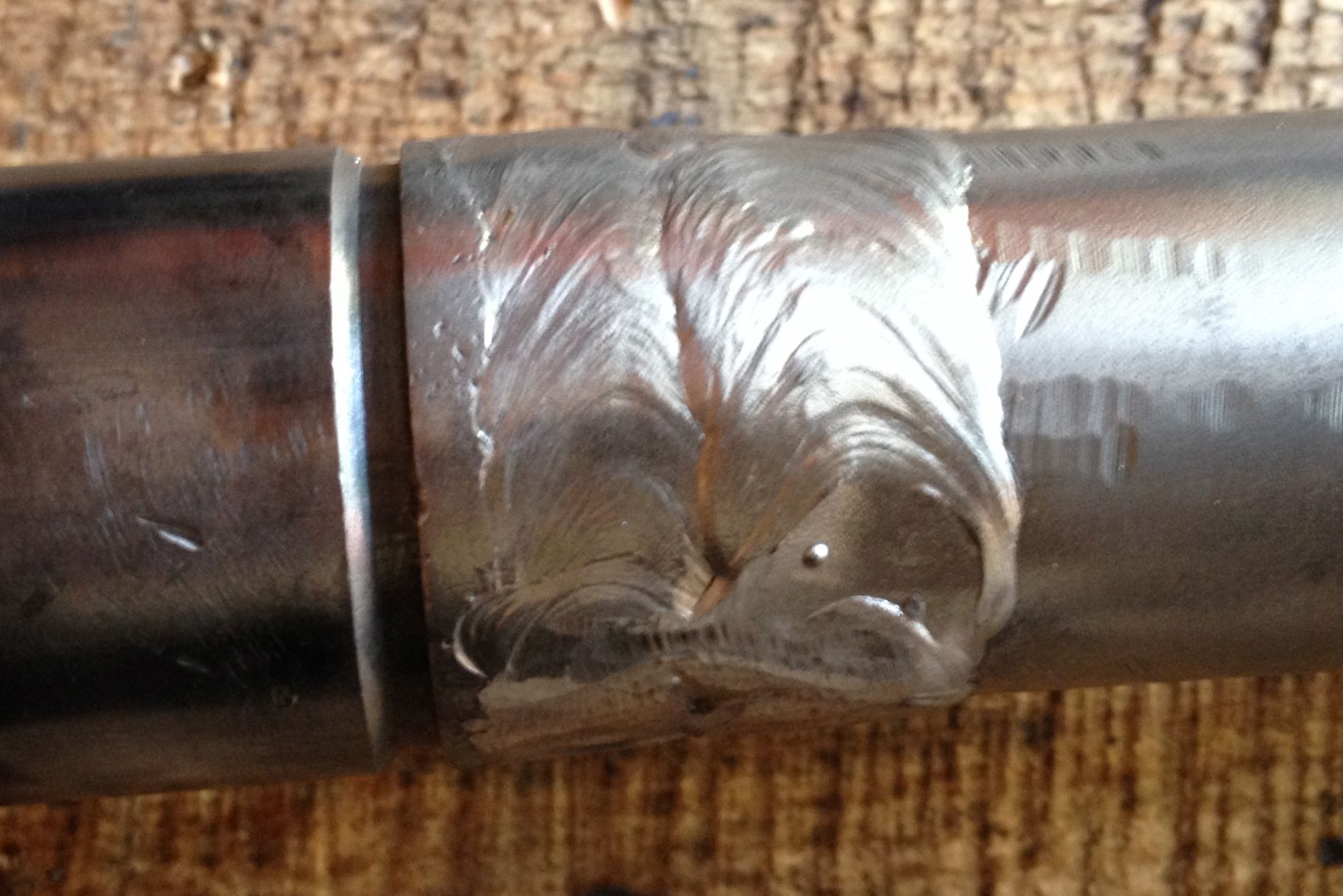

I have a MultiMatic 200, I like it. I move it around a lot, it's very nice for portability. Welds good too. I have only used it as a MIG. I bought it because I was planning to weld a 1 1/4" shaft and I thought I was going to have to stick-weld it, which the MM200 does. But in the end I MIG'd it and it came out great.
This is a solid steel 1.25" diameter shaft. welded with my Multimatic 200, using .030 wire, on 240v, using a 1/4" thickness preset.
385696d1407474723-millermatic-200-elite-img_7819the_weld-jpg
If somebody told me that I couldn't have a MultiMatic 200 I wouldn't know what to get instead but I suppose I'd have a little more money in my pocket. Portability is a nice feature for my usage. I have the spool gun # stick stinger but no TIG equip (yet).
Other photo is simply showing welding a car trailer "out in the field" as a portable welder likes to do ! I have a little 20CF gas cylinder too (which I probably should have used rather than lean that 80cf against the trailer).
