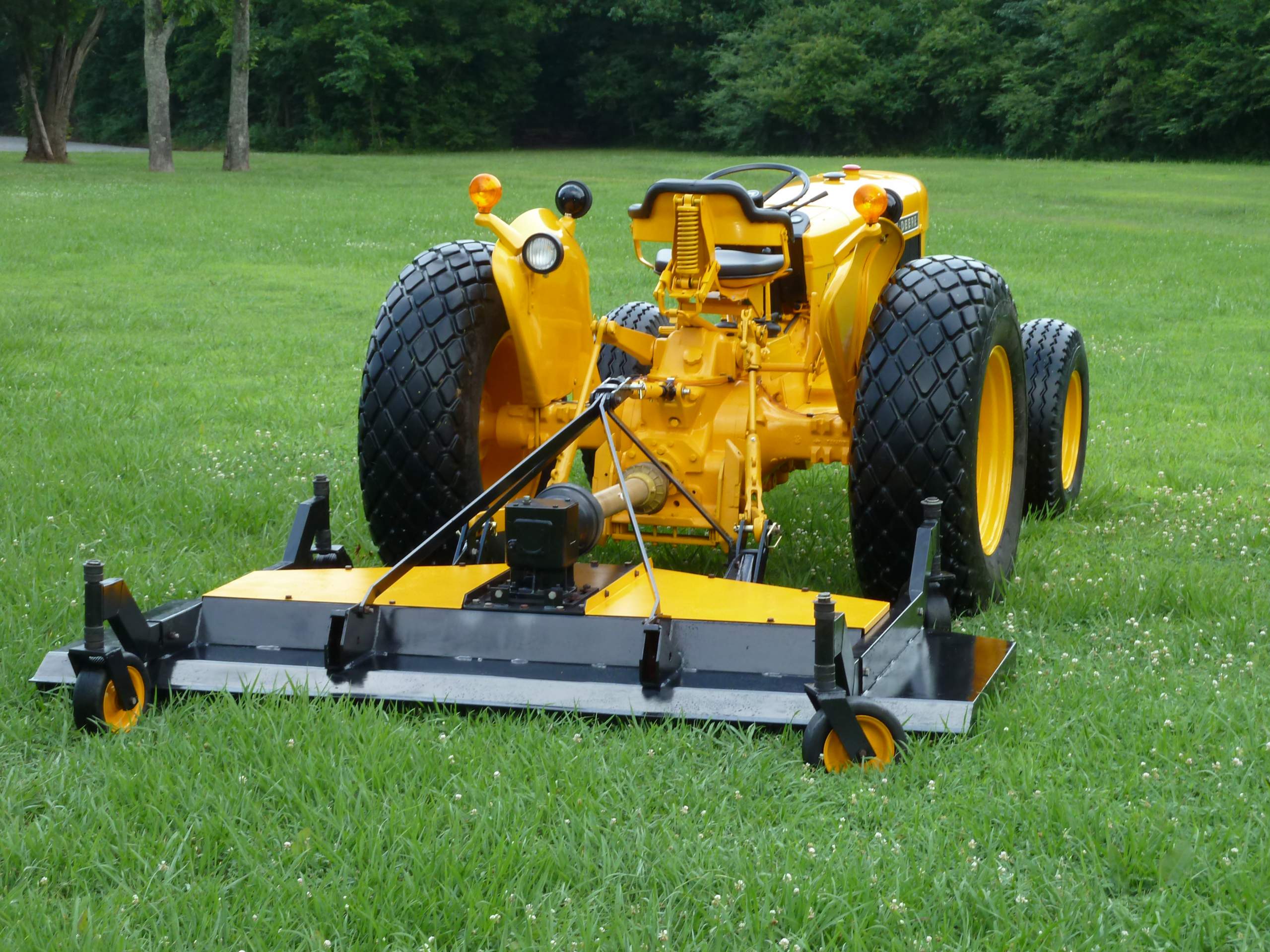

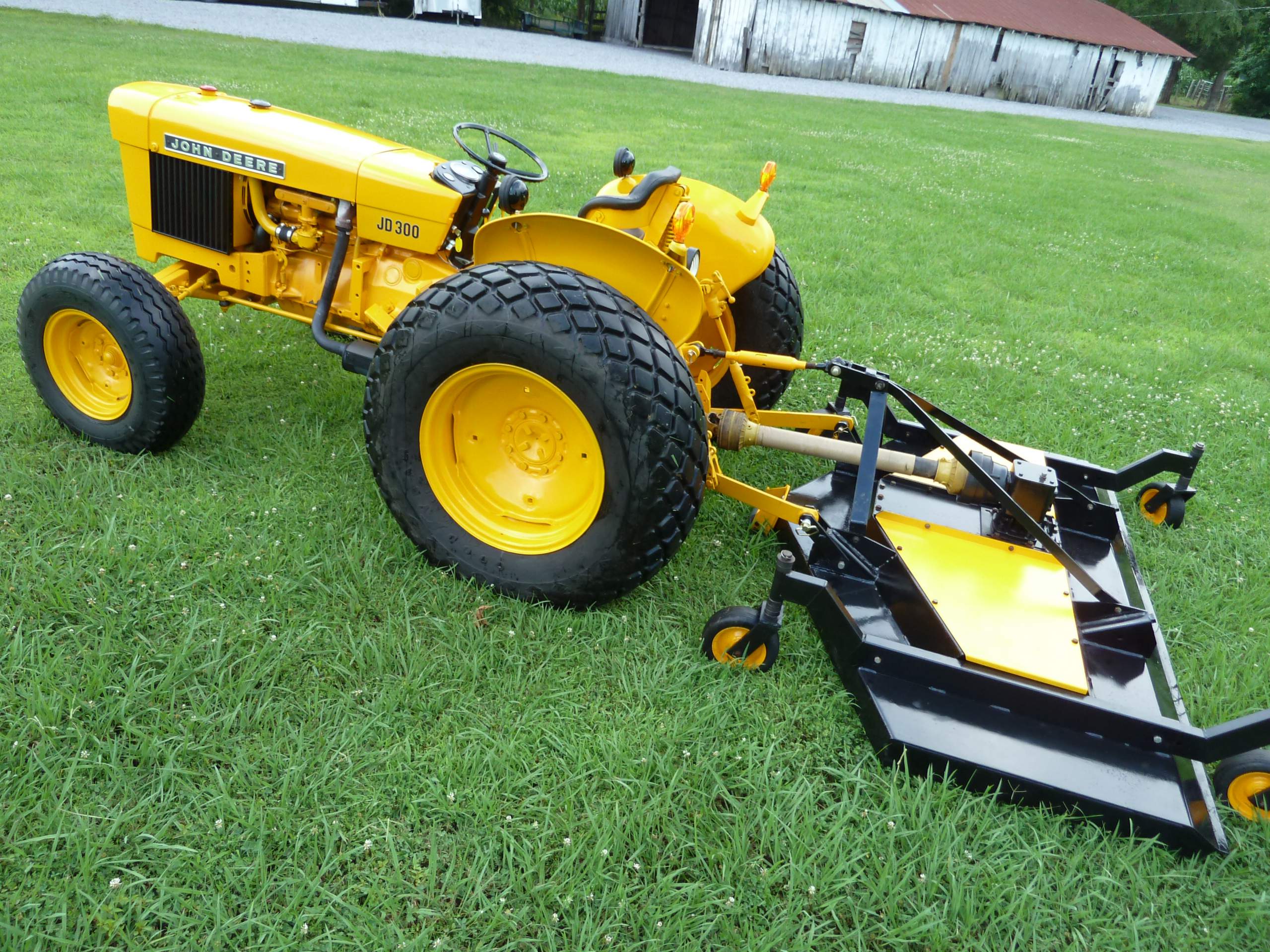

This is a 96" LMC (Sovema EMH-2) on my restored JD 300. 43 gas Hp. The mower is way heavy and over 800lbs. Its really a near perfect match. I end up running a little hot on the PTO to get a nicer cut, but the power is just right, even enough for thick 2 foot grass (going slowly). I would go no less than 35 HP for the tractor to ensure you have adequate surge power. ;)

View attachment 329479View attachment 329480
Nice mowing rig!
