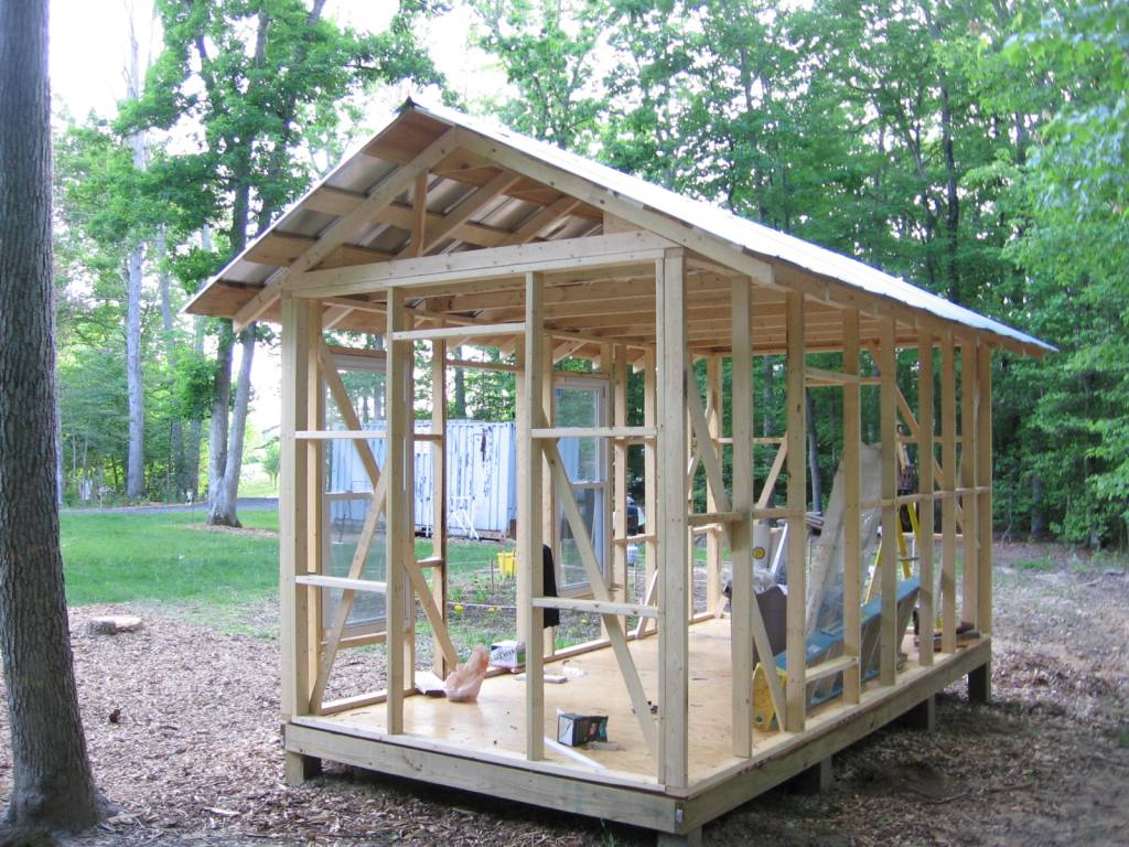

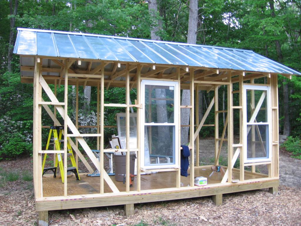

As you can see in the picture above, I've made a little progress. I got my air compressor figured out. My solution was to run a 12 gauge 80' cord from an outlet right next to the breaker box, and plug the compressor into that. Then I had another 50' of regular hose, and 25' of coiled hose off the compressor.
Using the compressor and the roofing nailer made the roof go a *lot* faster. Using the framing nailer was nice for the sheathing and for the siding. In fact, for the siding, it is almost a requirement, because it is so hard to start a nail in that hardiplank.
I made the door using some 1/2" AC plywood. The back side is 2x4s, covered by the plywood, and then the front side has some decorative strips stapled on (1/2" x 2" staples). I used 3 3" hinges, and mortised them into the door and into the door jamb. I added a nice big handle, and a latch to finish it off.
As I mentioned before, the siding is hardiplank 8", and it comes in 12' strips. I used this because it has a 50 year warranty on it, and at just under $7 a strip, it was fairly cheap. The sides of the shed are 8' wide, and the main portion in the front is 4' wide, and yes, I planned it that way. You can cut the siding with a regular carbide blade (just don't breath the dust). I was sorely tempted to buy a sliding compound miter saw for this project, but I made do with my little circular saw, and it worked out fine, albeit a little slower.
Once again, using my little 8 gallon compressor, I hooked up my Critter spray gun ( http://wood.bigelowsite.com/reviews/critter.htm ) and sprayed the exposed pieces with primer. It was getting dark at this point....
Still left to do:
1.) Paint
2.) Run electricity to the mini-barn (shed). Technically, this will be an "extension cord" run underground in conduit, but the end at the house will have a pigtail that plugs into a GFI protected outlet.
3.) Add lights, outlet, light switch
4.) Put up divider wall between the bedding area and the hay/grain storage.
5.) Add half door inside to provide access between bedding area and hay/grain storage
6.) Put up electric fence
7.) Other stuff I forgot. :)

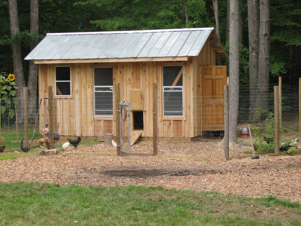

Slackdaddy, if you're going to do it, do it right, right?
I've been somewhat AWOL on my project. Other projects got in the way. I did manage to put the drip edges on, and get the gutter up. Last minute change in that the wife wanted the gutter to empty into the water trough (not in place yet), so the downspout looks a little funky.
Still left to do:
1.) Paint (Now have the paint chips picked out)
