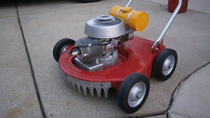

If I was trying to make a rough cut mower from a lawn mower the first thing I’d do is modify the front of the deck with a torch.
/ Mini Dozer Build #13
If I was trying to make a rough cut mower from a lawn mower the first thing I壇 do is modify the front of the deck with a torch.
Long ago mowers often had a slotted front guard that was great for cutting tall weeds. The blade could cut the stem before the deck pushed the stem flat, like mowers now do.
Here's a photo I found. The one I used had slots that came up closer to the top, so would work even better than this one.
Bruce
/ Mini Dozer Build #14
I wouldn't recommend it.
I did that to help tackle a yard that hadn't seen care in years. The tip of the blade broke fairly quickly, so I zipped the other tip off to re-balance, and it broke again almost immediately after I hit some more weeds. I think something else happened with the second break, but I can't recall what.
They just aren't intended to be loaded that way would be my guess as to the root of the problem.
I think pushing the stems flat before the cutters engage long stuff helps spread out the "engagement area" of the cutting blades would be my guess.

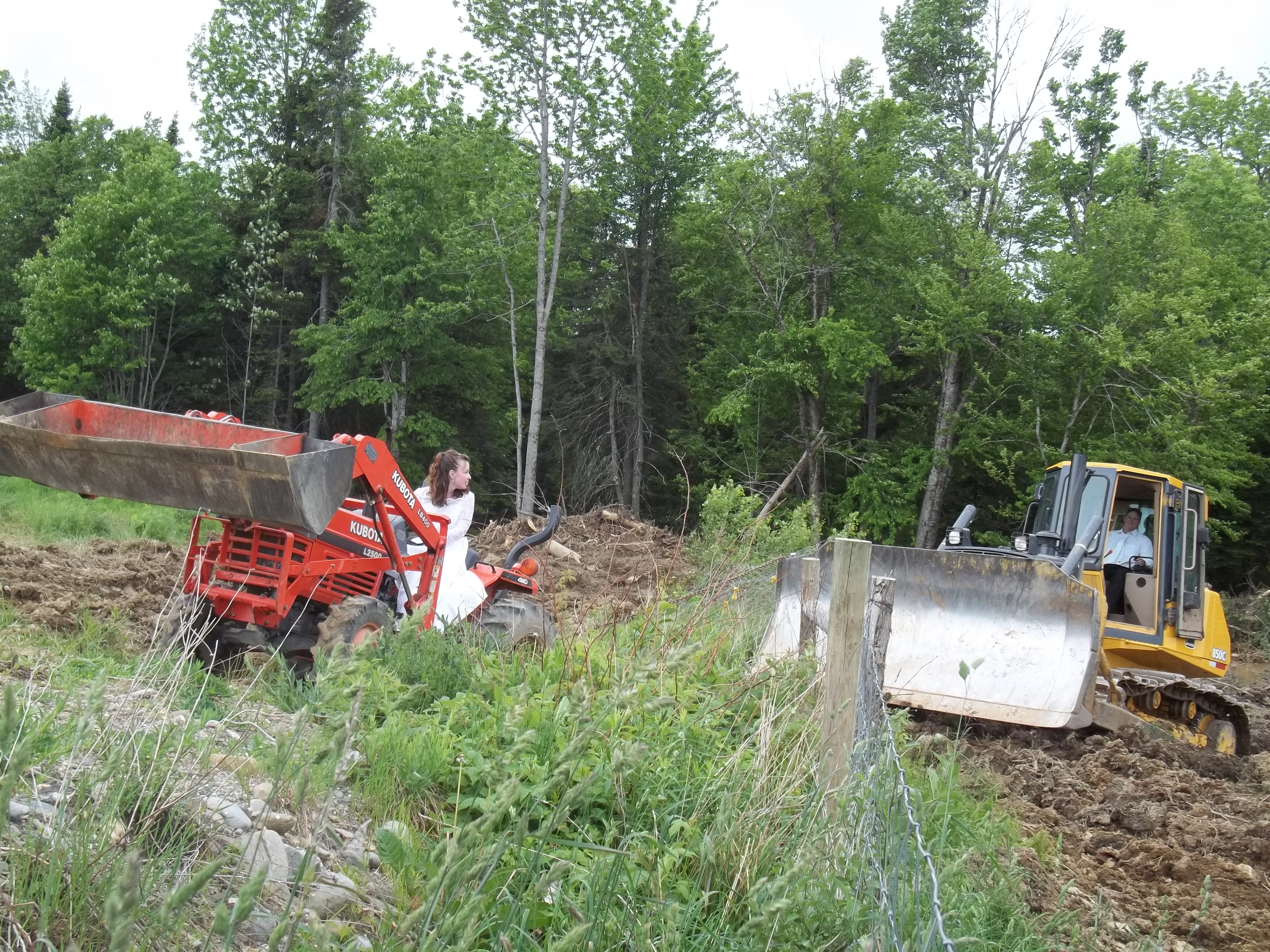

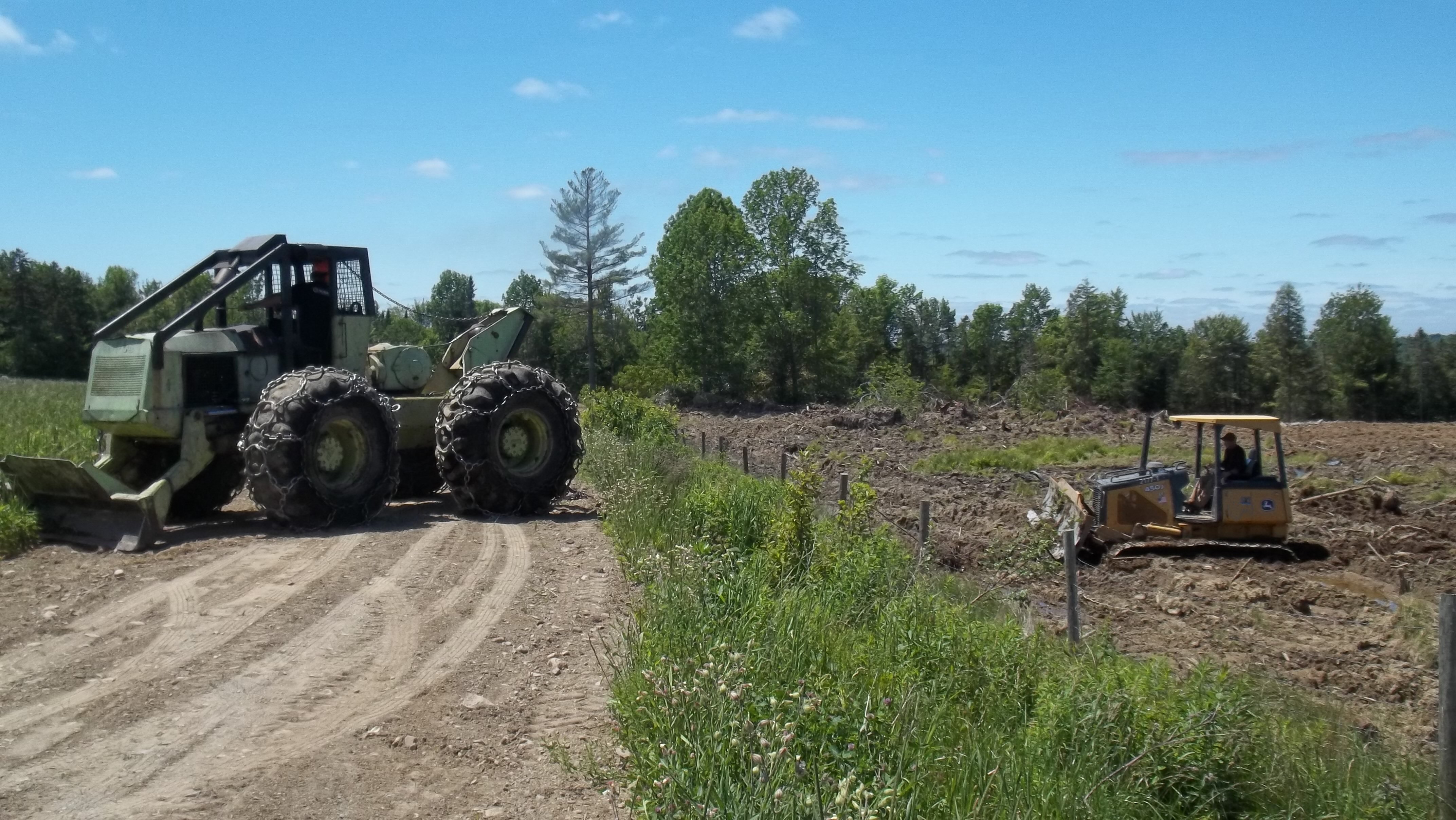

I clear a lot of land and cut a lot of wood and agree with everything that has been said.
Anything less than a John Deere 850 is not going to clear land; I know, I tried a John Deere 700 and it was pitiful. I also had a John Deere 350 and a John Deere 450. Of the latter two, the 450 could out push the 350 when it came to dirt work, but logging...they were pretty much the same as far as pulling wood.
I once heard a guy say that his 350 John Deere was good up to a 2 foot stump, but I just shook my head. I hated to push 6 inch stumps with mine and felt I was beating on it doing so.
