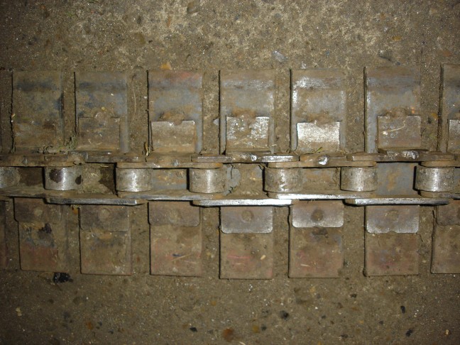

Well the weather has warmed back up and the dozer has moved back to the top of the project list. I had a short trip down the Spring time maple syrup wood fired arch project. Helped a few rebuild one and took the scrap metal and made a unit for me. Ended up with 1 1/2 gal of syrup but only caught the end of the run. Next year I will be ready.
Not much as happened with the project since I last posted. I have driven it around the yard and into the woods but still have to make the tensioners for the drive chains. I was able to find some small 100 pitch sprockets which would allow me to power directly to the track and get rid of the smaller drive chain. My next step is to do a test run to see how the machine handles if I change the gear reduction from 3.4 to 1 to 2.5 to 1. If the pumps and gas engine perform OK I will move to a direct drive system (which will be 2.5:1). I am sorry to say that the rebar on the track works fair. The rebar is to small and in deep wet snow (6-10 inches) the dozer will not climb a steep hill. It goes fine on the flat and slight hill but the track just slips in the snow. Something like 3/4 or 1 inch flat stock may work better.

Sorry to hear the rebar didn't work as well as you had hoped, as it seemed like a great idea. Instead of flat stock, how about using angle-iron instead? The legs could be welded to the track shoe, and the point where the legs meet would dig into the ground. It may make for a rougher ride; but I suspect it will do better traction wise.

Another option to consider for traction is a dual track system. Keep your re-bar tracks for your summer activities since they seemed to work fine in the summer. Then convert some old snowmobile track for your winter activities.

Great project - very well thought out!
Some pictures for tracks...that might be of interest.....
Cheers, Manne

Maybe you could try some 1" angle iron, if you think it will be thick enough to withstand the stress?? The angle would give more lateral support to the wide tracks (against bending) and the 1" vertical piece should give better traction?

Have you though about buying some grouser bar to weld to that rebar?
