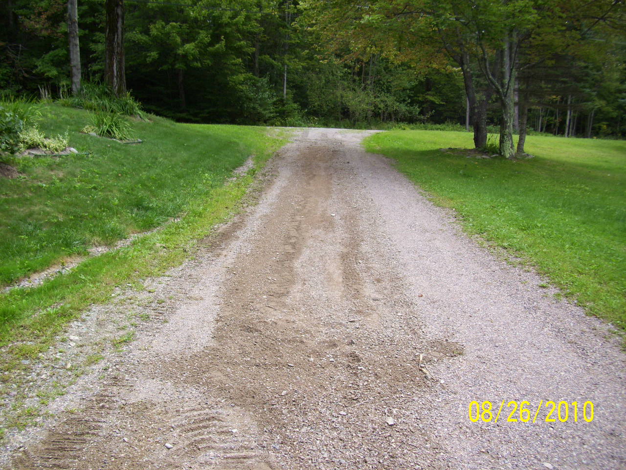

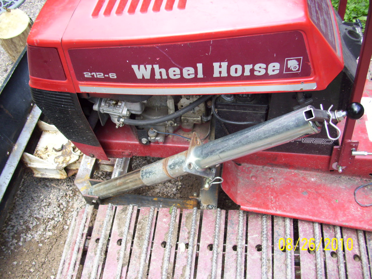

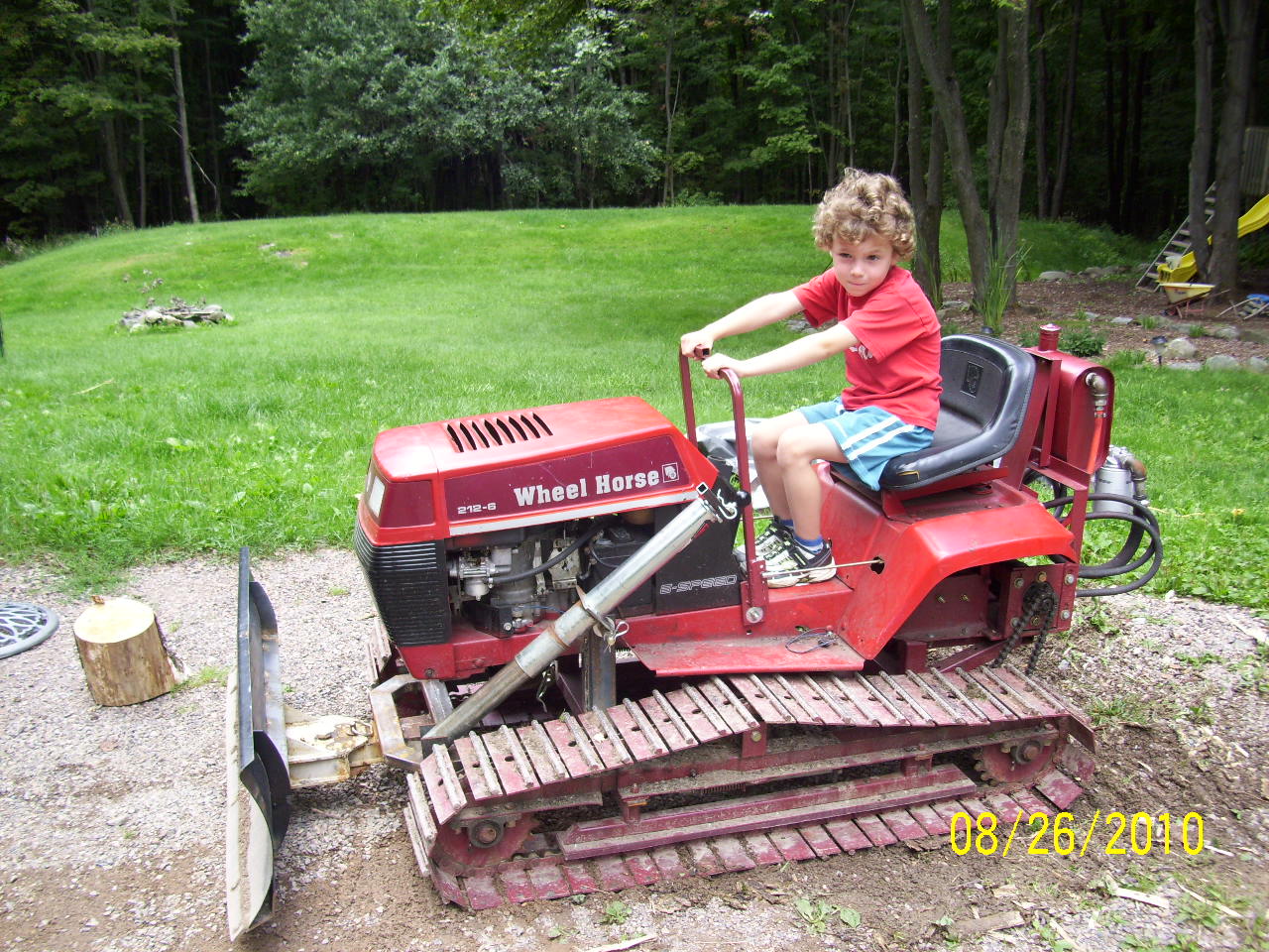

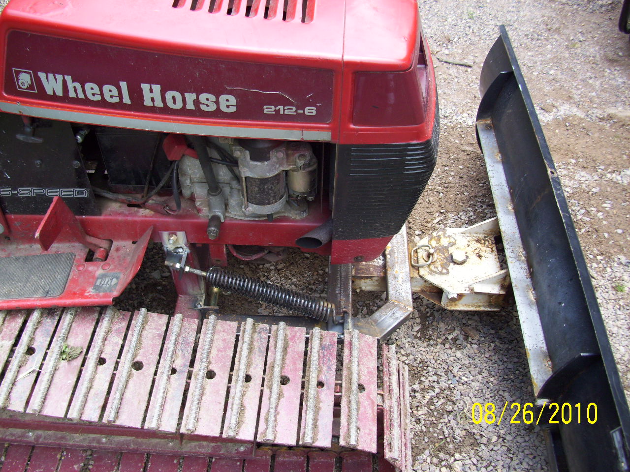

Well work continues. I took a broken trailer jack and attached it as a lift. This worked OK but with the weight of the blade it took a little work to lift up. I then added on the other side the trip spring from the lawn tractor snow blade. Once I adjusted things the trailer jack works great and allows me to have down pressure. I have some disassembly, adding supports and painting. I have also included a test run up the driveway. The fixed blade holds a nice grade. Have some ideas for an optional floating setting but will do more testing before then.
