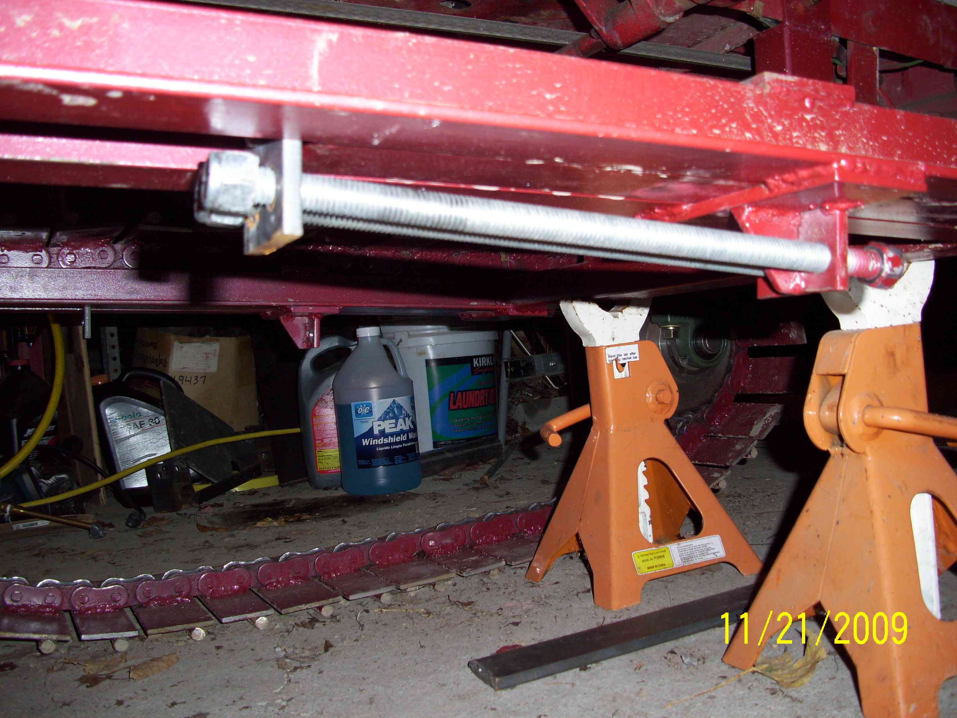

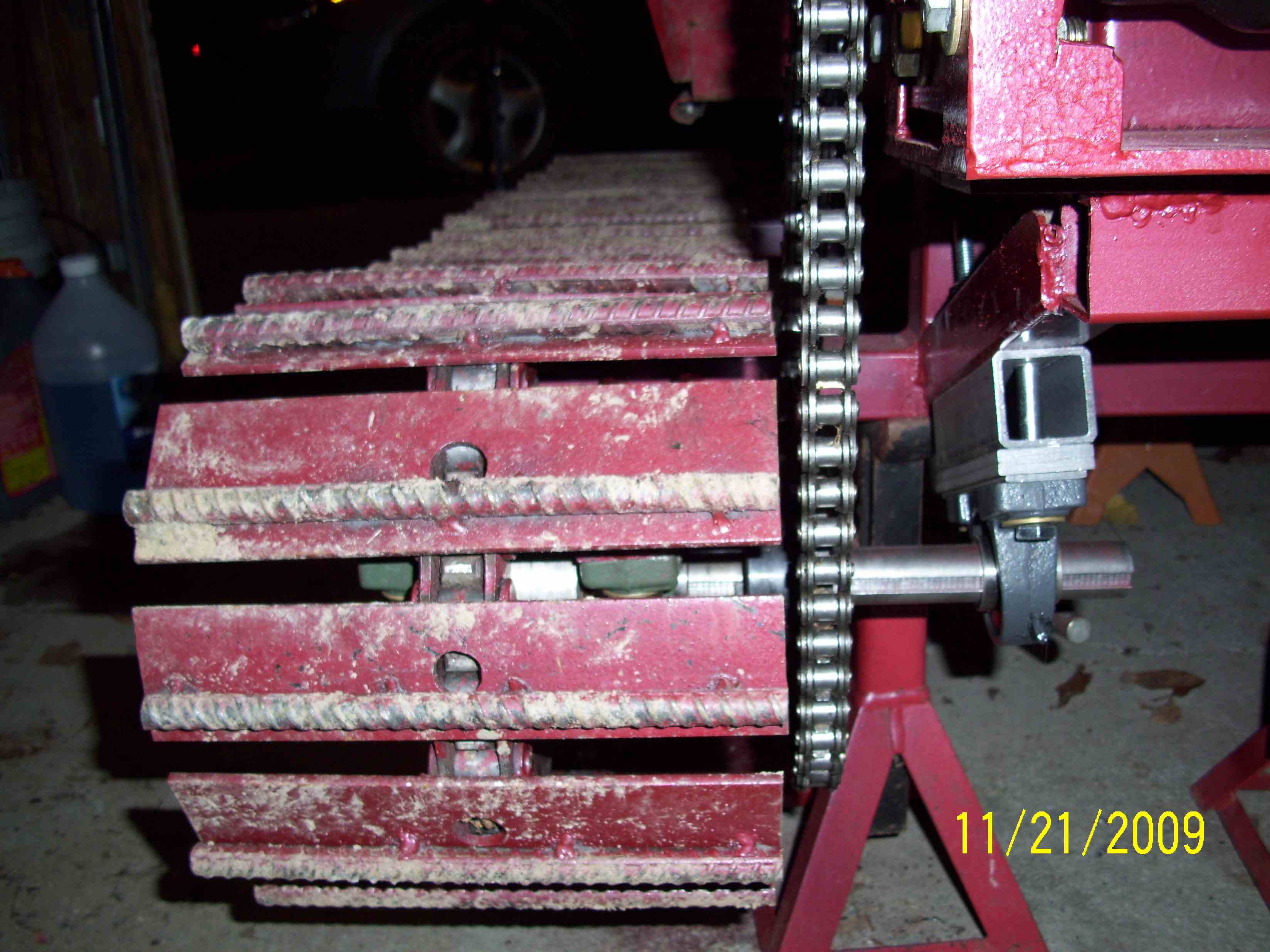

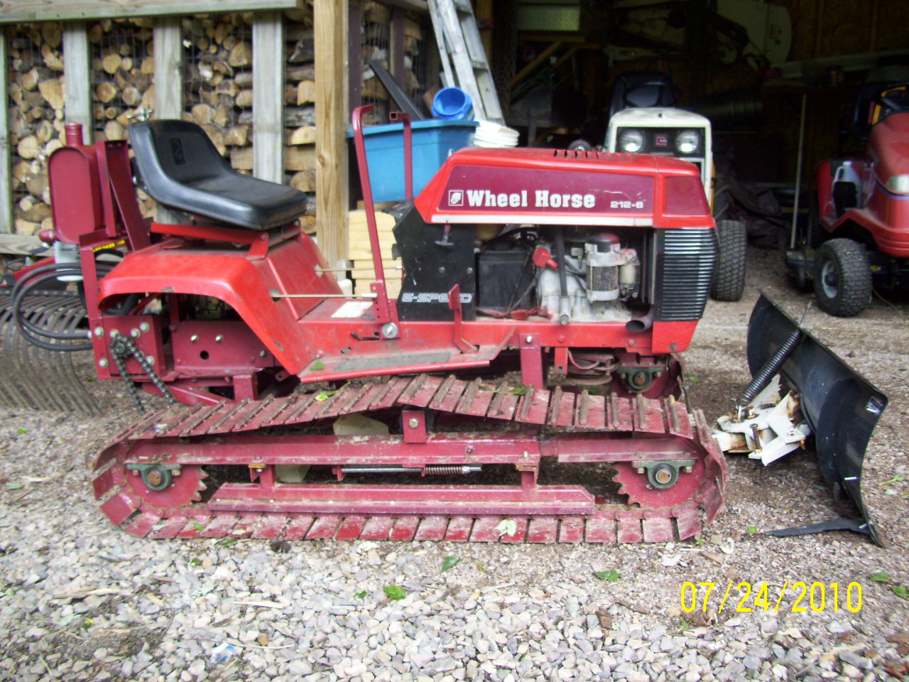

After a long break due to items on the "Honey do list" have returned to work on the mini dozer. The first photo has the small blade sitting infront of the machine. I am working on the mounting and lifting brackets for that.

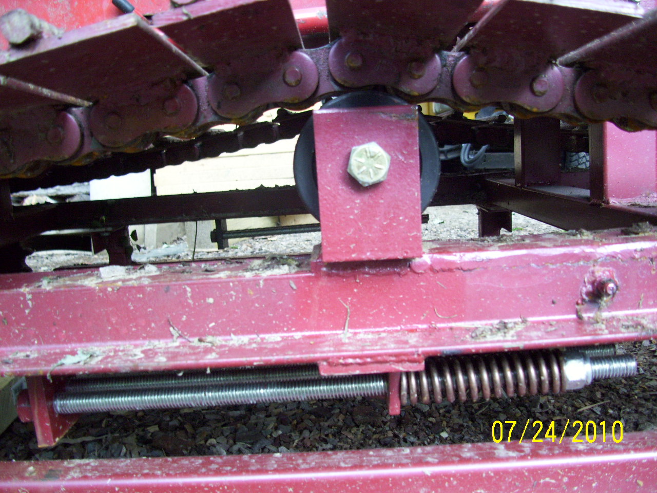

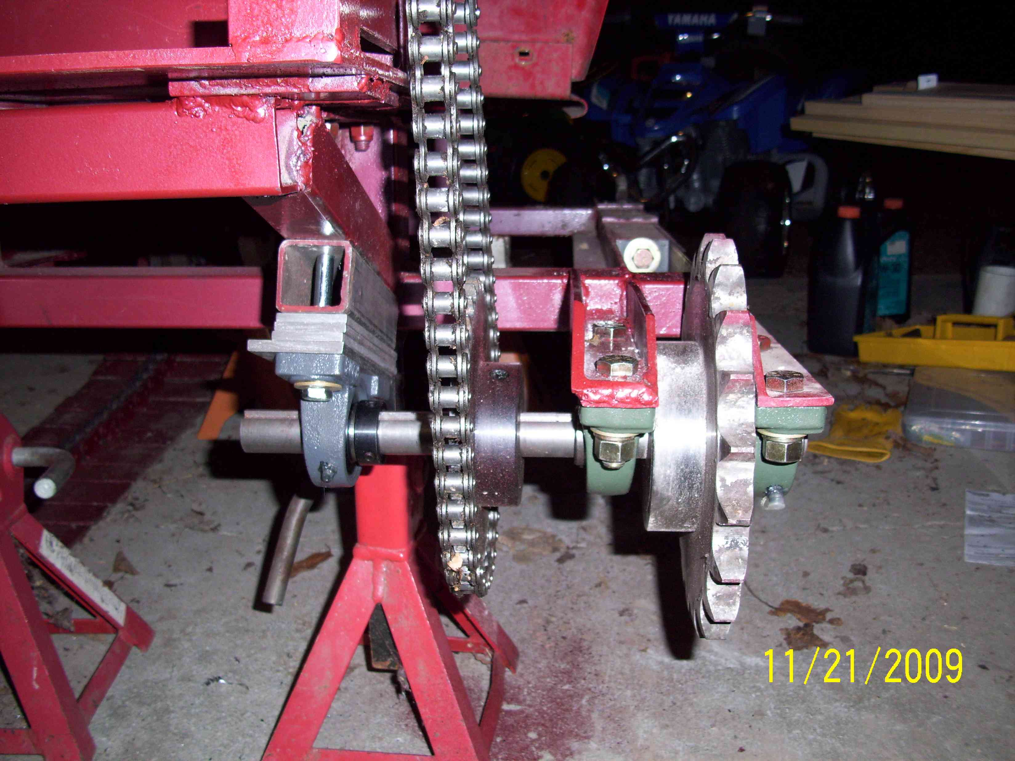

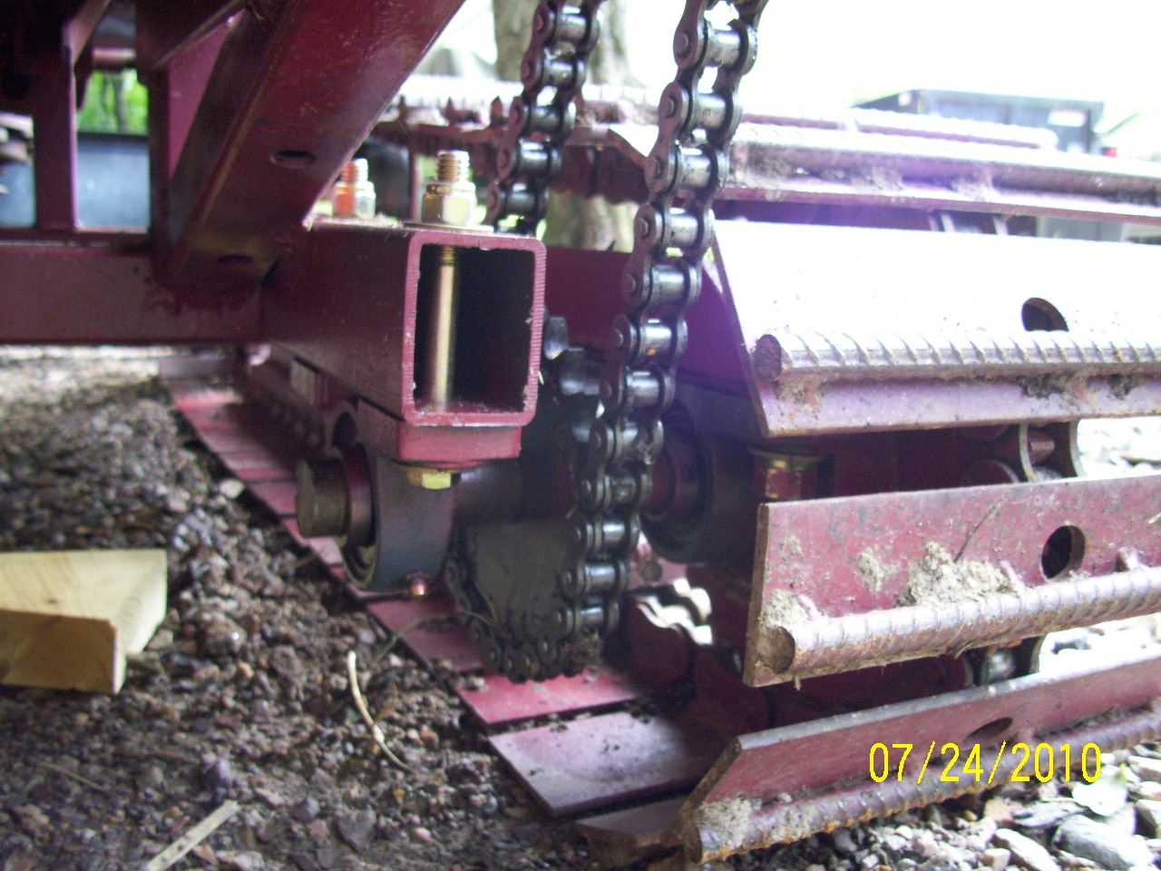

I have added double spring tensioners (each spring is rated at 400 lbs per inch) for the track tension along with grease fitting to keep the parts sliding. I have added a middle wheel which helps keep the track off the frame and also indicates the tension of the track. I changed the drive ratio from 3.4 to 2.5 to 1. This put a smaller sprocket on near the track which seems to work better than the larger sprocket because it picks up less dirt/leaves/sticks. Should get the blade frame done this week.

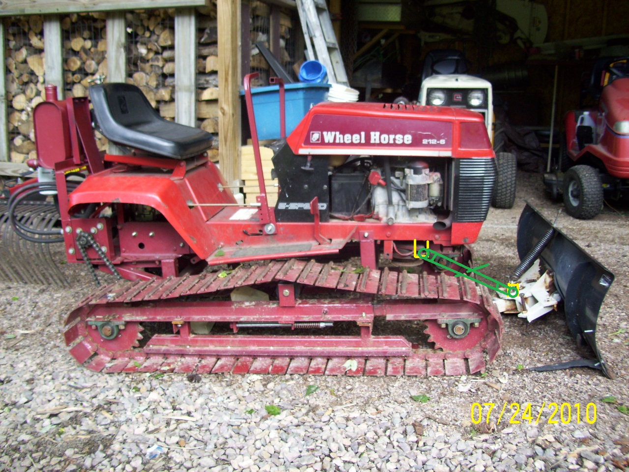

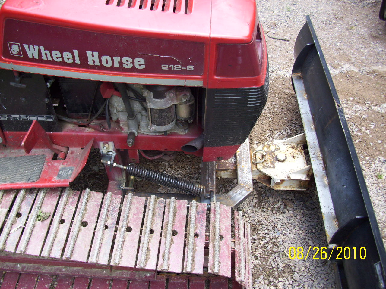

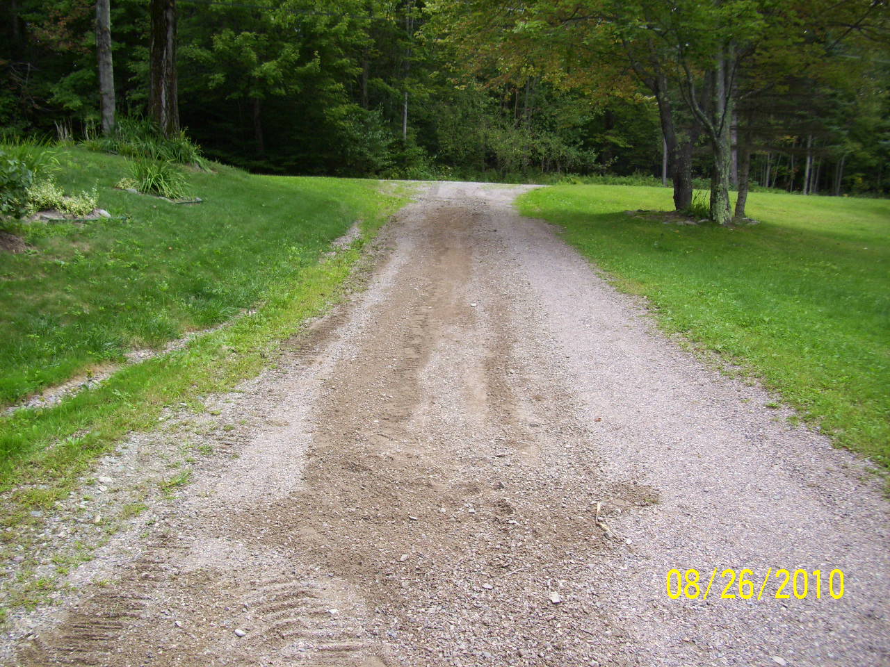

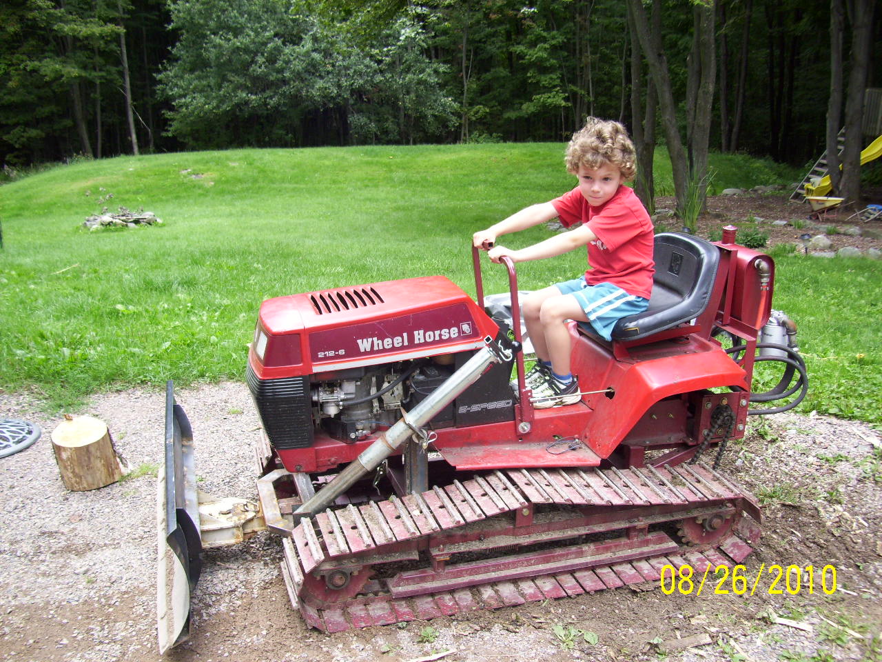

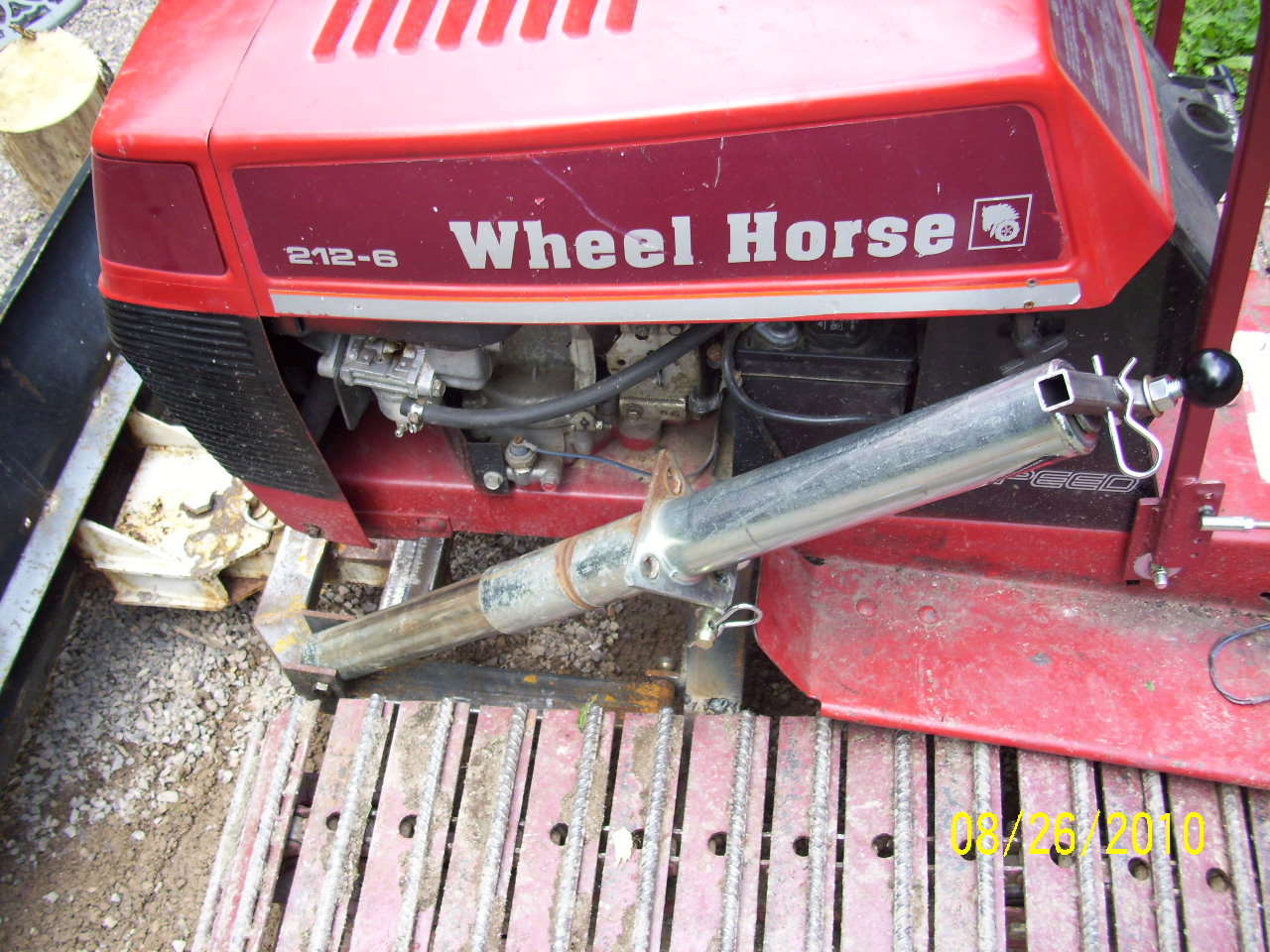

Well work continues. I took a broken trailer jack and attached it as a lift. This worked OK but with the weight of the blade it took a little work to lift up. I then added on the other side the trip spring from the lawn tractor snow blade. Once I adjusted things the trailer jack works great and allows me to have down pressure. I have some disassembly, adding supports and painting. I have also included a test run up the driveway. The fixed blade holds a nice grade. Have some ideas for an optional floating setting but will do more testing before then.

Put the mini dozer to a full work out yesterday. One of my neigbors got 2 loads of fill and we needed to spread them out. Looking at the piles it didn't look bad but you could hardly even get a shovel into it. This was the nasties stuff I have ever seen consisting mostly of clay with some rocks. I had to basically shave the sides of the piles a few inches at a time. And then push the fill over a bank.
We spent over 4 hours working the dozer and my small tractor to move the piles. So what happened.
Problems
1. Threw one track about half way through but noticed I hadn't tighted the track tensioner up to where I planned.
2. The trailer tongue jack work fair. The major problem is when the dozer is pushing, it is difficult to make blade height adjustments.
3. One drive chain loosened and started to POP 3/4's of the way through the project.
4. Drive belt from engine slipped slightly when really pushed and when the track would hold.
5. small stones getting into drive chain.
Solutions.
1. Keep track tension up.
2. Replace trailer tongue jack with linear Actuator
3. Add adjuster to help keep things in place and spring loaded tensioners to help drive chain stay in place.
4. Replace the old drive belt (same one that came with tractor).
5. Build covers for Drive chain.
Looking for some help?
Anyone currently using linear Actuators?
Seems to be two different types - Ball screw and ACME screw drive with the Ball screw having a higher capacity. I see some cheap ones at Northern Tool ( Northern Industrial Linear Actuator — 12 Volt, 11 13/16in. stroke | Lawn + Garden Utility Trailers | Northern Tool + Equipment ) at ~$150. I seem some reviews state the two wires are different sizes which has me concerned since I will be lifting the blade with the unit compressing not expanding like most people using as a dump trailer.
