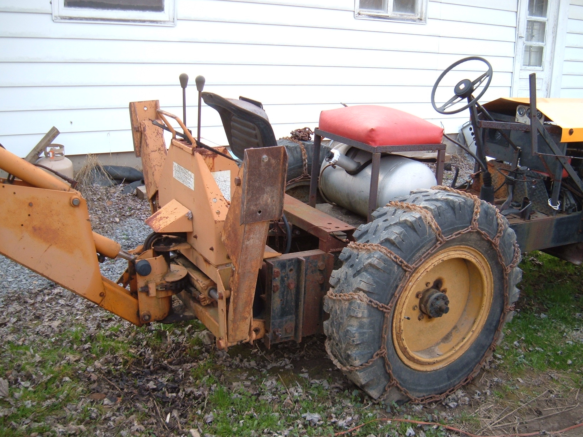

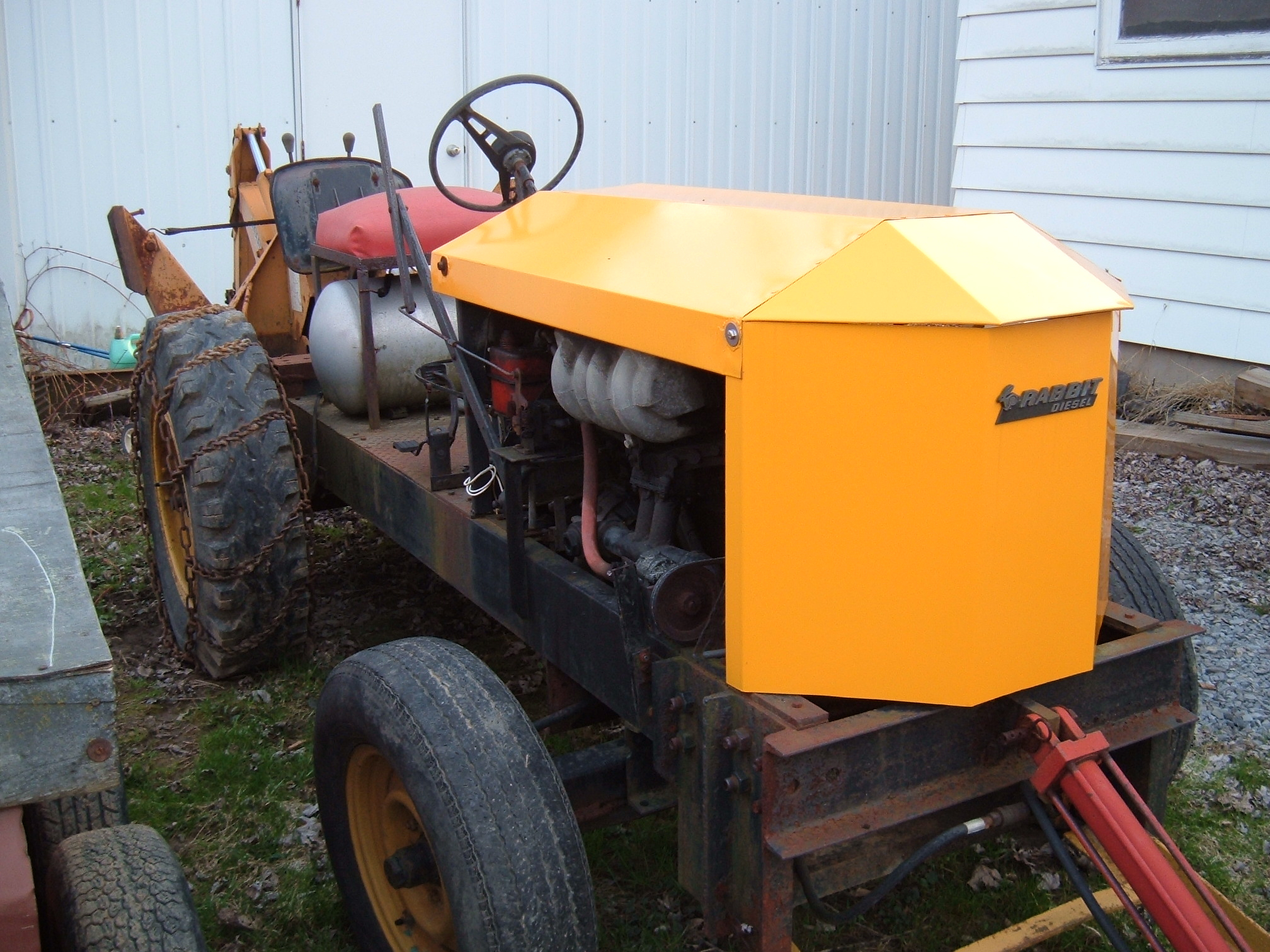

I built a tractor to mount a backhoe attachment. I started with a VW Rabbit engine mounted North/South instead of East/west, a GM 4 speed transmission, a '54 truck front end and a Detroit Locker full floating rear axle. The frame was channel iron. Used it for 20 years with the Diesel engine. Old age took that out, so I switched to a Suzuki three cylinder gas engine. It has power steering, a front dirt blade and a PTO driven backhoe. I didn't think to get the "Brain Box" for the Suzuki, so it has a VW bug carb and a GM electronic modual and a Suzuki coil.
