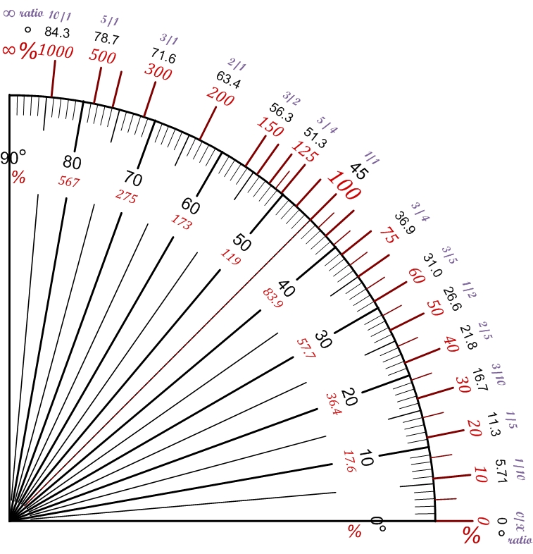

Moved to some new property in GA and about 10 acres of the property is choked up with what we call around here "wait a minute vines" which is basically a nice way to say you ain't getting through there. I was thinking about getting a little tiny mini excavator and clearing some of the vines and doing some selected removal of a lot of the small pine trees that appear to be working on growing among the more desirable species. Only problem is the terrain is steep drainage and I know I can't get some of it but a lot of what I'm thinking about attacking is 10-15% grade. Could a mini-ex safely operate in there without having to tear up the ground too much building working pads etc? Specifically I'm looking at renting a Kubota k-008 or kx-18 size mini-ex.

You should be able to negotiate a 15% grade with your tractor. If it has a loader and you have a bush hog type mower I would attack the vines and small trees with that first. A mini EX is more tipsy than a tractor IMO. Great care and remembering to keep the grader blade low would be needed on any decent slope.
If you are talking a 15 degree slope that is a different animal but should be able to approach in forward or reverse.

15% is only 8 degrees and should be easily negotiable by the excavator as long as you keep the tracks perpendicular to the slope. Even 15 degrees should be doable, just don't go along the side slope unless you have the bucket pointed downhill for additional support if you should need it.
