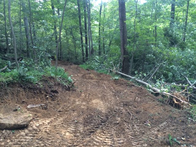

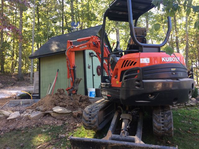

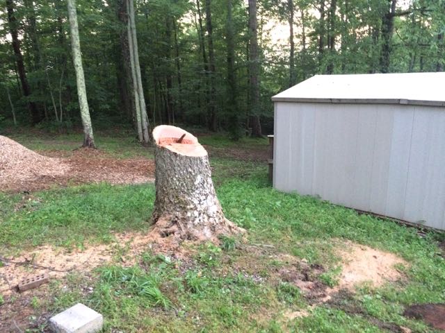

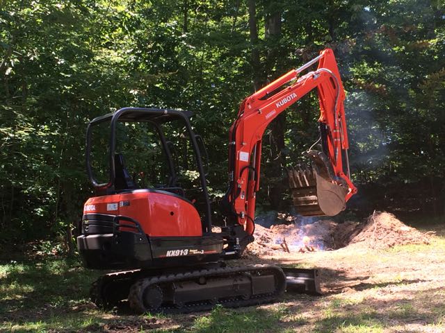

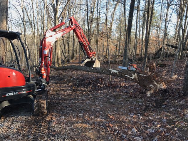

I bought a KX91 this summer and am extremely pleased with it. Been doing some clearing, stumping, etc...
The photos are a small tree I had to cut up
Stump I dug out (that one was big and DEEP and took about 45 or so minutes I believe)
The fire pit I dug (really is about 8'x10x'4'
The others are of a road I built for the ATV (that was about 1:45-2hrs work
The last is a trench for a generator (was a 50' maple there the day before - tree and stump gone but no photos)
