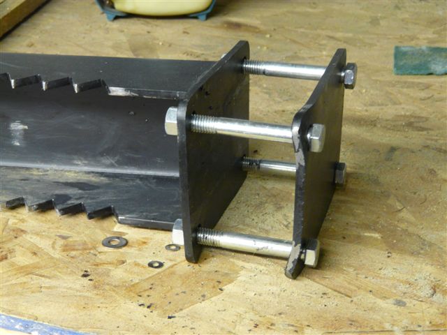

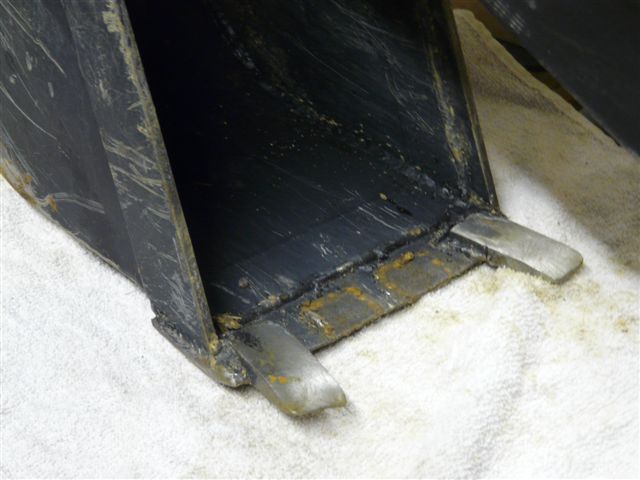

Anyone have any problems with the Mini Hoe teeth breaking off? Granted, digging in NH is not easy. I was helping a neighbor expand their garden by digging up a 10' X 30' X 2' deep area which produce roughly 80 rocks, about 8 in the 2' x 2' x 1' size. (We are not know as the Granite State without good reason.) The mini hoe performed very well and I used the thumb to pick up many of the rocks. However, when I was done, the middle 2 teeth were gone and the 1/4" steel plates on the thumb were bent! I realize I may have been pushing it, but if the mini hoe is strong enough to dig out and lift that size rock, I would think the teeth and thumb should stand up to it also. I guess I am going to have to beef them up. Anyone have any suggestions for replacement teeth?

According to Chris and Terry they try to build everything themselves instead of buying. So they built that bucket in Tazwell. Now knowing a bit about welding, I have been a bit underwhelmed with some of the welds on my PT but nothing has failed. So with all that said, if I were running that shop, welding teeth on a bucket is the kind of job I would put an apprentice on. If I were you I would just clean up the welds and run my own bead over them. As for the thumb bending, I would not worry about it, mine did the same thing. Once it takes the shape of the arm that is all it is going to bend. Hopefully you were able to fine those two teeth!

Those teeth look pretty lame. How about just buying new, heftier ones and welding them on?

A number of years ago, a member built their own thumb, I forgot who it was. Anyway, they abused the living daylights out of it, and ended up just bending the whole square tube that comprises the main 'spine' of the mini-hoe. I am thinking that the 1/4" plates on the PT thumb might be (guessing here) designed to buckle so that you won't pick up things that exceed the lift capacity of the PT?

The problem is, we abuse our machines. We pry on immovable stuff until the rear end comes off the ground, then grab from a different angle and pry some more. The PT, in my opinion, has overpowered hydraulics for its weight. The reliefs do not kick in before the rear comes off the ground and the machine is capable of damaging itself. I don't think it is because of weak implements, although I do think the mini hoe tube does not have a thick enough wall tube to support a thumb. I think if you beef up the thumb and bucket, you may end up kinking the tube.

I believe you are correct; I've but a small, but disturbing dent in the (arm) tube just by accidentally trapping fair sized rocks between the bucket and tube when digging close to the tractor when you can't see the bucket.
That said, though, I'm going to order a thumb anyway. Then I can learn how to replace the tube of the mini-hoe!

I knocked off most of them on my 1430 mini-hoe. Found they are just snips from bucket edge stock. Also happens to be the same material as the blades on my brushcutter, so I just used 1" pieces off of a broken blade. Broke the blade when I hit an boulder. If you do not have the parts for making teeth, I bet they cannot be expensive from PT. Have not damaged any of the ones I welded on yet, but then I have not been quite as aggressive with my rock punching!
