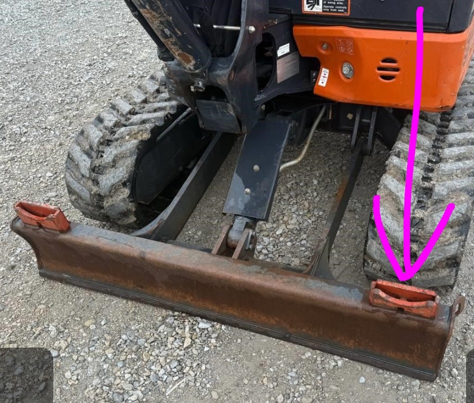

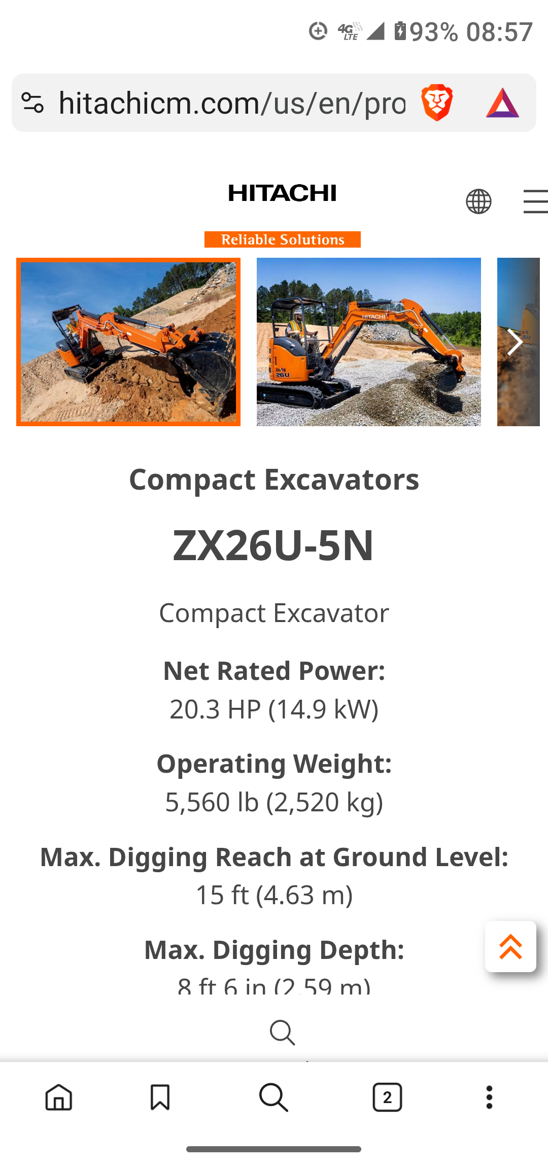

I see this, which seems like a lot more machine , but a bit past my proposed budget ... It looks like Hitachi actually makes the smaller Deere's ... But it's also quite about farther away ... Pushing 450 miles, one way!
/ Thinking about a Mini-X ... ? #49
That's a nice machine 1350 hours and a decent price. It looks good and clean too. 12" tracks, and 5400 lbs its a size you can do some work with. Richie specs https://www.ritchiespecs.com/model/hitachi-zx26u-5-mini-excavator
The only drawback is a 12" bucket - good for trenching but at that price you can add another one.
