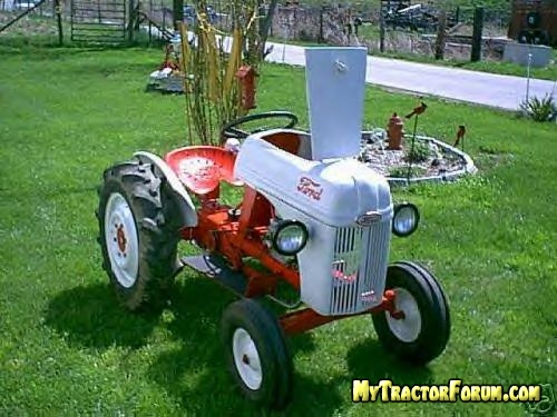

OK, this is what's next. I am building a Mini-Me 8N for my wife. I am starting with a old Power Pup DIY from plans in August 1961 Science & Mechanics I am taking out the 12 -14 HP Craftsman engine rope pull (boy does that thing kick, too old for that, need electric start), replacing it with Honda 23 HP (Father's Day gift from my wife and dog), adding an Awesome Henry 8N garden Tractor kit and 7.00 x 16 Ag tires on Ford 16" 5 x 5-1/2" rims. It has an I-Beam frame, Model A Trannie and Model A nNarrowed rear end.
Currently:
Goal is sort of like this:

Problem - Model A Rearend - sometimes when I back it up, rear axle locks up. I roll it forward a few times and it frees up. What should I be looking for?
   / Mini-Me 8N project (Follow-up to Frank-N-Ford) #3
This is a complete shot in the dark as I know exactly zip about Model A rearends, but it sounds like a worn bearing/bushing is allowing the pinion to move and it's locking against the ring gear. I'd look closely at the input shaft and pinion gear.
