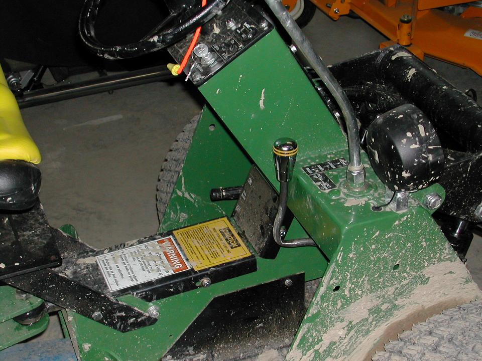

Barryh said:
My light modification to brighter halogens, placed at the top of the ROP’s angled down ward.
I just replaced the standard 25 watt tungsten head lamps with 55 watt halogens (Northern Number 18814). They were less than $10 for two. I am amazed at the difference.
I had cleared out a ditch a couple of weeks ago at night and was disappointed in the amout of light from the head lights. I changed to these and what a difference. They have roughly 4 times the light output of the standard bulbs. I had previously moved them to underneath the ROPs and these two changes combined give me as much light as automotive headlights (as least from the numbers). The automotive may have better reflectors.
/ Mini Modification #50
Mine are also 55 watt halogens. I'm sure they put a drain on the battery, but to me it's worth it. I go back into the woods at night every once in a while. It's nice to see everything bright and lit up.
55 Watts is a little less than 5 amps. The alternator is rated at 15. So two lights plus the fan (which is 5 amps and you don't have one) gives about 15 amps. If you use a trickle charger while parked it does not matter too much if you run the battery down a little while operating. I actually have a switch on each front lamp so I can run just one if that's all I need. I have a flashing light in the back, but I have not measured its current. I only use it when on or near the road.
The extra light is a big help and you probably only run them a few times a month, so no big deal.
/ Mini Modification #52
The 180 does have a cooling fan in the back, not on top of the unit. I only run the lights once in a while, there so bright I can see in back of me. I haven’t needed to add a backup light. I have a trickle charger, but haven't felt the need to use it.
When doing a lot of moving snow at night. I will be hooking up the charger. I didn't think to put in separate switches, good idea. I plan to do the cigarette lighter thing for other accessories. I’m sure I'll be using the trickle charger a little more after that.
