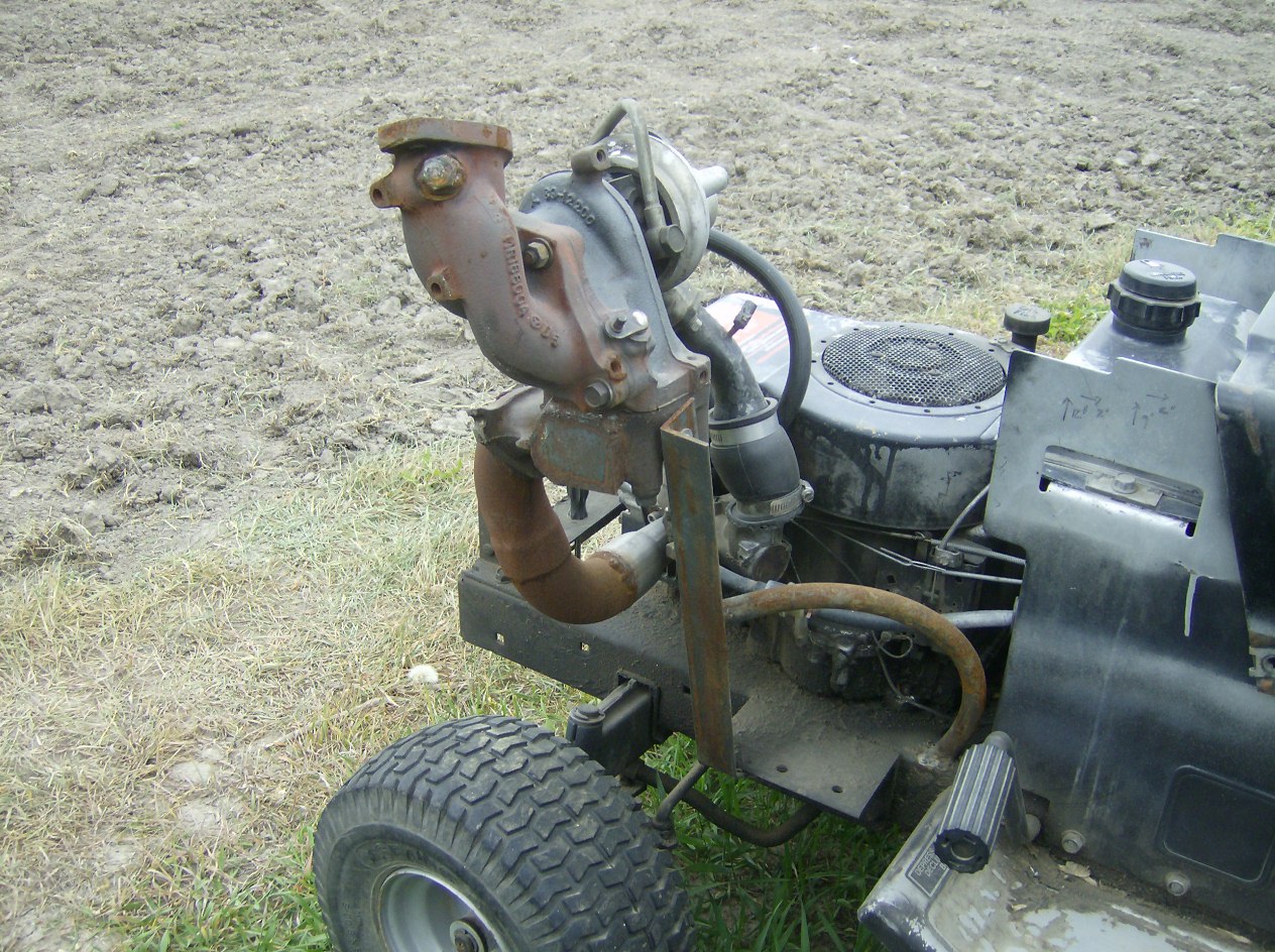

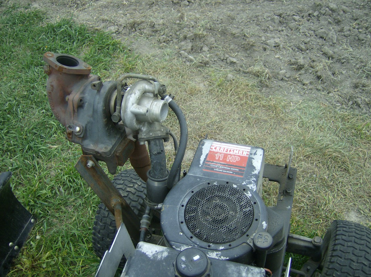

I have a Craftsman mower with a turbo out of a mazda engine. I didn't build it, and I've never started it, but I have it. I got it in with a bunch of parts from a guy in another state. He said he could plow snow at about 30 MPH with it. I'll have to take some pics tomorrow when it's light. I sure looks silly.
/ Mini Turbo #9
Here are a few pictures of the Turbo charger on the mower engine. It's goofy looking if you ask me, but it's still kind of cool.

And you've never driven the turbo'd Craftsman? I'd have made it top priority...... just out of curiousity ! :)
/ Mini Turbo #11
Interesting.
A guy on another forum had something similar. Said it didnt add any power, but it sure sounded cool:cool:
/ Mini Turbo #12
I'm pretty curious, but I've never driven a turbo'd anything. I got the impression from the guy that I bought it from that it may be a process to get it started and running. I'm trying to find a time when I can spend some time playing with it.
