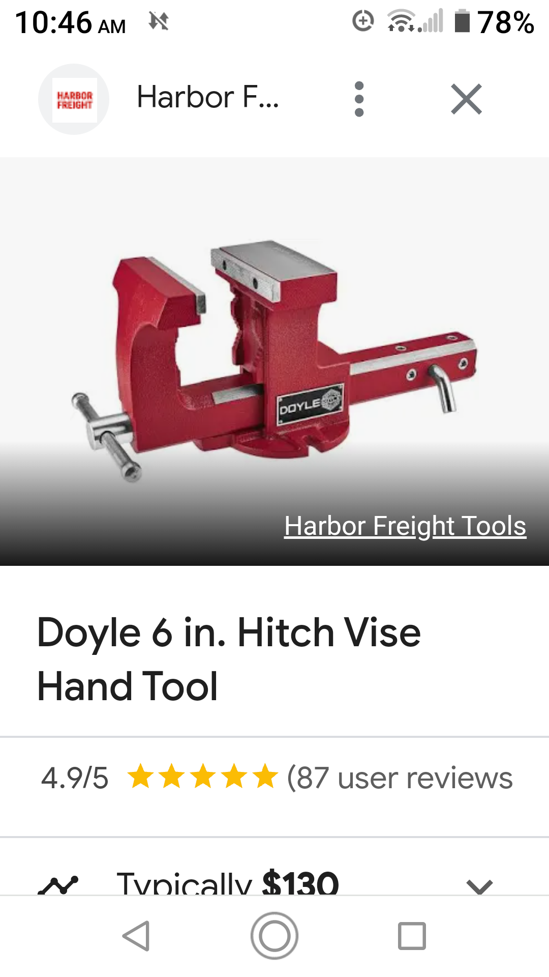

Harbor Freight is supposed to have a cheap welding fixture table.
Ok, so it looks a little flimsy, but it might be worth considering,

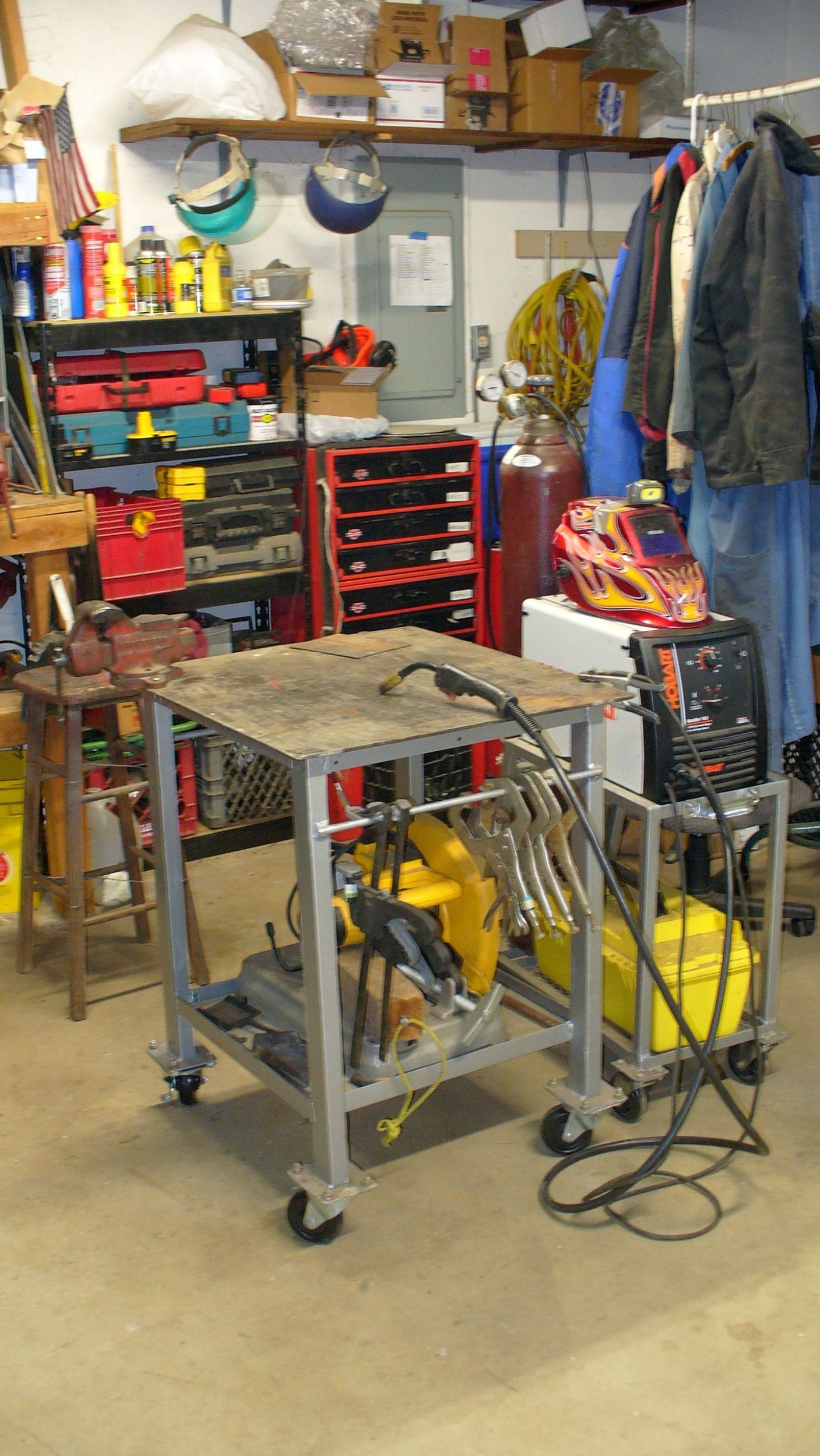

I made this rig pretty fast, and I am very happy with it.
It's a sold vice stand, that also holds a welding table.
I have some smaller clamp on vices to use on the welding table as needed.
I also added some steel casters to lean it back on, so I can move it around easier. And, it takes up very little space.

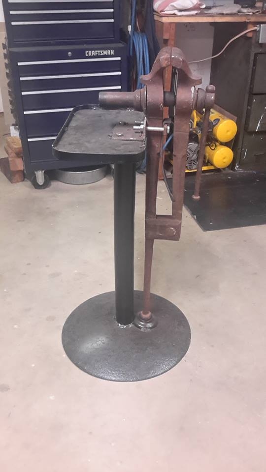

This is my free standing vise.... Actually Blacksmith leg vise...
Those are great. I have a similar leg vise, barely visible behind the work light in my photo above.
