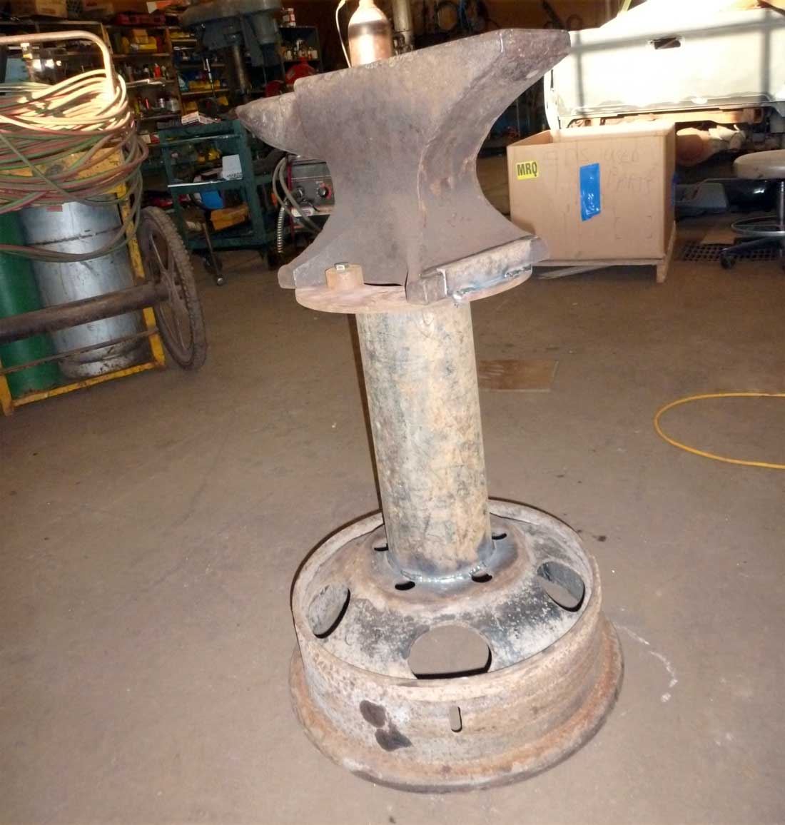

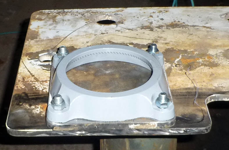

Here is photos. Top photo is a 1/2" plate we picked up today. I thought the holes might come in handy. 2nd photo is the old, old split truck rim a cleaned up and painted. (Note, I don't yet have a vice so I know where to put the 2" receiver section in the top)

One problem with bolting a vice to a welding tabletop like I suggested is weld spatter may (will?) find its way into threads left open.
I would think with an adequate coating of lube on the acme screw it would be a non-issue.
I have a bench vise with a shielded acme on 3 sides like this one (not mine) that negates the issue altogether:

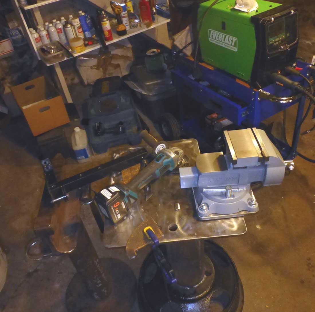

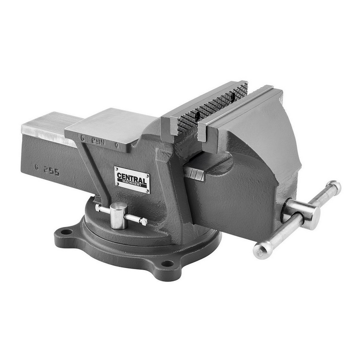

Didn't get any work done but did pick up a vice today. I didn't like the one I was looking at on-line and got a slightly heaver one at HF today. Where you see it in the pics is close to where it will be mounted.
/ mini welding table #49
Looks good! Move it forward a little, so a flat object in the jaw can go down past the edge of the table.
Just my own taste but a welding table, plus a vise on a separate grinder stand, is what I find practical.
#50
Ya, the vice was so heavy, it was going to roll the whole thing over so it was just there for looks.
/ mini welding table #51
I looked at that vise today at HF. Man they have a heck of a selection over there.

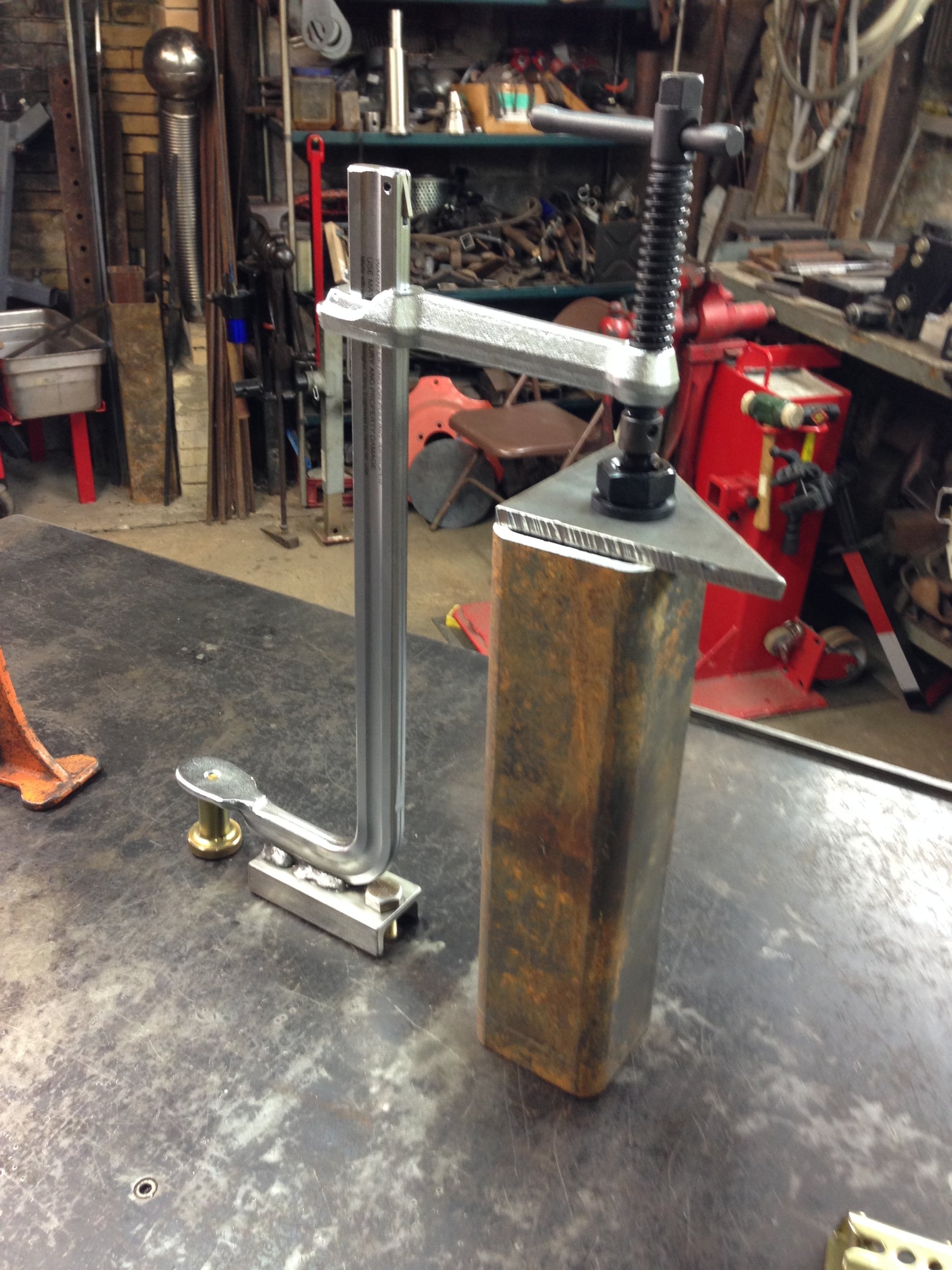

Most used welding table clamp is a modified bar clamp that uses a 5/8” bolt to table top. Can be used as regular clamp or spreader still. Secures 4” machinists vise horizontally or vertically to the table as needed. Good ground thru the table.
Many attachments for holding options.

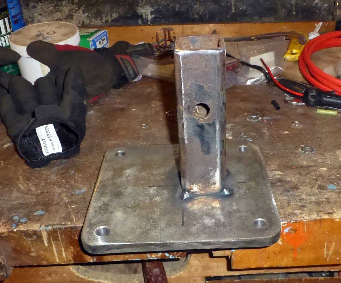

OK, here is one with Mr vice attached. What you can not see is the square tube for the vice plate is mounted 2" off of center. It that called non-concentric? What-ever-the-case, you can reverse it and the vice will then be over the edge by 2".
