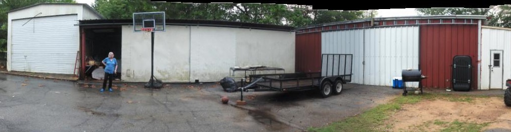

I went from a 15x15 workshop in my basement in Virginia to 4 shops covering 5,500 sq feet.
attachment.php
And it's only taken me 4.5 years to fill it up.

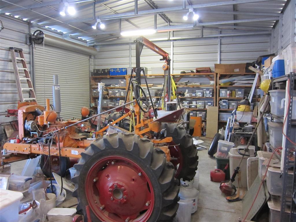

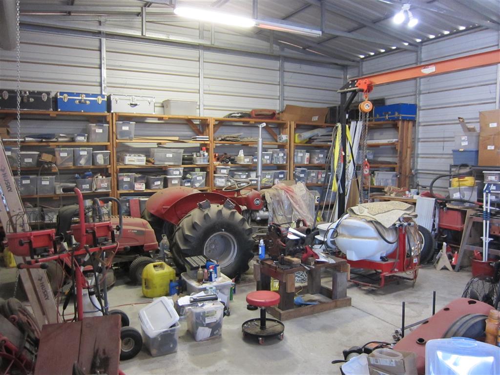

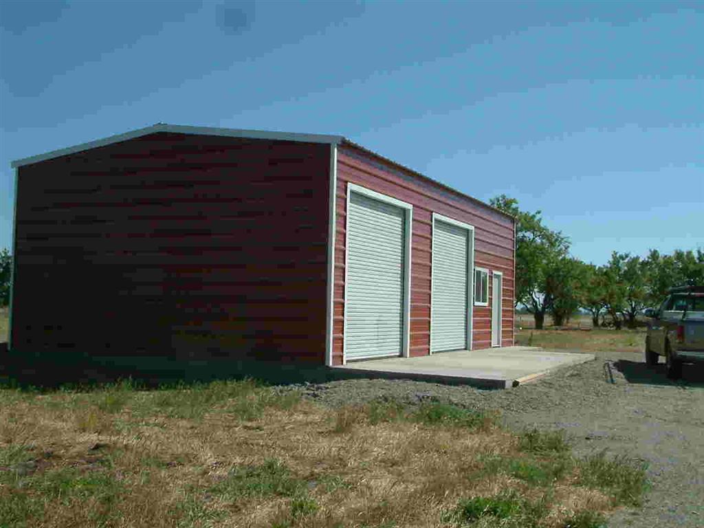

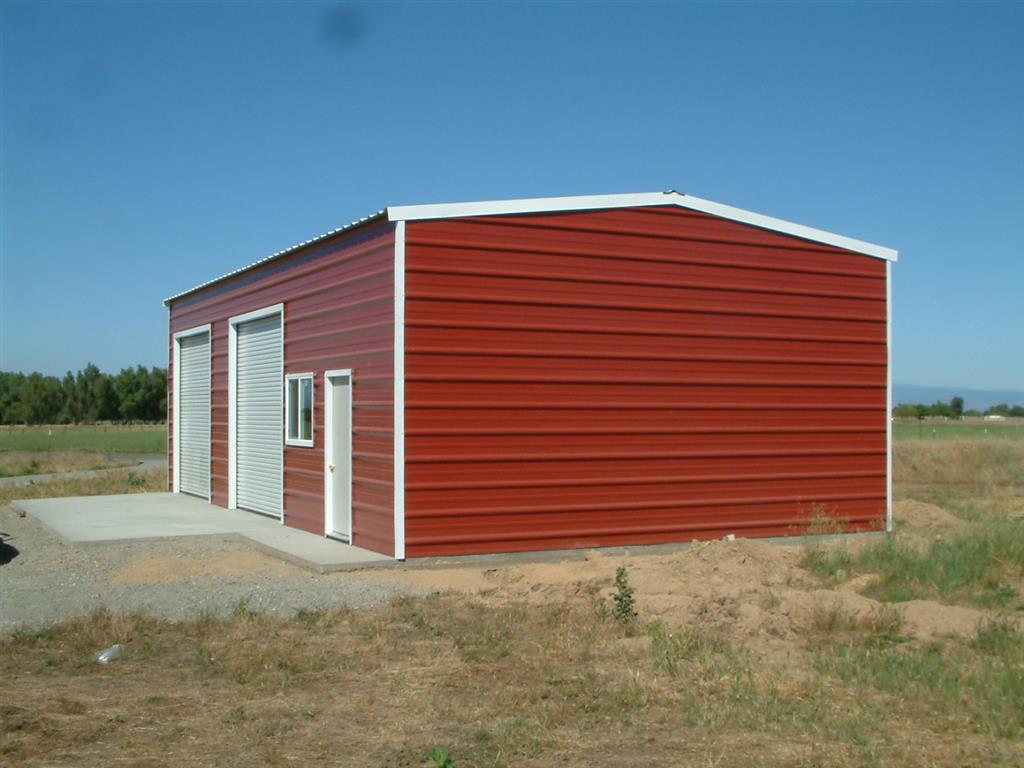

My 2-bay shop was 24 x 42 ft metal building, 12 ft walls, two 10x10 ft rollup doors, 1 man door, 1 window. Concrete floor 6" thick, 4000 psi concrete, #4 rebar on 18" centers. Building cost $16K, floor $7K. Built in June 2005.
Good luck
