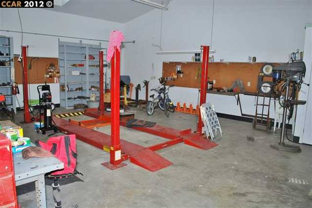

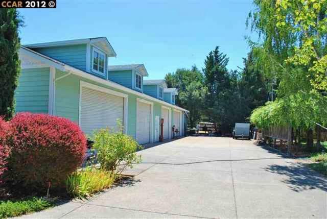

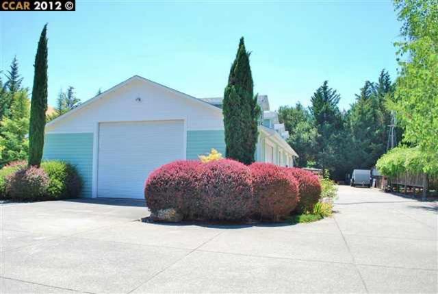

Well... another retired friend has a beautiful shop I will do my best to describe.
It measures 40w x 96 and is like having 4 22 x 40dp garages side by side... each has a large roll up insulated door with the last bay having the life, potty and work bench... the first 3 bays are for the finished cars and future projects.
40 x 96 side palomares shop.jpg40 x 96 gable palomares shop.jpg20 x 96 palomare inside.jpg

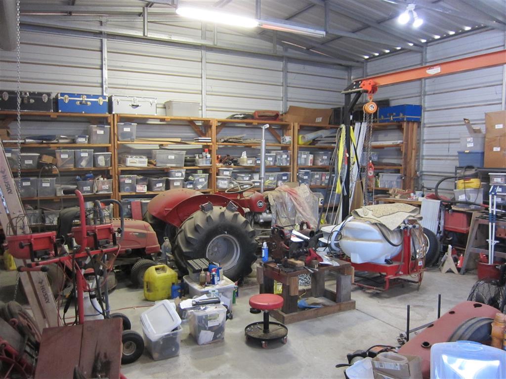

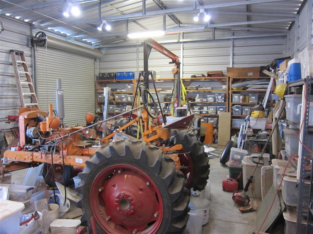

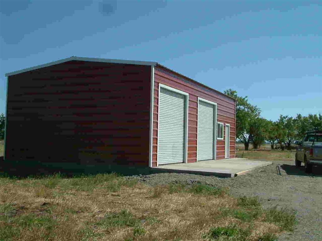

My 2-bay shop was 24 x 42 ft metal building, 12 ft walls, two 10x10 ft rollup doors, 1 man door, 1 window. Concrete floor 6" thick, 4000 psi concrete, #4 rebar on 18" centers. Building cost $16K, floor $7K. Built in June 2005.
Good luck
