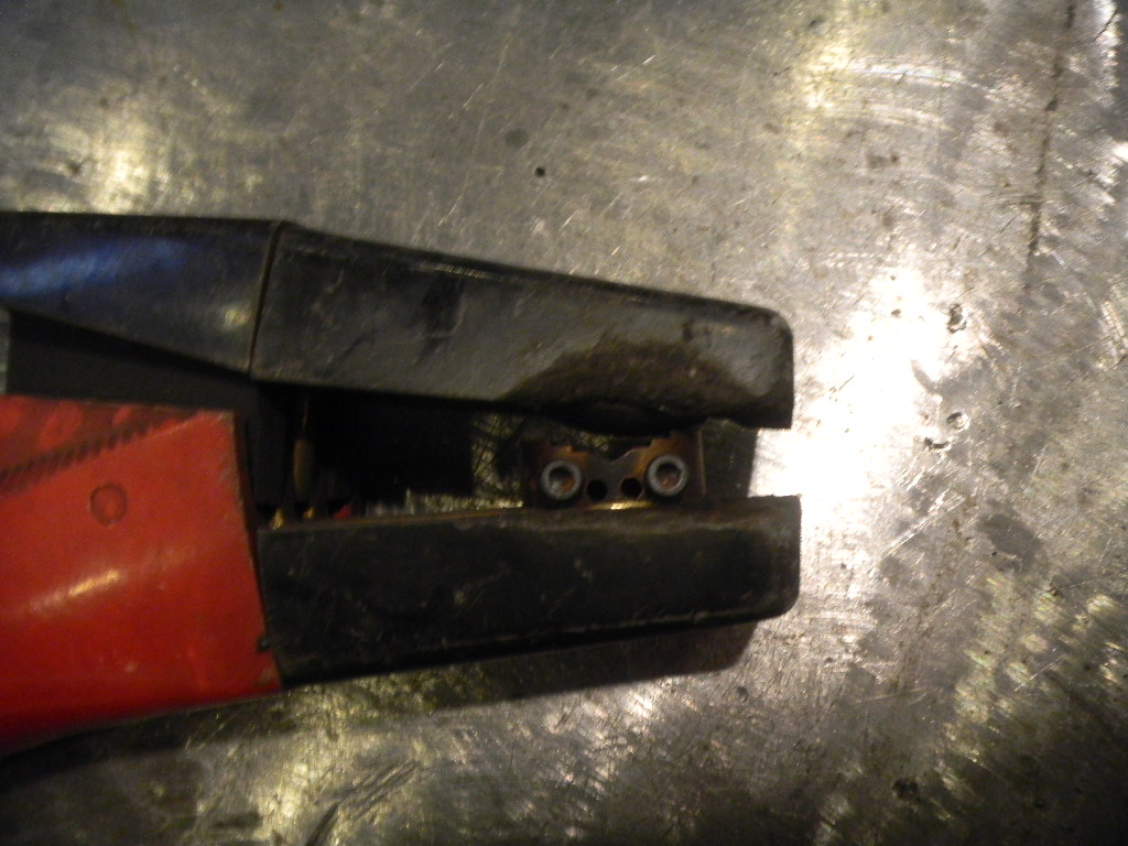

   / Minimum Amps for Air Arc Gouging #17
I somewhat agree with all here. I have the smaller ArcAir K2000 that I use every once and awhile with my small welder at home My welder is a Lincoln Square wave 175 tig. The K2000 uses much less air than the standard K4000 and can be used on a smaller compressor, 2 air ports in the K2000 where there are 4 in the K4000. Think it runs on 6 cfm @50 lbs. That said, you still need the amps or smaller electrodes. I run 5/32" and can get about 3-4" of cut before I'll stop and let both rigs cool off for half hour or more. Air arc can be hard on a welder this small, and I'll only resort to this for some reason like restricted access stops me from using a grinder. This is the only reason I'd like to have a older engine driven welder sitting around here. ArcAir starts working better @250 amps+, and much better the more amps you can pour into it with larger electrodes.
Chris
   / Minimum Amps for Air Arc Gouging #18
My days of hogging out iron are long gone! I plugged two of the holes up in my carbon arc torch.

   / Minimum Amps for Air Arc Gouging #19
Think the K4000 has larger dia. holes as well. If I had a K4000 I'd plug off a couple as well. Being retired, never in a hurry, not enough amps to run one to it's full potential, a K2000 is plenty. Smaller ones are sure harder to come by than the larger ones. One thing that should have been mentioned above is the " duty cycle " on any small welder that runs a arcair should be cut in half. Example, if you have a 20% duty cycle at full amps, cut that in half to
10%. Arcair on a small welder will toast it fast if you exceed that, it just isn't made for that type of a load. Still have the burn scars from running the big ones.
Chris

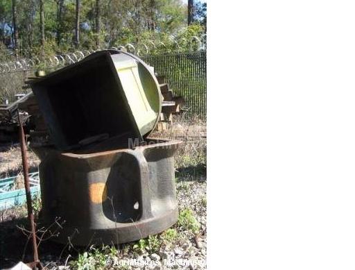

   / Minimum Amps for Air Arc Gouging #20
One time I got elected to arc out some spacer bars in an 18-inch x 18-inch x 16-inch deep steel box. Only one side open. Talk about eating sparks for a couple hours:eek:.
The box looked just like this one in the picture.
