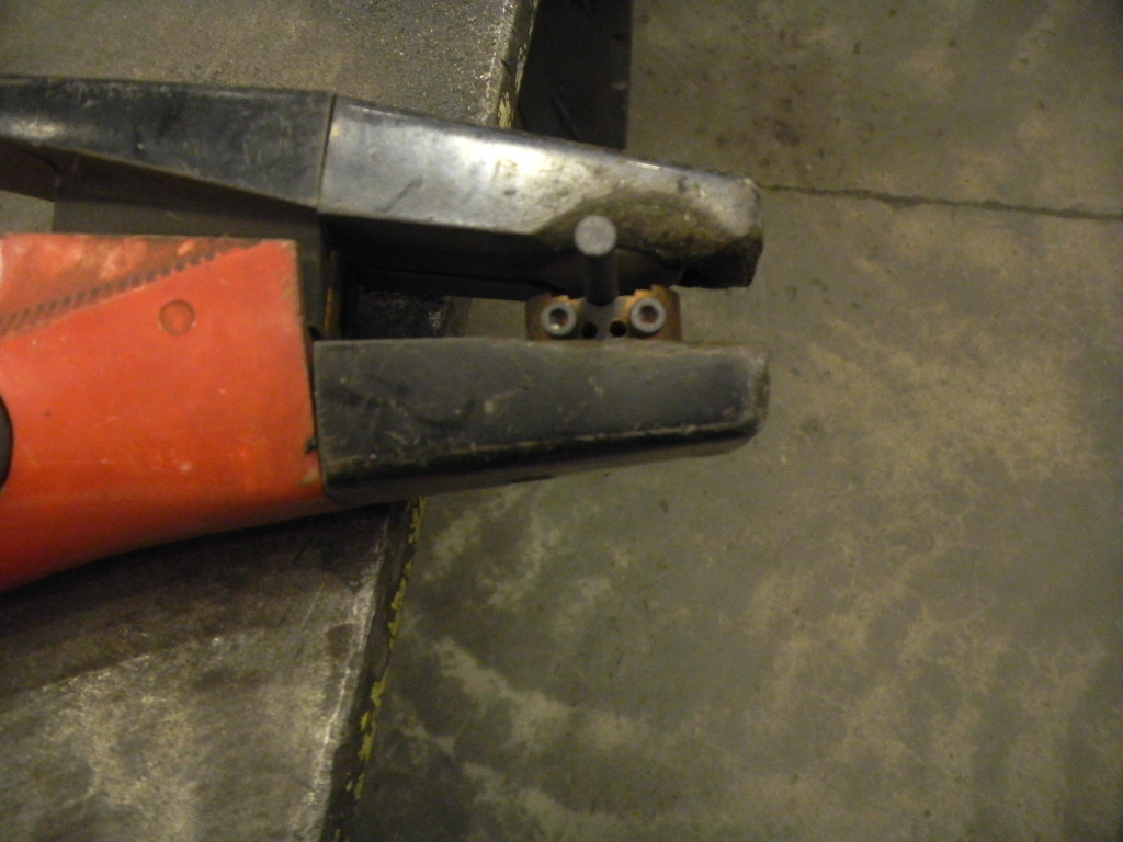

Shield Arc, what was the reason for plugging 2 holes on your K4000, not enough air? How did it affect the gouging?
   / Minimum Amps for Air Arc Gouging #22
Yes not enough air at home. It works fine with the smaller rods. This picture is with a 3/16-inch rod, that is the biggest I have on hand. I haven't tried it with the new 7 1/2-HP, 25.8 CFM compressor. When using my old 5-HP compressor and the Trailblazer 55D, I had plenty of power, but not enough air. I could only use about a 2 to 3-inch stickout:rolleyes:. On the job we always seem to have at least 185 compressors, you could run 5 or 6-inch stickout with that much air.:cool:
