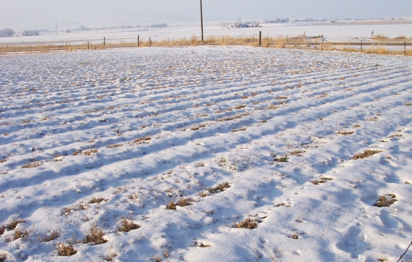

I should add a couple details... I have an additional four or so acres of smoother pasture that I have been mowing with an *old* JD R72. (yeah, it takes a while) I didn't mention it because I figured anything that would do the rough pasture would do the smooth also, but there are a lot of enclosed areas and obstacles. That would be dealt with much more efficiently with an under mount mower, wouldn't it? Is the general consensus that ANY under mount mower is inadequate for a rough pasture? Maybe I should try to post a picture of it. Rough is a relative term.
So if I go with an old Ford or MF, how do know whether I am getting a solid machine or a dog that is past it's expiration date? I am not tied to a budget other than common sense. As was mentioned earlier, having someone mow it a couple times a year is too cheap, simple, and easy not to consider. (it's just not as fun) There is some number above which a tractor would cost more than the work is worth. I am not opposed to spending more, but it needs to be accounted for in the "toy" column and not the tool column. Part of my problem is figuring out what that number is...

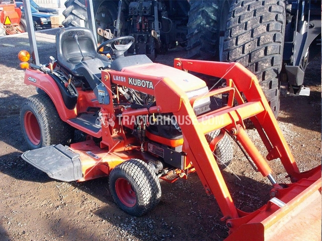

Would this size tractor (for example) be adequate for this pasture? (this one is $7,500, but I am not so much concerned with whether it's a good deal but whether it's enough machine)
   / Minimum $$ investment to mow 3 ac of pasture #28
I have a six year old Kubota B7510 with FEL that I would take $7,000 for. 800 hours on the meter. I can pickup a used 4 ft shredder for $300. Just saying that if I was of a mind to sell that is what I would be asking. The 7510 has 21 hp, 17 hp PTO. Just saying if I was of a mind to sell this is what i would ask.

As many have suggested, a Ford 2000, 3000, or 2600, 3600 would be my pick. The 2x series will handle a 5' bushhog and the 3x will easily handle a 6'. If the ground is smooth enough, a 6' finish mower will cut closer, (more like a lawn mower) but it can't handle small trees and bushes like the bushhog.

Ok you have got 4 smooth acres with enclosures and obstacles that could be problematic with a 3 pt mounted mower and 3 acres of rough that would be problematic for a mid mount mower. I do prefer the mid mount for areas with trees and obstacles as it operates more like a lawn tractor. While the mid mount *may* mow the rough you could prematurely lessen the life of the implement by using it in such rough areas. *Ideally* a B series of say around 30 hp with a mid mount with a detachable FEL would be a nice solution to the smooth 4 acre area. Then switch off to a 3 pt for the 3 acre rough area. Try to look down the road at future projects and buy something that will do those. It is going to be more expensive to go larger later than to just buy more (not too much) now. I went through that last year.
