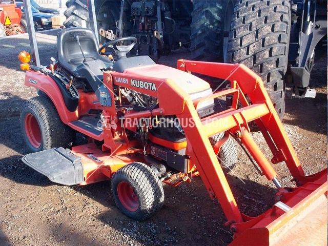

Would this size tractor (for example) be adequate for this pasture? (this one is $7,500, but I am not so much concerned with whether it's a good deal but whether it's enough machine)
I think that Kubota would be a poor choice for the field in the picture. Not enough ground clearance, get something with taller wheels, gear would be fine since it is open field mowing. Something like a Deere 790 comes to mind or similar Kubota, Massey or Ford. I mention the Deere 790 only because I am familiar with Deere models more than the other brands, these were cheap and simple tractors.

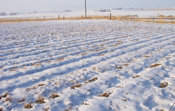

That field looks like it was potato rows that never got reworked and just grew back with wild grass . You might have a problem getting any one to cut that , I'd want to rip that up and level it .
   / Minimum $$ investment to mow 3 ac of pasture #35
I was wondering about that too.
If it were to be smoothed with a land plane then the Kubota would work. I have never been a fan of flooding fields as it seems to be a waste of alot of water. I would say I am not familiar enough with the climate in this locale to pass judgement but it is very likely the OP could smooth this up and mow afterwards with just about anything.
   / Minimum $$ investment to mow 3 ac of pasture #36
That it what I was going to say. No need to beat a tractor or operator to death running over that.

I like the idea of smoothing out the pasture, but it is flood irrigated via gated pipe, so that isn't an option, correct?
I should add a couple details... I have an additional four or so acres of smoother pasture that I have been mowing with an *old* JD R72. (yeah, it takes a while) I didn't mention it because I figured anything that would do the rough pasture would do the smooth also, but there are a lot of enclosed areas and obstacles. That would be dealt with much more efficiently with an under mount mower, wouldn't it? Is the general consensus that ANY under mount mower is inadequate for a rough pasture? Maybe I should try to post a picture of it. Rough is a relative term.

Those are funny comments on the hay field! I am fairly sure it's supposed to be like that, and it doesn't look different than my neighbors. In fact, the previous owner mentioned he had it re-corrugated last year when we were walking around the place. My wife was reading your posts and said "YES!!" when she saw the idea of smoothing it out. Again, though, I don't know how that could work given the ditch irrigation. If any irrigation experts have an idea...
