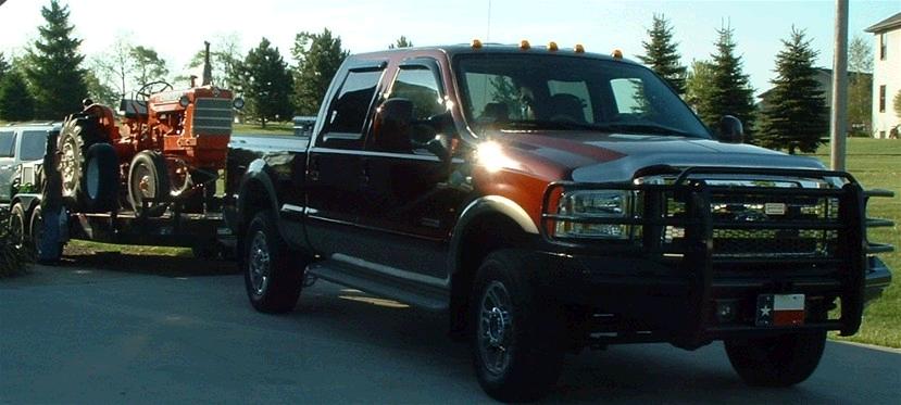

</font><font color="blue" class="small">( What size truck do you guys use to tow a 10K trailer? One of the things that has been stopping me from buying one is the question of will my truck handle it? I have a 1995 K2500 "light-duty" (6 lug wheels) 3/4 ton, 4WD, Chevy pickup. )</font>
For my 10,000 GVW trailer I use an F350 with the new Tow-Command braking system. It is better too go big on the truck rather than too small. I have had to make an emergancy stop going from 55 mph to zero to avoid an accident and if I had too small of a tow vehicle or in sufficient trailer brakes I may not have escaped serious injury. I'll attached a picture of the set-up I have now.

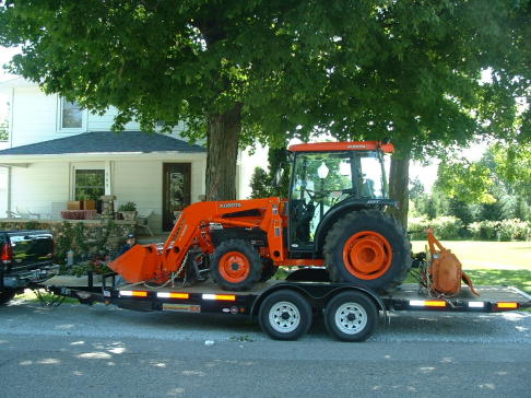

</font><font color="blue" class="small">( If you already have the machine you could measure it.
If not you could go to a dealer and measure it.
You could take my word that I measured mine, L3130 LA723 BH90 and the minimum trailer would be 20' long. )</font>
I agree that 20' would be the shortest you should consider if you have implements. See how my tractor fills a 20' trailer.
