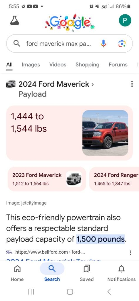

Yeah, but take 250# for an average driver, another 250# for a passenger, their crap, some misc tools, straps, ect, and you are at 1000# in the bed.
You are correct on Tacos, and many of the other small trucks having virtually the same Payload as the 1/2T.
Even the car based Maverick has 1500# Payload, although, if the FWD version, I'd guess that feels funny.
