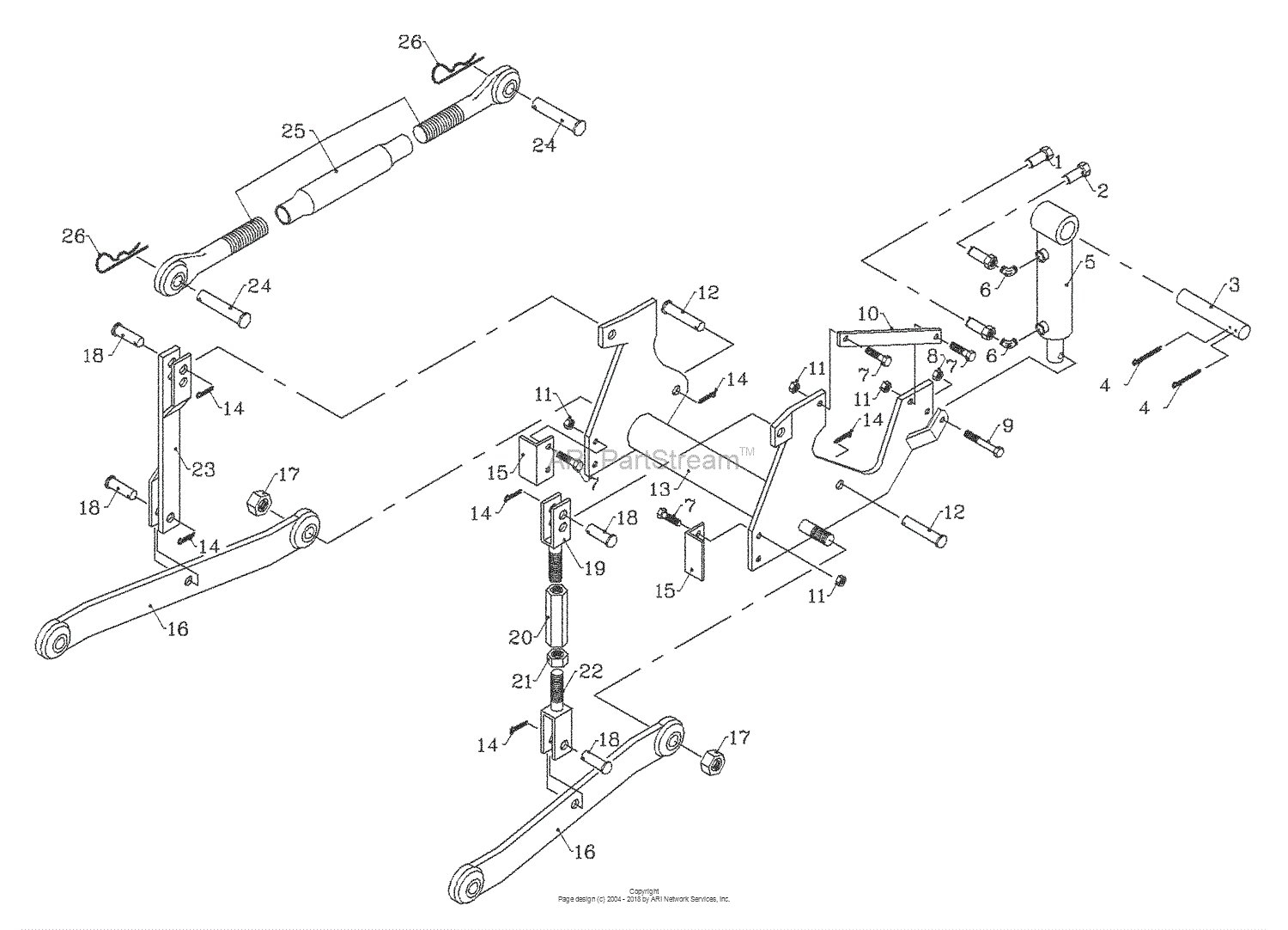

Oh yeah, there is an upper bracket for the three point that is for the two toplink heights.
That one is easy to make or find.
2 months ago, I was able to find it for another Mitsubishi person on another tractor forum. It wasn't too much either.
From out understanding, either another MT model has them or the Kubota was a matchup too.
   / Mitsubishi 1601 three point linkage connections. #12
Link doesnt go to a specific post that shows anything. The kubota uses a different bracket type.
   / Mitsubishi 1601 three point linkage connections. #13
Here are two of the kubota types of lower brackets.
