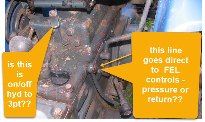

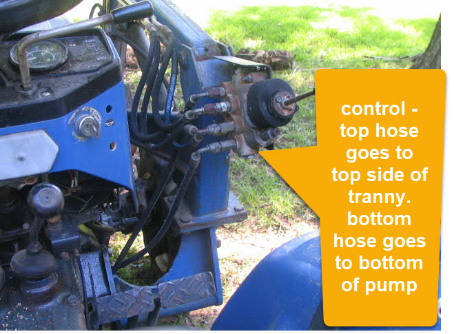

As title sez, I have a Mitsu 1650 with FEL that performs perfectly, but the 3 point wont work.
The control under seat does nothing - I'm thinking thats supposed to control the 3 pt??

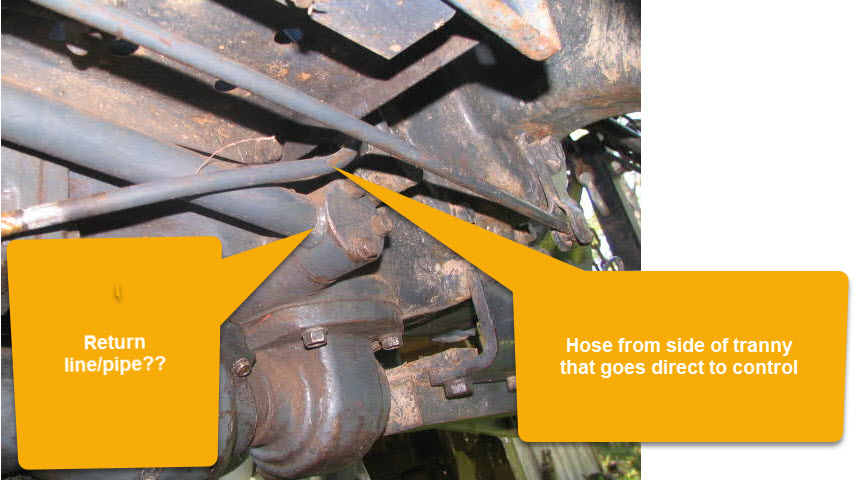

But from what I can determine all the hydraulics are only connected to the FEL - would think there should be a valve to switch from one to other??? On the pump bottom is a small steel line portion conx to hose going to side of tranny - pressure route??. Large pipe coming out of top of pump going to bottom of tranny - return route??
I've had the little guy about 3-4 yrs and have never really needed the 3 pt, but right now I DO need it. I got a box blade with it and PO hooked it up and when I got home unhooked it. Way some time later I needed the 3 pt but couldnt figure out how to do it.
So, should'nt there be a valve to switch between the 2??

Can you show the second image without your left comment?
It looks a lot like they bypassed the hydraulic adapter port and disabled the three point.
On yours I am fairly positive it is on the front flat part under your comment bubble.

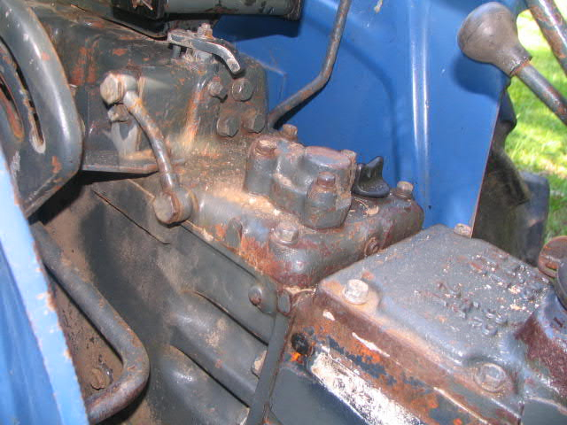

   / Mitsubishi 1650 4x4 with front loader & 3 pt wont work
This is just from the other side, will it do to help explain

Is this adapter available do you know? From Messik or ???

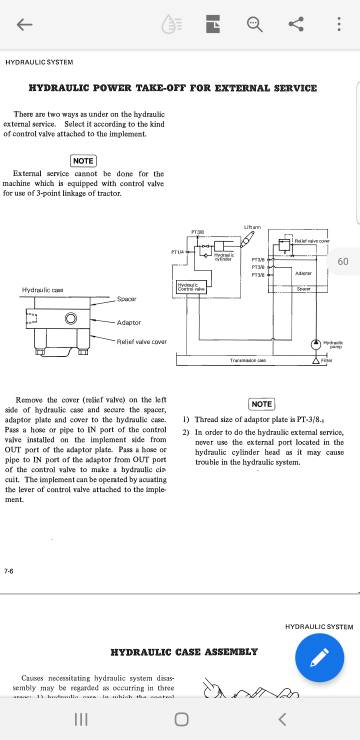

   / Mitsubishi 1650 4x4 with front loader & 3 pt wont work #6
This is the basic configuration (it's out of the MT160-MT180 manual and the port is on the side and not the front, but the premises are the same).
So I would have to have this adapter? Just check the mitsu suppliers and see if there's any available...
Or could I just add a diverter valve....
