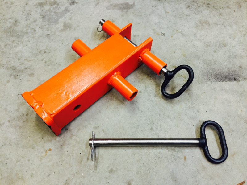

My expertise is definitely not welding... but I think the silver ought to work fine for stainless to copper. Silver is often used as a wear coating on stainless steel (i.e. bolt threads). I recently MIG welded stainless drill rod to mild steel with no problem using mild steel consumables and 75/25 gas... better outcome that I expected. Since it sounds that you aren't needing a highly stressed finished product, this is what I would do.

I made a couple of quick release pins. Bent up some 3/16in mild steel rod and welded to 9/16in stainless drill rod to make quick release pins. Sorry can't see the welds... Already coated the handles with a couple coats of plastic dip. image-1316811219.jpg
