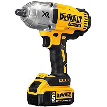

With one of these....

Tried it with my pneumatic to no avail, hence my question about a reverse thread and holding the gearbox while working it. In fairness, my pneumatic impact wrench is old and was inexpensive to begin with, so it may not be hitting the nut hard. I'm picking up a new one on Saturday. I've tried to stick with corded electric and/or air tools. Batteries just have not worked out for me in the long run.

Its not a reverse thread. Just going to have to get creative with locking it down. A second person, or mount it back to the deck and attach the drive shaft back to hold it. May have to heat it up. They usually come right off with the Impact but they are tight.
   / MM60rse Gear box bearings bad #16
Thanks CaptFerd. I got it off with the new impact wrench ("1100 ft/pds of bolt busting torque") and the torch. Four minutes with the torch, then 30 seconds of impact wrench repeated 3x. The pulley didn't want to come along peacefully either, but it's off. The inside of the box looked like the filings from a lathe. At first I thought "why are there springs in here?" Turns out it's just super tightly wound up metal filings. Not enough of the outboard output bearing left to even take in to match up.

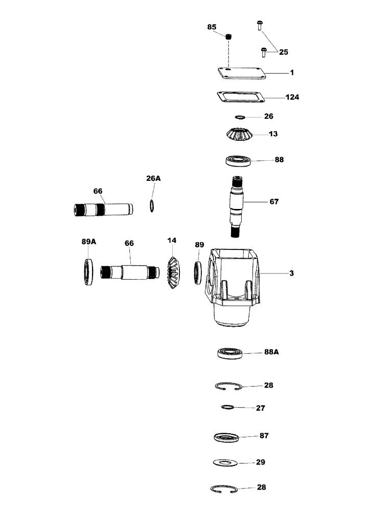

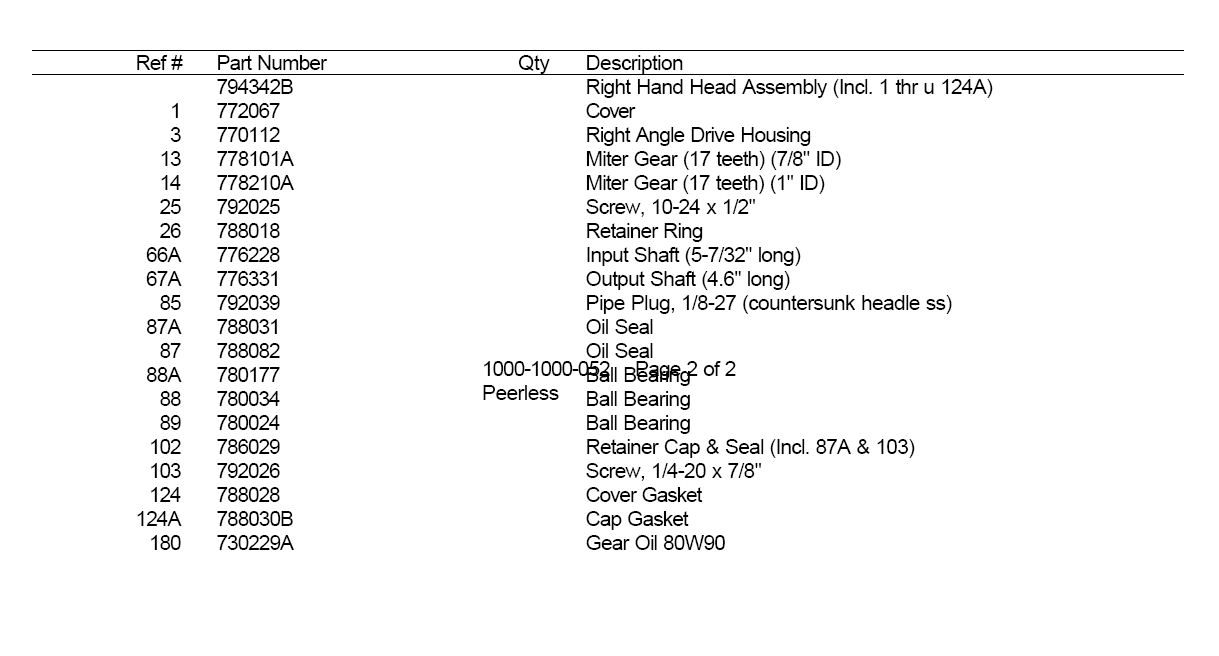

Hi Eevryone, For the sake of posterity and those who will come along later to this thread, attached is the configuration that is on my gearbox. The gearbox itself is made by Peerless, which if you are doing a rebuild is apparently different that Peerless Bearings. My configuration is closer to this: View attachment 525490
Oil seal 87A is an SKF 8648
Oil seal 87 is an SKF 11223
Bearing 88 on the input shaft is an R14 (no seals or shields)
Bearing 89 is an R12 (no seals or shields)
Bearing 88 on the output shaft is not the same as bearing 88 on the input shaft. It is a 6205C3.
Bearing 88A on the output shaft is a 62052RSC3
Total cost of the bearings and seals from the local bearing house was $71, and they are all Koyo and General bearings, and SKF seals. I'm going to guess they are better quality than the originals.
Happy Mowing!

Thanks looks to be the same box. Ive noticed over time that this same box has been used over and over on different applications. I recently restored a 1969 sears garden tractor that uses the same box on its mower deck. It has 2 of them one for each blade. The shafts are different on the outside but everything inside and out are identical. Your info is worth its weight in gold.
