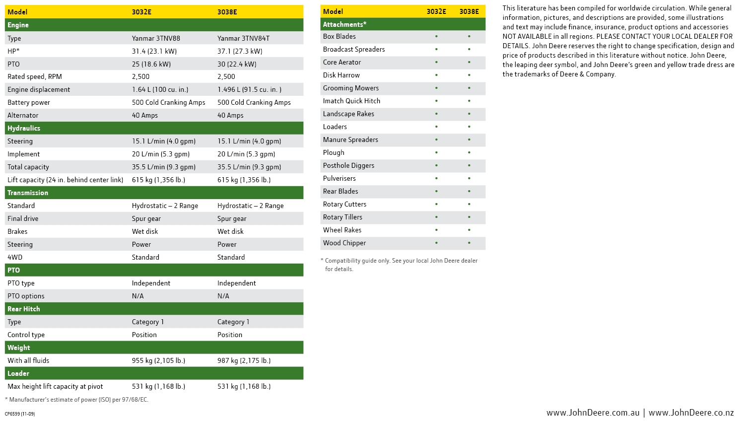

There is no Mid-PTO on that machine, nor is one available. While it may be a great price-it's not the machine he needs if he must have a MMM.

The Australian JD brochure for the 3032E shows no optional PTO, so no MMM available there.

As you guys have said , nothing doing for a MMM.
This is marketed at the NH Boomer and Case competition
for small acerage rear slashing/finishing , even though
those do have PTO for MMM. He's now thinking of a
Boomer with MMM .............. choices , choices :laughing:
