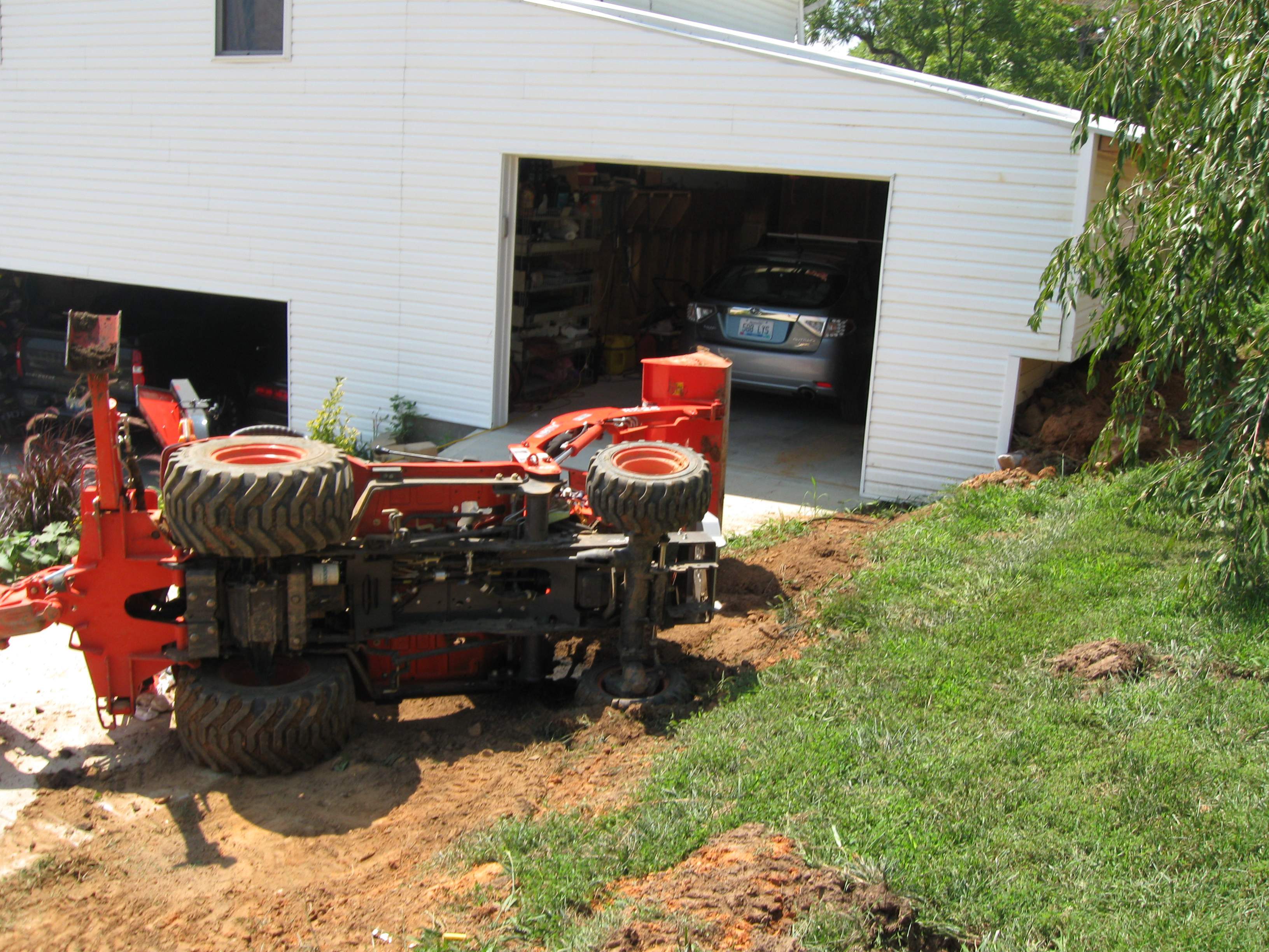

Be careful on slopes and always go up and down and not crossways when possible. Here is another view of a BX25 if your wondering what it looks like from this side.

dragoneggs, I did the same when I first got my BX24, I swung the BH up hill to help counter balance, but I noticed, it has a higher center of gravity with the BH on and I felt better with the BH off when mowing. After you practice how to take it off, it will only take you 10 mins or less to take it off before you mow and that is exactly what I do.

So for significant slopes maybe I want to replace the BH with a lower COG implement or counter balance weights? I don't think I want to fill the tires but I understand that is an option.
   / mmm or rear finish mower for bx25 #20
You will be more stable with the FEL and BH off. Adding fluid to the tires will help with stability and traction but is not necessary. I think the do not recommend fluid in the tires on the BX25.
