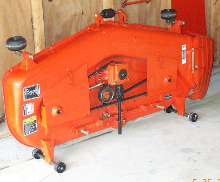

A few weeks ago I saw a photo attached to a post which showed a "Bota MMM standing on its side with 2 sets of 4 tiny casters ganged together like the rear wheels of a commercial aircraft. Each set was mounted to a brass post and placed where the shaft for each rear wheel normally goes on the MMM. The MMM could obviously be rolled to a storage position and location which takes up much less space. I asked my dealer's parts dept. about this. He said they must be aftermarket. I cannot now find the post. Does anyone know in which thread this post is located, where these wheels are available, and how much they cost?
Also, a year or two ago, there was a long thread about freely pivoting casters which could be put on the MMM prior to dropping and disconnecting, so that it could roll in any direction while disattached. If I remember correctly, the discussion was about how to build your own. Does anyone know whether such wheels now exist for retail purchase? If so, where and how much?

Here is a picture of what you are looking for...

Thanks guys, I just ordered the storage wheels. Do you have any info. on freely pivoting casters which allow the MMM to roll in any direction while disattached?

The MMM will fall over if the castors swivel at all because of the high center of gravity and narrow wheel base.
I made my own set up like the photo using a couple short pieces of axel and some 7/8 rod and some cheap wheels. When I do it again I'll use the axel and, basically, a 7/8 OD pipe or a bushing or something.
I am also working on the design of a proper dolly that stores upright, but allow you to move the MMM flat for installation.

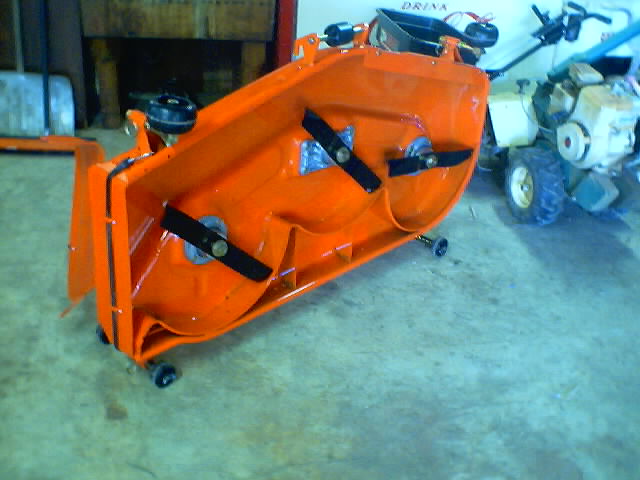

I've got a set of the moweraxles and they work out pretty good for me. The mower takes up much less space and can easily be moved around. Also makes the changing of the blades or fall/winter cleanup of the deck very easy. I use the FEL to lift it for changing out the wheels and it only takes a few minutes.
Volfandt

Vol,
The next thing you need from Larry is his grease fittings on the deck wheels. /forums/images/graemlins/grin.gif
Wow is that deck clean. /forums/images/graemlins/smirk.gif
