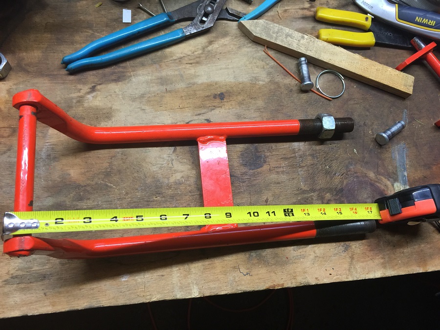

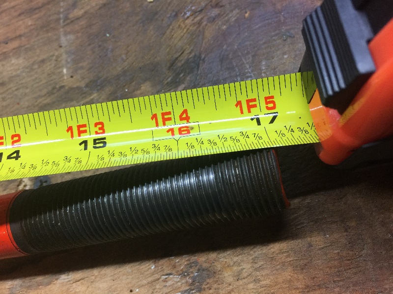

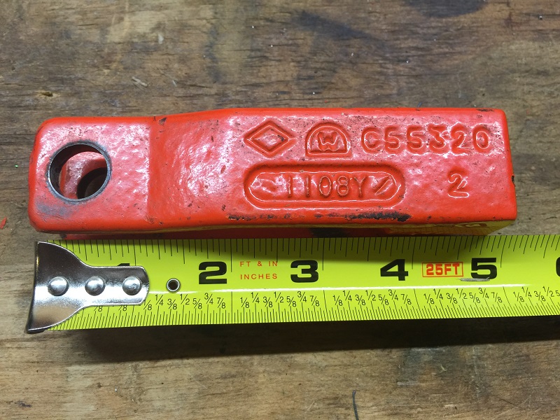

DaveS1108 any chance you can measure the link? I posted pictures of mine it is 17 inch.

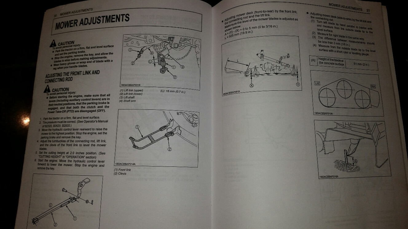

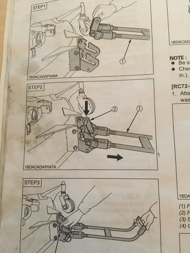

The manual says to do what aczlan says adjust the link if the wheels are off the ground.

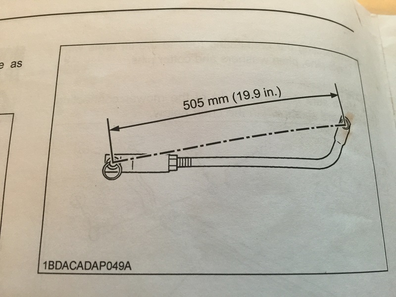

How long is it from the front to the pin in the clevis? The picture of the manual that was posted says that should be 19.9" when adjusted properly (for that particular machine).

My front link is the same length.

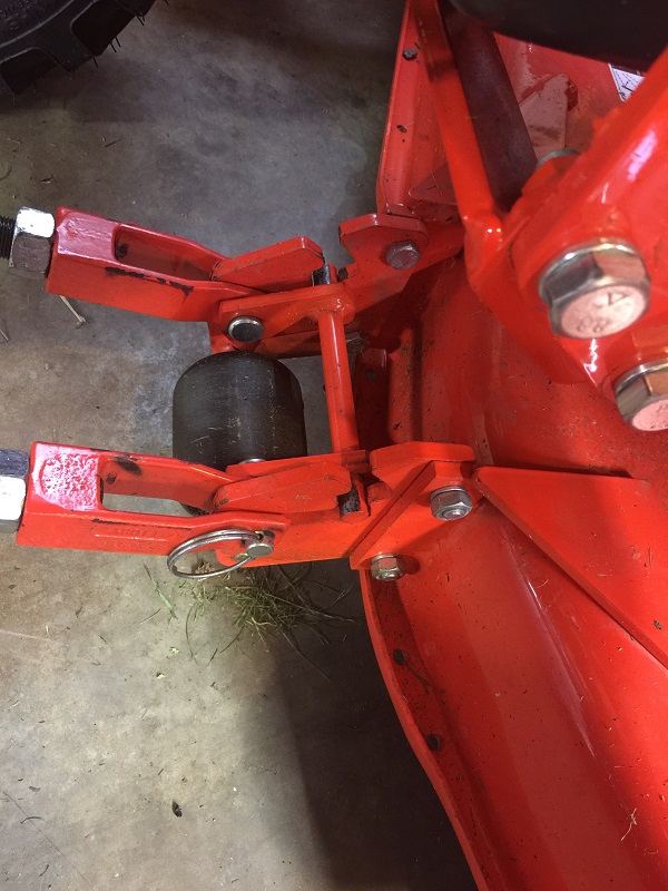

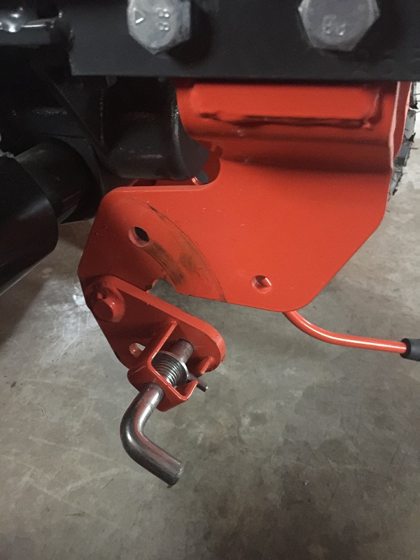

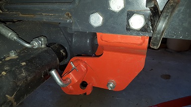

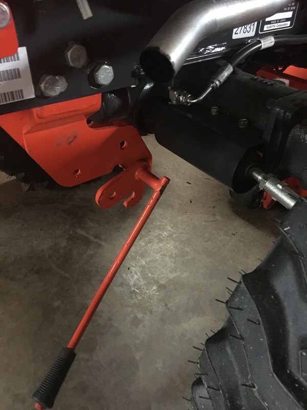

The operators manual page 12 shows what looks like 2 different hangers depending on the deck model. My deck is the RCK60-30BA and uses the hanger that is offset to the back of the the hanger, which I just noticed in the manual is supposed to be for the RCK60-30B. It works for me and I haven't had any issues.
My front hanger handle is on the same side as the exhaust pipe, If your sitting on the tractor it's the left side. Looking on page 12 it looks like the handle is on the other side for the RCK-30B

It looks to me like yours is the one that sticks back further (like it needs to) and they switched the side the handle mounts on. If you look at the BA bracket, the latching pin is in the middle where yours is on the right side of the tractor.
But that's just me looking at pictures from a ways away.

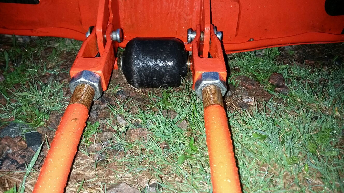

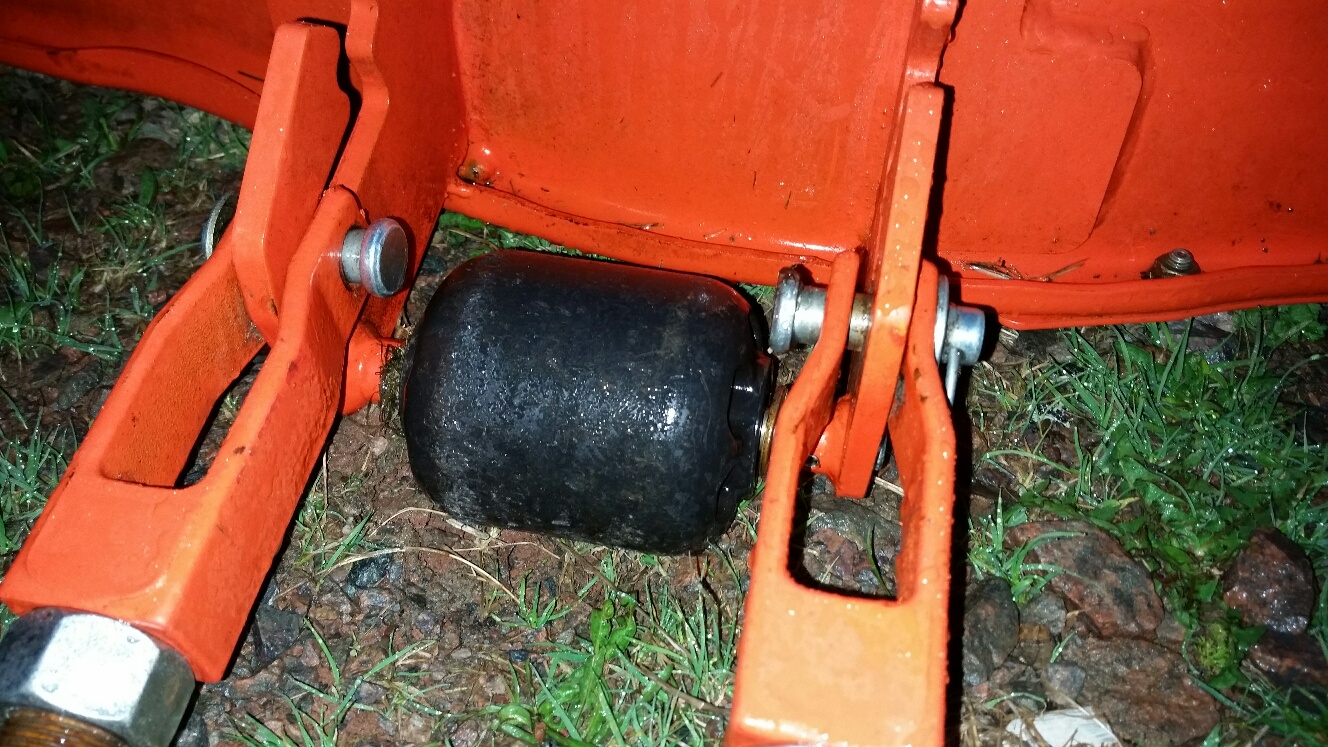

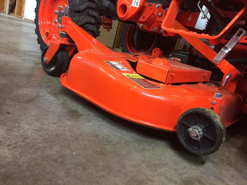

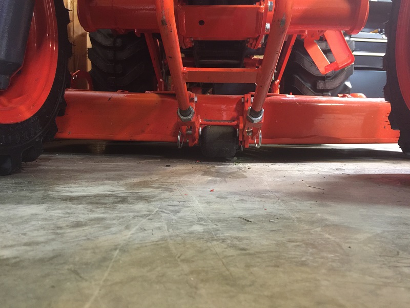

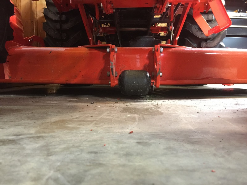

Here is a side view. This is with the hydraulics all the way down and the height i mow at it's a little over 2 and a 1/2 inches. The only wheels that touch the ground are the front two pivot ones and the rear center tires.
middle wheel with hydraulics all the way down linkage not hooked up.

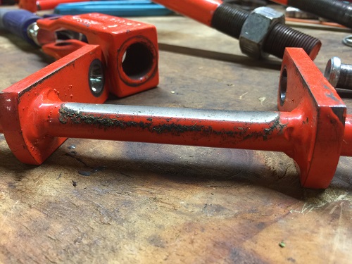

here's the bar that has been hitting the center wheel with the way the dealer had it installed.
What the manual says.

Here is a side view. This is with the hydraulics all the way down and the height i mow at it's a little over 2 and a 1/2 inches. The only wheels that touch the ground are the front to pivot ones and the rear center tires.
Can you post this view with the front linkage hooked up?
Aaron Z

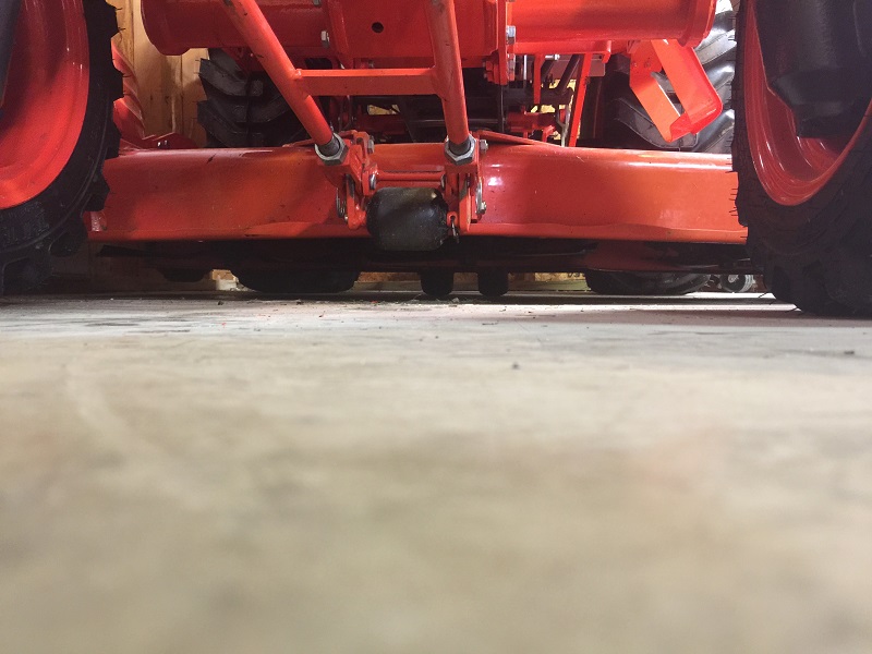

Yes linkage hooked up like the dealer had it with hydraulics all the way down.

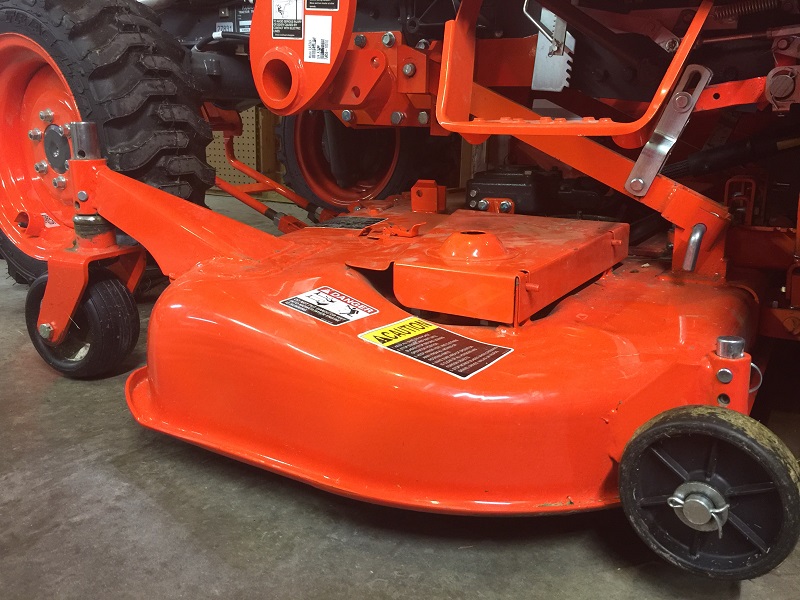

linkage hooked up like the manual says to do it. It's at it's longest length. Notice how high it lifts only the front of the mmm.

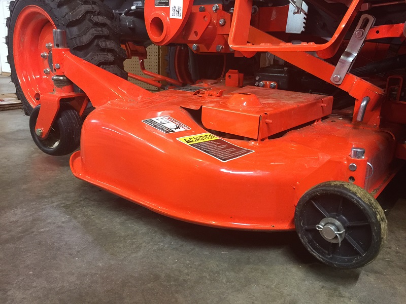

This was my previous tractor. I had the photo
and thought it might help.

Thanks. The picture does help

Based on on the last 2 pics, I think everything is as it should be. This deck is a ground contact deck and only the 2 front swivel casters and the rear middle wheels should contact the ground when lowered. The cutting height is adjusted by setting the front casters and rear middle wheels per the sticker on the deck. The front middle wheel and the one on the left rear are there as anti-scalp, and the rear one is rotated 90 degrees to help in sliding the deck out. When my deck is lowered there are only 3 contact points, the 2 front and one rear middle wheel.

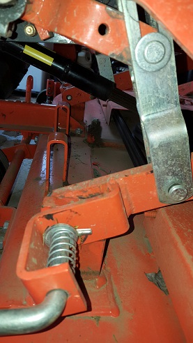

If the deck can't be raised fully, I'd check the lengths of the 2 rear connecting rods, the distance between the 2 clevis hole centers should be 26.2 inches for the 60 inch deck and make sure the deck lift bracket is installed properly.
