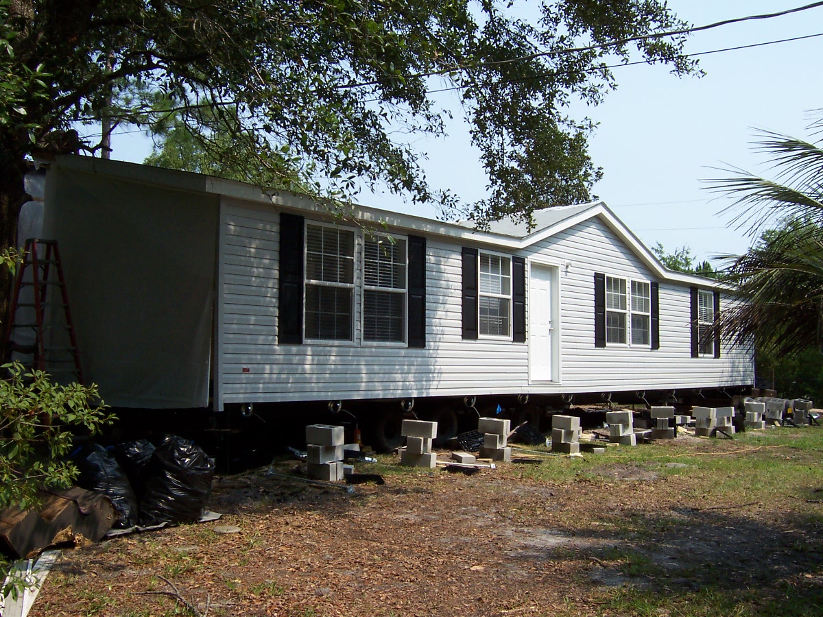

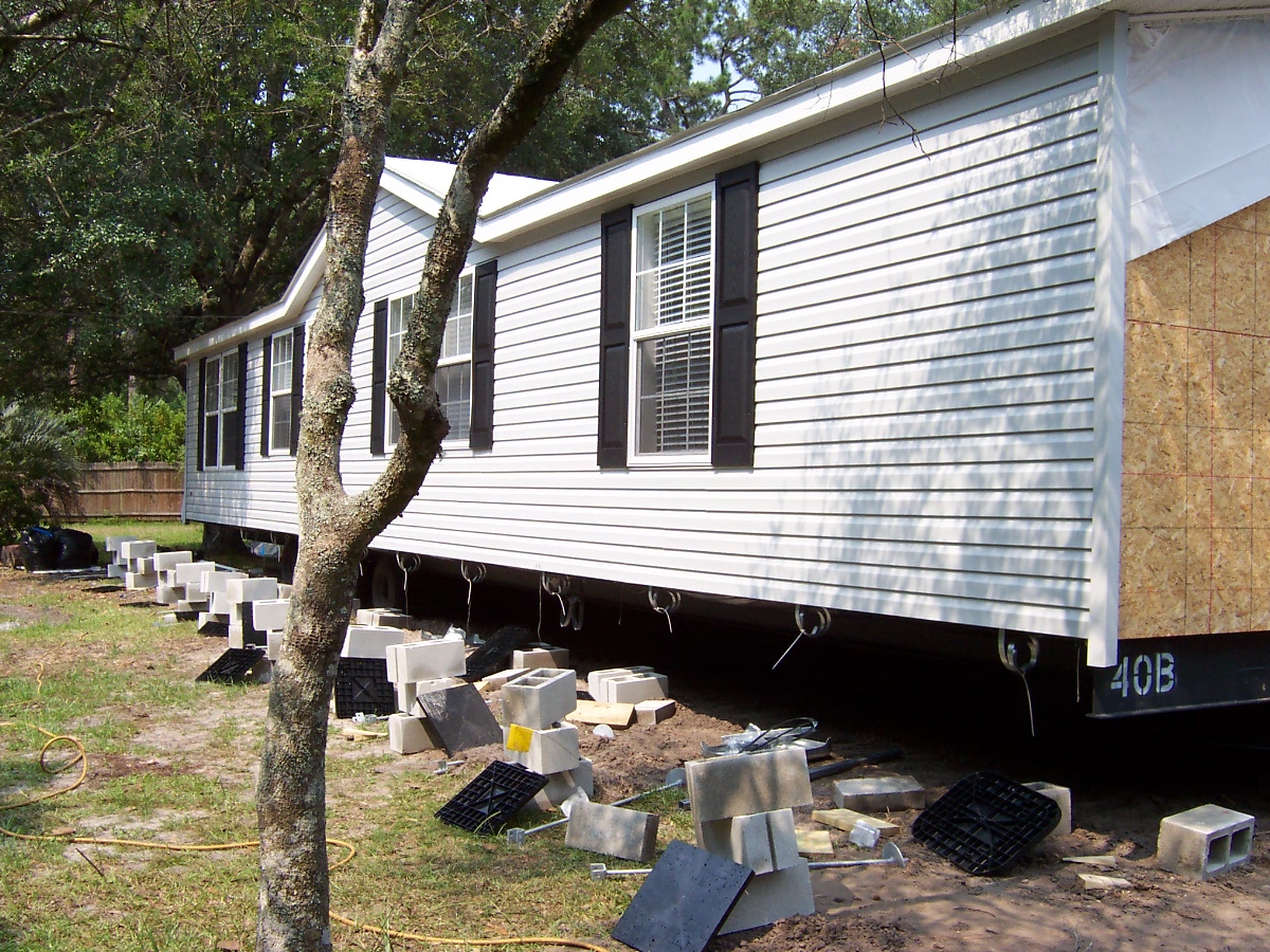

Pics are outside blocking on a 56' X 60' doublewide I purchased in 2011. It came with set up and skirting and replaced an old home.
