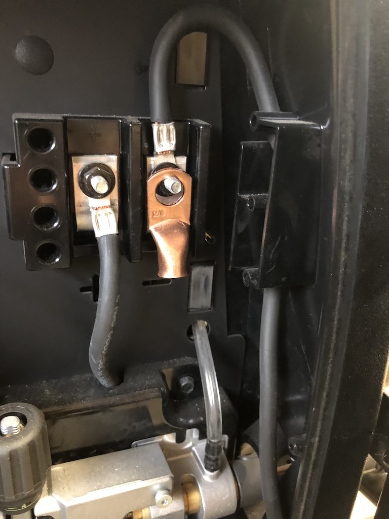

Those don't work. But I think I found it... 4 gauge wire and a 7/16in stud.
4 AWG, 1/2" Stud, Tinned Copper, Crimp or Soldered
A 5 pack for $5.20. Funny thing is that ElectricalHub is a distributor for my company! I think I will pay them a visit and ask for a sample!

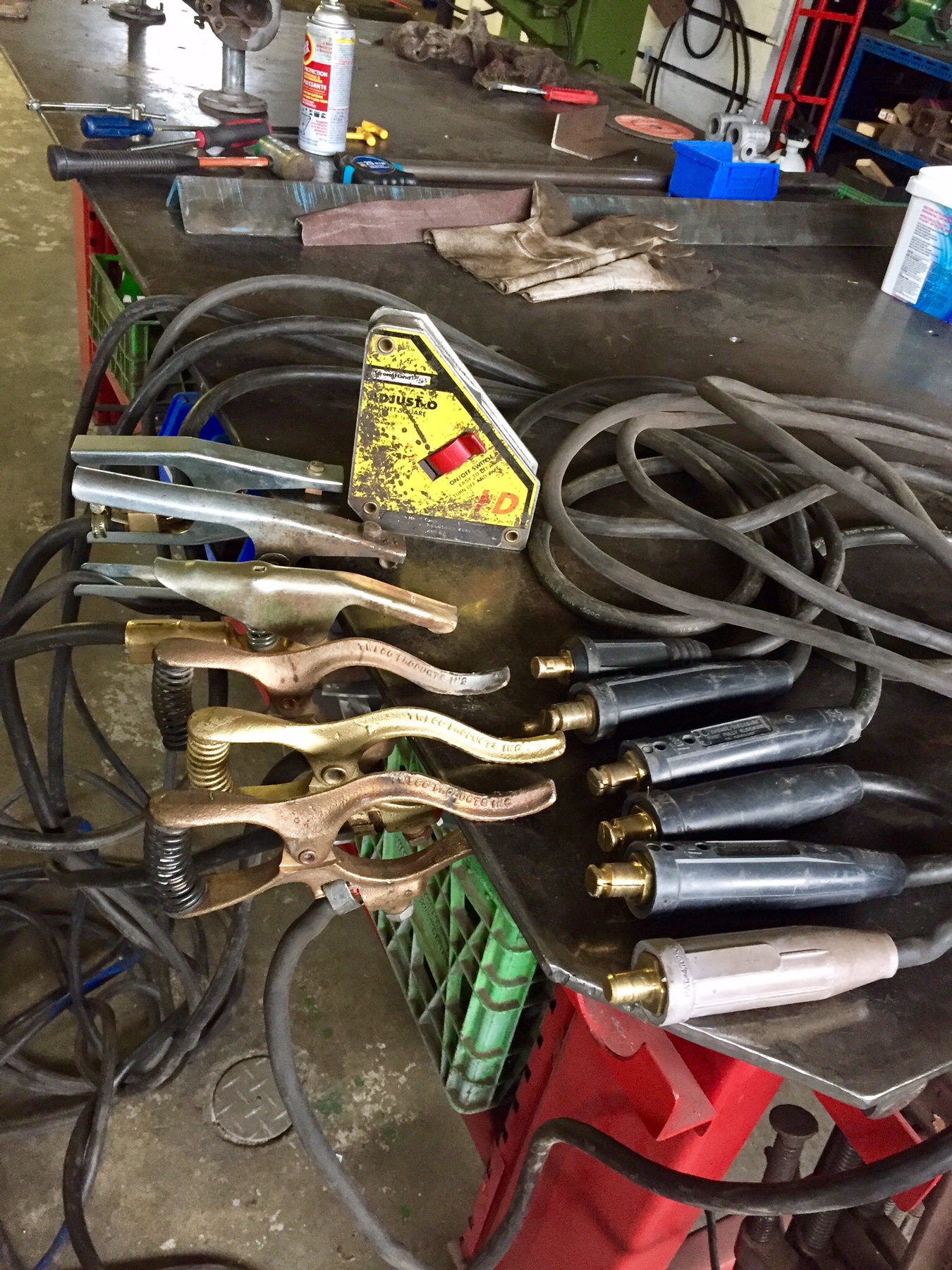

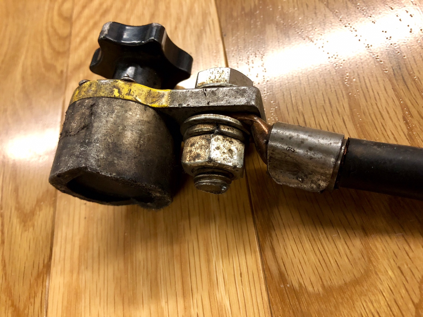

Okay for you guys that were worried I was going to have a half-azzed end product... rest easy. I decided to visit my distributor that I do business with and they happen to be industrial electrical parts business. He gave me a few samples of the proper terminal... a 1/2in dia. 6 gauge. I brought in my cable and went back in the warehouse and he let me try out a $240 crimper and a cool wire stripper with depth gauge that works like a thin wall pipe cutter.
Power Lug Terminal Crimping Tool
He also gave me a bunch of shrink wrap various sizes for my collection of misc electrical stuff. When I got back to my shop, I used a bit to finish off the connection along with the other existing end.
Job finished. Reinstalled the ground inside the welder and attached the Magswitch. I'm happy... just have to get this by the TBN QA department! :D

Option 1: Didn't find one. If someone wants to point me to where I don't have to buy a pack of 10 or 25 :thumbsup:
Option 2: I could increase the wire gauge to 2/0 and I think it will actually fit the routing and terminal inside the welder. Really didn't want the expense of a 15ft wire. I actually bought a second terminal in case I mangled the first one. See pic.
Option 3: What I was planning to do unless someone had a brilliant idea. Thinking at least a tripler.
