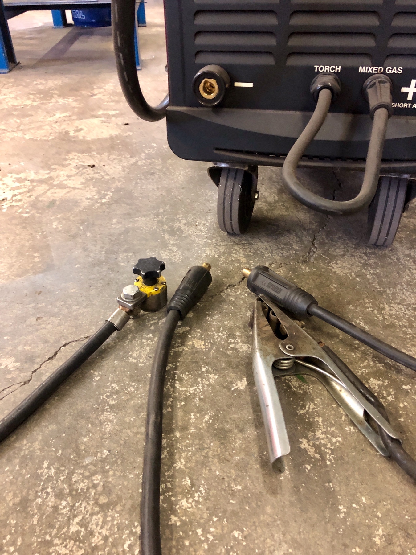

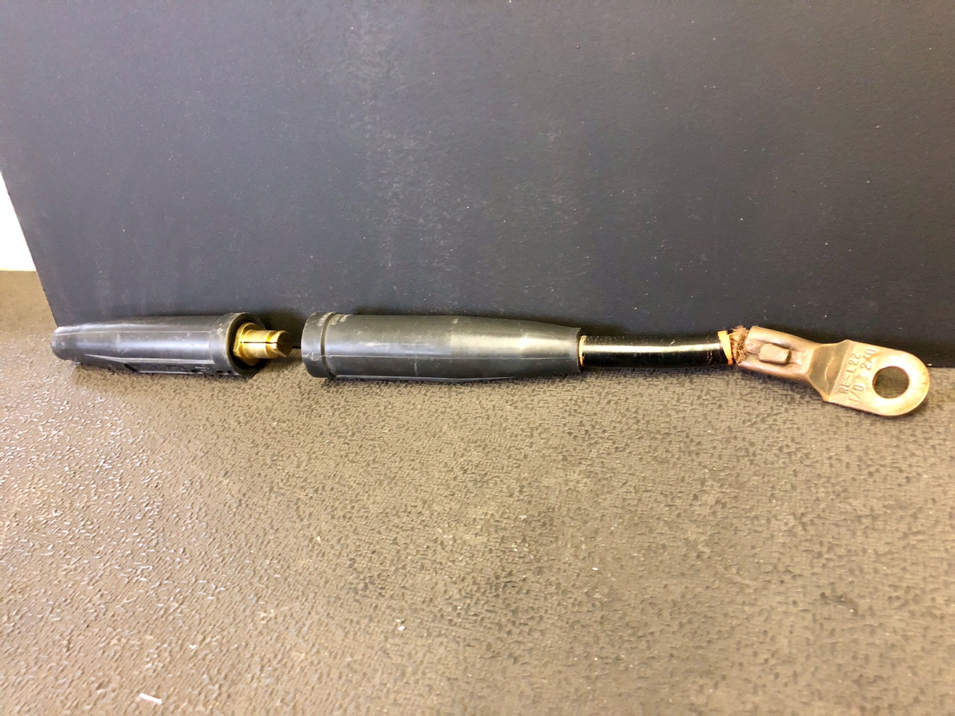

Those are quick disconnects at the machine, no? Mine ground is 'hard wired'. I understood yomax modded his wires for an in-line disconnect like a pin/socket connector.
Chop the lead coming out of your machine and have a short pig tail with a quick connect. Tweco connectors in this photo.
Or get real fancy and install a panel plug on the face of your welder if there’s room. Dinse or Euro style in this photo.
You may have to “borrow” that fancy crimper.

Not sure of the Tweco part numbers anymore for the Quik connects but you can also get Lenco LC10 for smaller cables and LC40 for the big stuff. There are likely several others out there. Good Luck and happy shopping.

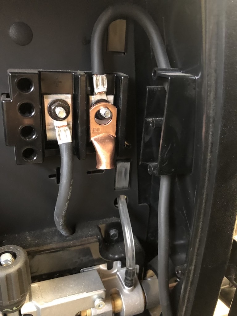

Option 1: Didn't find one. If someone wants to point me to where I don't have to buy a pack of 10 or 25 :thumbsup:
Option 2: I could increase the wire gauge to 2/0 and I think it will actually fit the routing and terminal inside the welder. Really didn't want the expense of a 15ft wire. I actually bought a second terminal in case I mangled the first one. See pic.
Option 3: What I was planning to do unless someone had a brilliant idea. Thinking at least a tripler.
